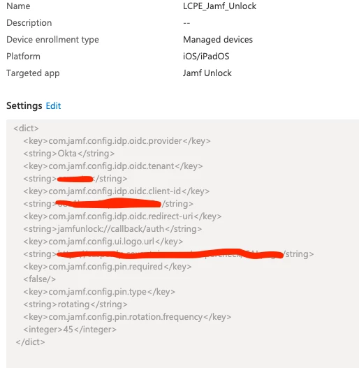

You need to add the app configuration policy.

Ensure your formatting is correct when you upload the XML. I have noticed when using XML different enterprise MDM's read them differently. In our Intune, I have used the configuration without the header info. And used the XML property list.
Hope this helps.
