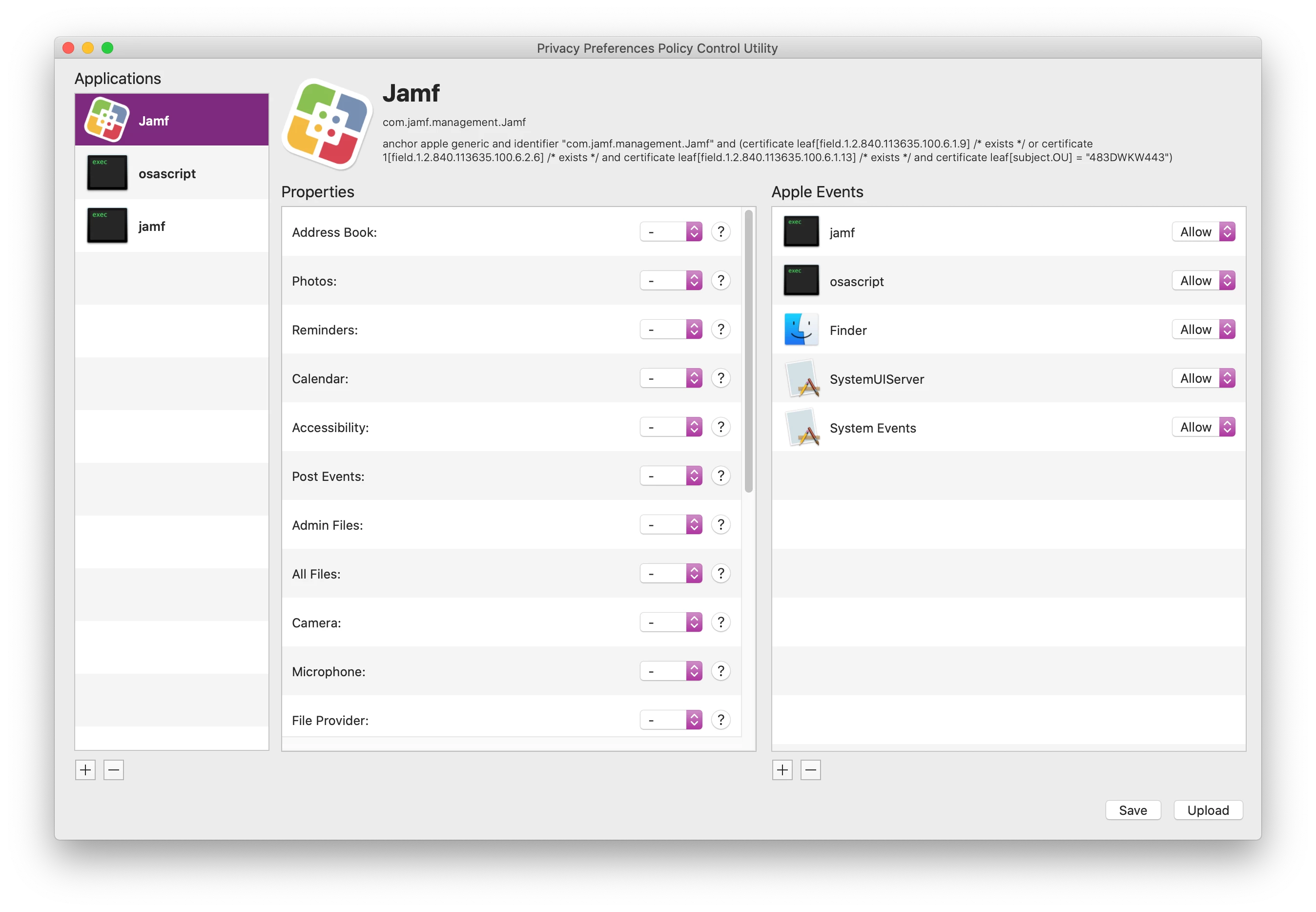

  • June 17, 2019
I too was having this happen... I added the BundleID of Jamf.app with access to System Events and was getting pop-ups
Was about to go down the rabbit hole of what combo would work then I tried something simpler...

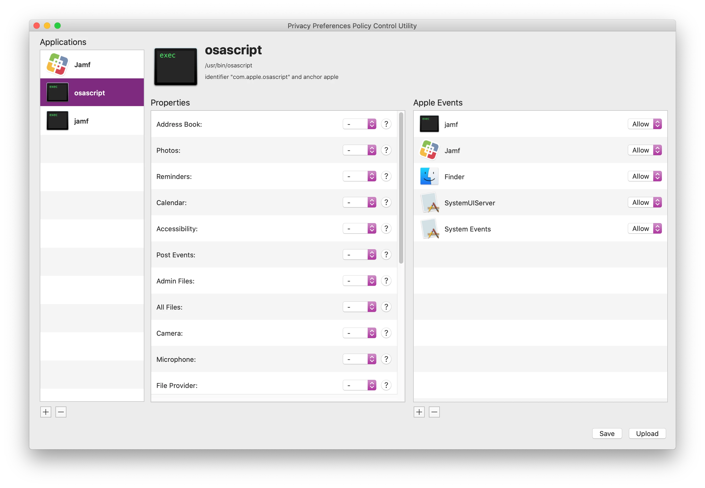

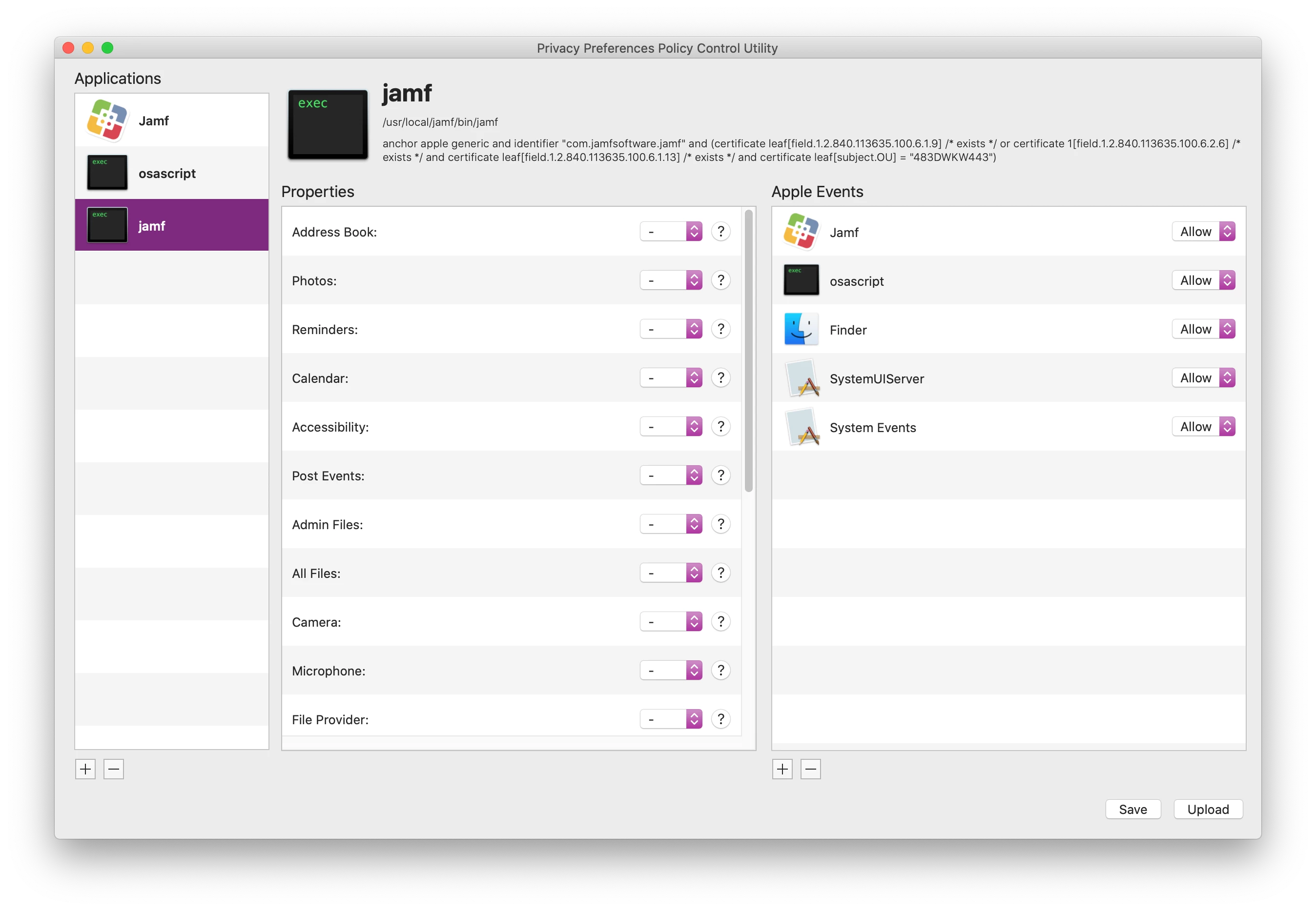

Having all 3 items including allowing all the Apple Events allowed me to bypass the osascript prompt @leonwun .

Have you looked here?: https://github.com/jamf/JamfPrivacyPreferencePolicyControlProfiles/blob/master/JamfAppleEvents.mobileconfig

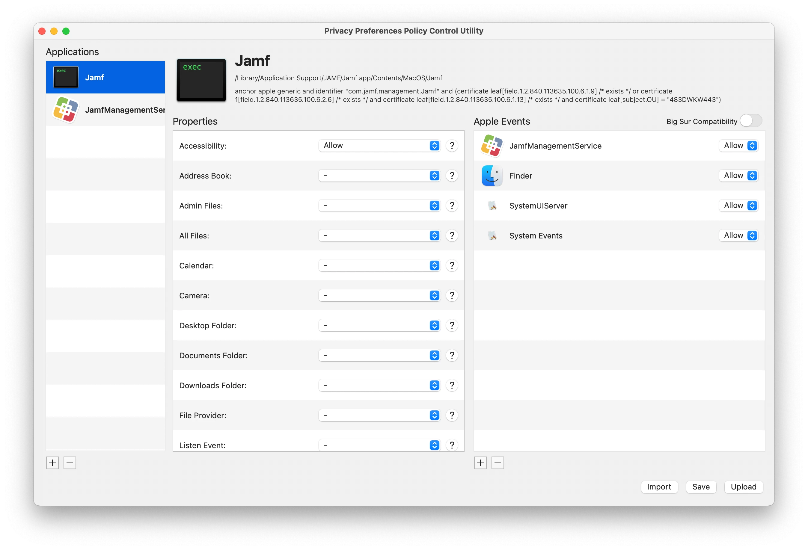

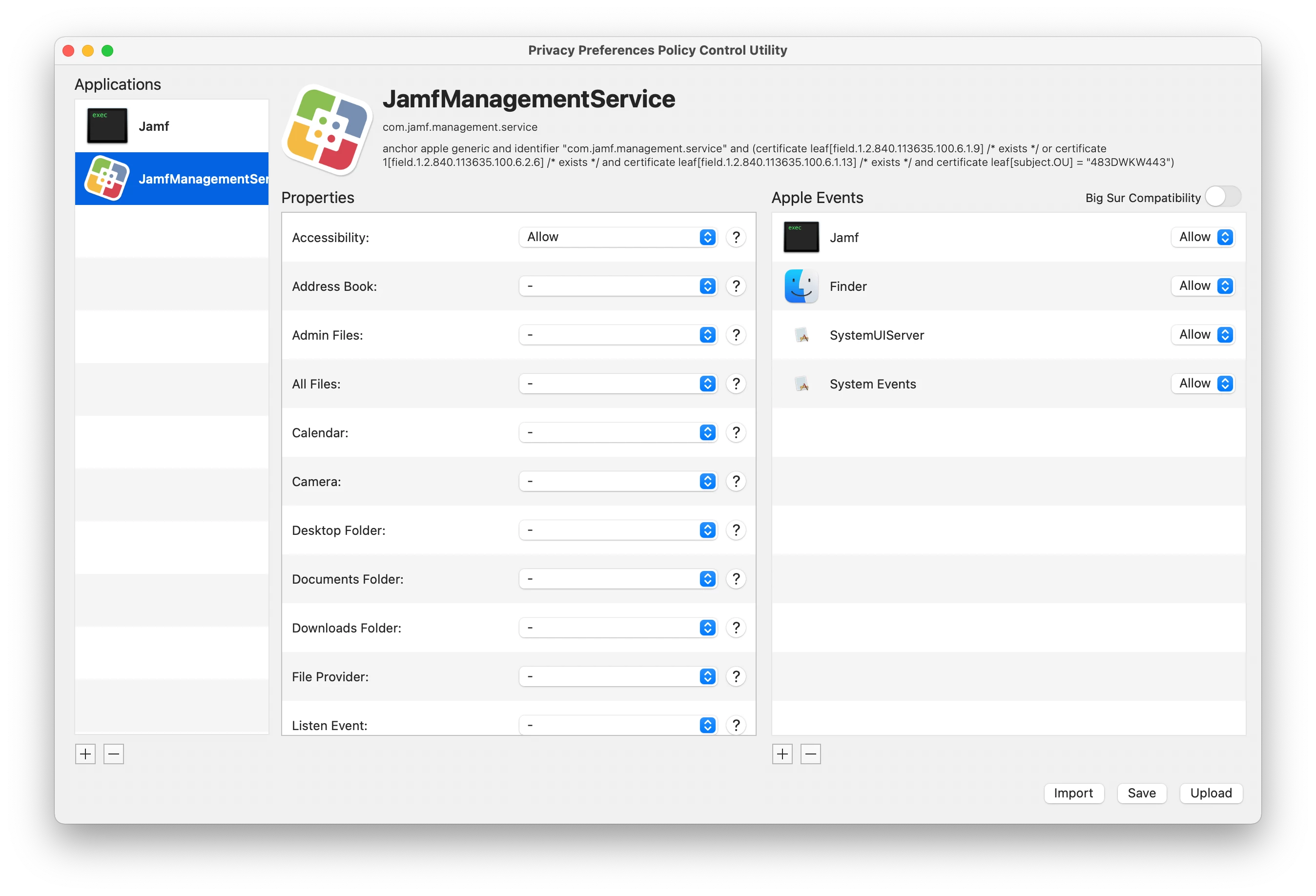

I think I have this figured out. I was running into this exact problem while attempting to use osascript to remove Bluetooth devices from our loaner computers. I fixed this using a PPPC, see below:
I wasn't able to navigate to these files inside of the PPPC Utility, instead I had to open up the files in Finder and drag them into the PPPC Utility window. Add these files:
-- /Library/Application Support/JAMF/Jamf.app/Contents/MacOS/Jamf
-- /Library/Application Support/JAMF/Jamf.app/Contents/MacOS/JamfManagementService
-- (Right Click on Jamf.app and select "Show Package Contents" to get to these files)
Make sure to reference them inside of the Apple Events section as well.
Why not just add Jamf.app? I don't know. You would think that would work, but I could only get it to work by digging down to these specific files.
I hope this helps someone.

anyone have this working with a fresh install of DEP enrolled Big Sur 11.4? I had this working with Big Sur pre 11.4 trying to find out what changed.
  • August 31, 2021
I was able to resolve this with the following PPPC:
Identifier: /usr/local/jamf/bin/jamf
Identifier Type: "Path"
Code Requirement
anchor apple generic and identifier "com.jamfsoftware.jamf" and (certificate leaf[field.1.2.840.113635.100.6.1.9] /* exists */ or certificate 1[field.1.2.840.113635.100.6.2.6] /* exists */ and certificate leaf[field.1.2.840.113635.100.6.1.13] /* exists */ and certificate leaf[subject.OU] = "483DWKW443")
App Or Service = AppleEvents
Access = Allow
Receiver Identifier: com.apple.systemevents
Receiver Identifier Type: "Bundle ID"
Receiver Code Requirement: identifier "com.apple.systemevents" and anchor apple
Update:
However after a tccutil reset Apple Events, the same pop up came back. Even after restart or reapplying the Configuration Profile.
Anyone have any other suggestions?
  • November 15, 2021
I managed to solve this one after days of trial and error.
I ended up using this article to monitor the logs as the process was running to call my apple Script. It pointed to the jamf daemon. https://scriptingosx.com/2020/09/avoiding-applescript-security-and-privacy-requests/
I created a PPPC profile just for the jamf daemon and all worked. Has to be the Jamf Daemon binary and not the app - /Library/Application Support/Jamf/Jamf.app/Contents/MacOS/JamfDaemon.app/Contents/MacOS/JamfDaemon
Creating a monolithic PPPC profile with all the jamf binaries didn't work for me either and I suspect they were causing conflict.
Hope this helps someone.
  • December 20, 2021
@jack_chung88  This didn't work at all for me. On launching the policy that uses applescript, the user still gets prompted twice: One to let Jamf access  System Events and another for Finder.
Once the user does that, then the policy works. But end users don't know what to make of prompts like that, nor should they ever have to if IT is managing their computer. Something's wrong with PPPC in Big Sur and the latest version of JAMF. We never had to worry about this before just using the PPPC templates provided by JAMF.
Bol
  • January 18, 2022

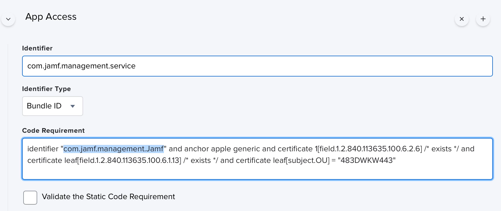

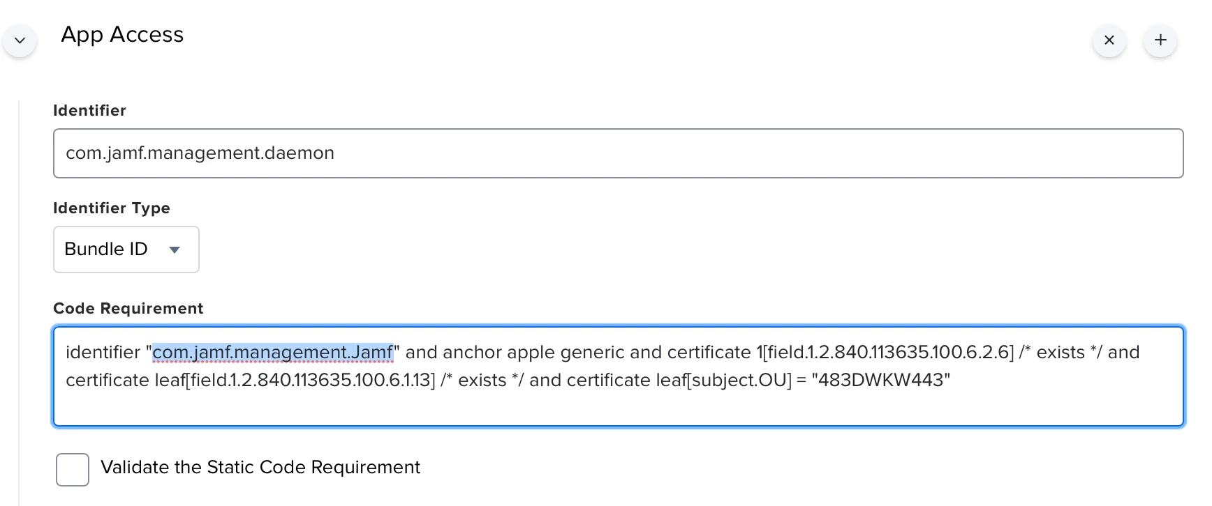

This one had me pull a few hairs out but it's fixed now.. For anyone still following along, here's what I found..
macOS 12.1 -> user login (or Self Service item) will trigger a policy / script that calls osascript with a Finder tell block. "Jamf want's access to Finder.." began springing up.
Checking the logs below and reading some posts ( https://mjtsai.com/blog/2021/06/01/macos-11-4-breaks-full-disk-access-for-helper-tools/#comment-3465376 ), I needed to explicitly whitelist helper executables included in the Jamf.app bundle; com.jamf.management.daemon ( login ), com.jamf.management.service ( self service )
/usr/bin/log show --predicate 'subsystem == "com.apple.TCC"' --info --last 1h
( https://krypted.com/mac-os-x/reviewing-tcc-dialog-prompts-using-logs-on-a-mac/  )
2022-01-17 22:33:43.340568+1030 0x15a6a    Info        0x45da1              9216   0    tccd: [com.apple.TCC:access] do_TCCAccessRequestIndirect: indirect object information processed
2022-01-17 22:33:43.340574+1030 0x15a6a    Default     0x45da1              9216   0    tccd: [com.apple.TCC:access] target_executable_path_URL: file:///Library/Application%20Support/JAMF/Jamf.app/Contents/MacOS/JamfDaemon.app/Contents/MacOS/JamfDaemon
2022-01-17 22:33:43.340914+1030 0x15a6a    Info        0x45da1              9216   0    tccd: [com.apple.TCC:access] Constructed 'accessingProcess' from indirect_object_token in message from <TCCDProcess: identifier=com.apple.finder, pid=9338, auid=2041273090, euid=2041273090, binary_path=/System/Library/CoreServices/Finder.app/Contents/MacOS/Finder>
2022-01-17 22:33:43.340943+1030 0x15a6a    Info        0x45da1              9216   0    tccd: [com.apple.TCC:access] AttributionChain: accessing={<TCCDProcess: identifier=com.apple.finder, pid=9338, auid=2041273090, euid=2041273090, binary_path=/System/Library/CoreServices/Finder.app/Contents/MacOS/Finder>}, requesting={<TCCDProcess: identifier=com.apple.finder, pid=9338, auid=2041273090, euid=2041273090, binary_path=/System/Library/CoreServices/Finder.app/Contents/MacOS/Finder>},
But I had already done this, entries for both are whitelisted to send Apple Events to Finder etc. Reading on in the TCC logs I saw these below;
2022-01-17 22:33:43.341540+1030 0x15a6a Info 0x45da1 9216 0 tccd: [com.apple.TCC:access] -[TCCDAccessIdentity initWithIdentifier:type:executableURL:SDKVersion:platformType:]: self.bundle=0x129b055f0, bundle:<TCCDBundle: bundleID=com.jamf.management.Jamf, version=10.35.0-t1640197529, path=/Library/Application Support/JAMF/Jamf.app>; for: com.jamf.management.daemon, URL: file:///Library/Application%20Support/JAMF/Jamf.app/Contents/MacOS/JamfDaemon.app/Contents/MacOS/JamfDaemon, /Library/Application Support/JAMF/Jamf.app/Contents/MacOS/JamfDaemon.app/Contents/MacOS/JamfDaemon
2022-01-17 22:33:43.342193+1030 0x15a6a    Default     0x45da1              9216   0    tccd: [com.apple.TCC:access] -[TCCDAccessIdentity staticCode]: static code for: identifier com.jamf.management.daemon, type: 0: 0x129b0b1c0 at /Library/Application Support/JAMF/Jamf.app
2022-01-17 22:33:43.369037+1030 0x15a6a    Info        0x45da1              9216   0    tccd: [com.apple.TCC:access] -[TCCDAccessIdentity matchesCodeRequirement:]: SecStaticCodeCheckValidity() static code (0x129b0b1c0) from com.jamf.management.daemon : identifier "com.jamf.management.daemon" and anchor apple generic and certificate 1[field.1.2.840.113635.100.6.2.6] /* exists */ and certificate leaf[field.1.2.840.113635.100.6.1.13] /* exists */ and certificate leaf[subject.OU] = "483DWKW443"; status: -67050
2022-01-17 22:33:43.369054+1030 0x15a6a    Info        0x45da1              9216   0    tccd: [com.apple.TCC:access] Override: eval: matched <kTCCServiceAppleEvents, com.jamf.management.daemon>; result: Auth:Unknown (<Unspported Authorization Reason value>); because: code does not meet requirement
It seemed my issue was during validation of the code requirement for JamfDaemon executable. As a test, I even tried relaxing that requirement to ( identifier "com.jamf.management.daemon" and anchor apple generic ) but still no change!!  I tried again but this time, using the identifier of the parent bundle eg. Jamf.app
Identifier: com.jamf.management.daemon
Code Requirement : identifier "com.jamf.management.Jamf" and anchor apple generic and certificate 1[field.1.2.840.113635.100.6.2.6] /* exists */ and certificate leaf[field.1.2.840.113635.100.6.1.13] /* exists */ and certificate leaf[subject.OU] = "483DWKW443"
Once deployed, everything began working again as normal with no further prompts for approval on login. I did this again forJamfManagementService ( Self Service ) and it also worked by removing user prompts on execution.
Identifier: com.jamf.management.service
So for my environment, changing the code requirement identifier on both whitelist entries to match the parent bundle they live in, ( /Library/Application Support/JAMF/Jamf.app : identifier "com.jamf.management.Jamf" ) worked for me.

@Bol I started playing around with this as I also started needing to have users click the ok button when it popped the "Jamf" wants access to control "System Events" message.  In our environment this is due to a AppleScript that takes their username and adds our domain name onto it to at least make creative cloud logins one step easier as well as opening safari and (default website) our class link portal, it also types in the username (as well as opens safari extensions so the user can click on the classlink extension).
I tried to use your suggestion however after setting the identifier to the generic .Jamf, then it seems to forget to give osascript permission to use accessibility to be able to type in what I want.
We are now using 12.2 and from the links you included, it looks like this was indeed broken in 11.4 (and worked previously for my login scripts).
Im still playing around though and will update if I find anything further.
Bol
  • February 7, 2022
@GabePPS Did you try using the whole identifier below, this is what worked for me;
There may be new requirements preventing the relaxed one to work, I would leave your existing profiles and create another to apply along side with more access. I then worked back to find the correct permissions needed.
My pop ups were Jamf accessing Finder, with system events you may need accessibility or try full disk access to start allowing: com.jamf.management.service (Self Service)
Could you post the TCC access logs to see what is requiring the access?
