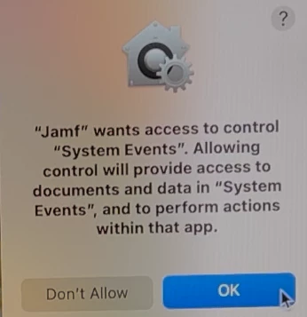

"jamf" wants access to control "system events"

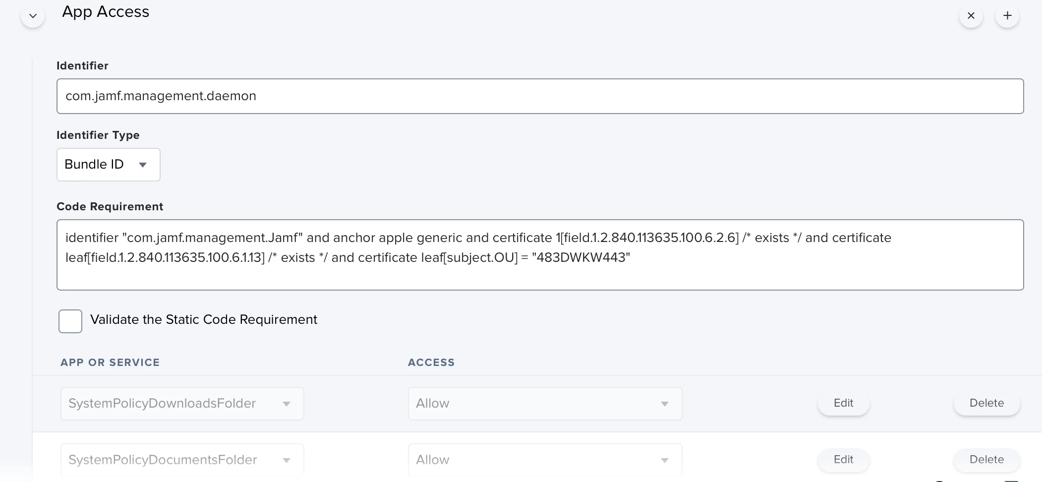

Ok, that was the same as me, login script which is kicked off by the daemon.

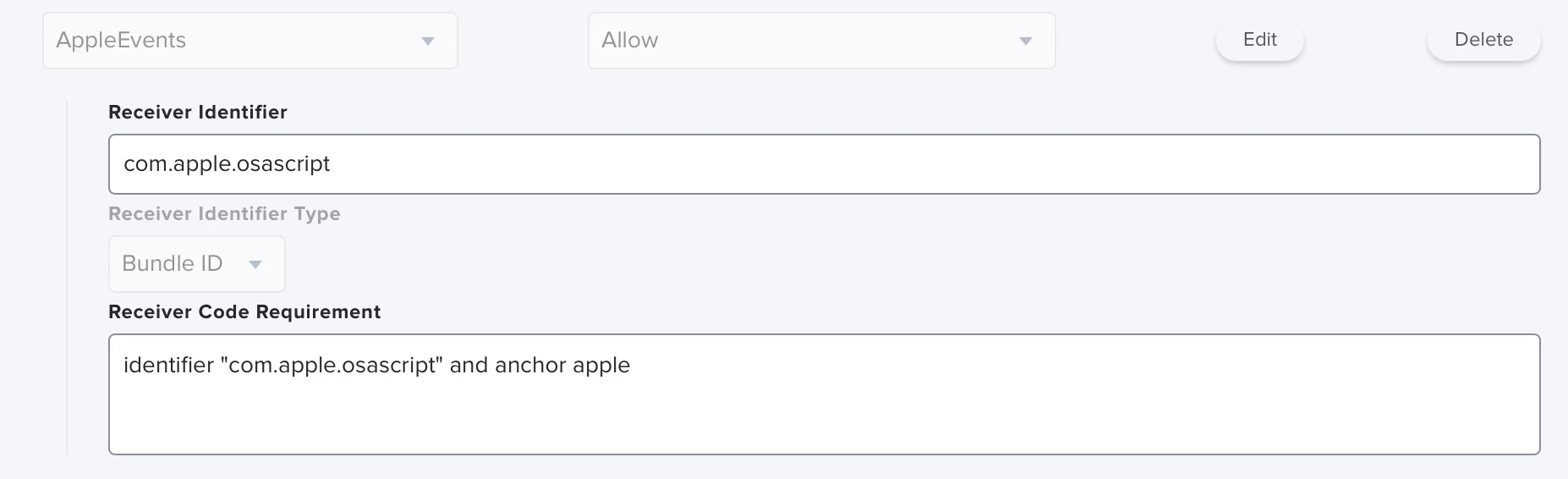

What worked for me was whitelisting JamfDaemon's identifier, with the code requirement of the Jamf.app bundle it lives inside.
/Library/Application Support/JAMF/Jamf.app/Contents/MacOS/JamfDaemon.app/Contents/MacOS/JamfDaemon
Identifier: com.jamf.management.daemon
Code Requirement : identifier "com.jamf.management.Jamf" and anchor apple generic and certificate 1[field.1.2.840.113635.100.6.2.6] /* exists */ and certificate leaf[field.1.2.840.113635.100.6.1.13] /* exists */ and certificate leaf[subject.OU] = "483DWKW443"
Allow it Apple Event access to osascript and you should be good to go. Although my popup was resolved by giving access to Finder (I was calling 'tell application "Finder" make new alias to smbMount at desktop..), yours is asking for system events.

Working on this again today.  Im really going nuts trying to get this proper.
Here is the jamf log that show when I click "Deny" on Jamf wants to control message:
41:76: execution error: Not authorized to send Apple events to System Events. (-1743) 105:123: execution error: Not authorized to send Apple events to System Events. (-1743)

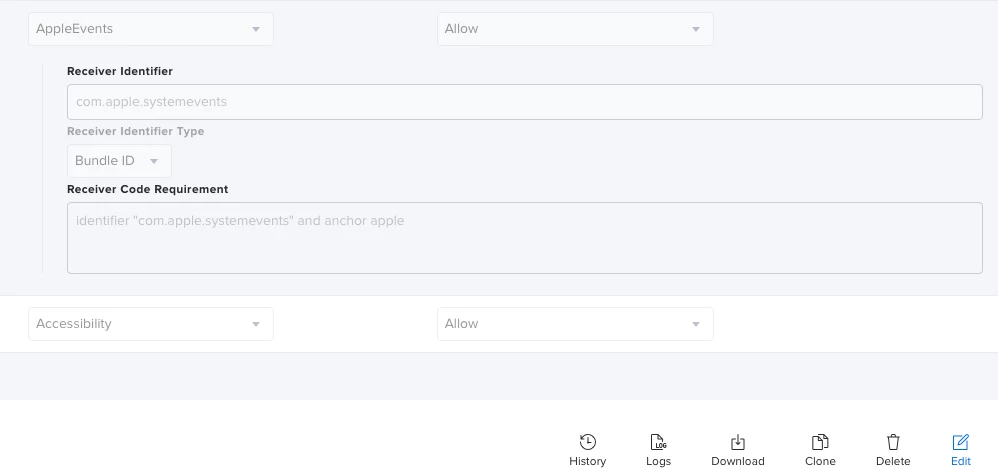

Can you post the PPPC profile that you're using? It may not have all the correct permissions for Jamf and osascript.
For comparison, I've posted a PPPC profile which should be comprehensive for Jamf and osascript sending AppleEvents:
https://gist.github.com/rtrouton/daa89fd7a27a52137865aff015d474ad

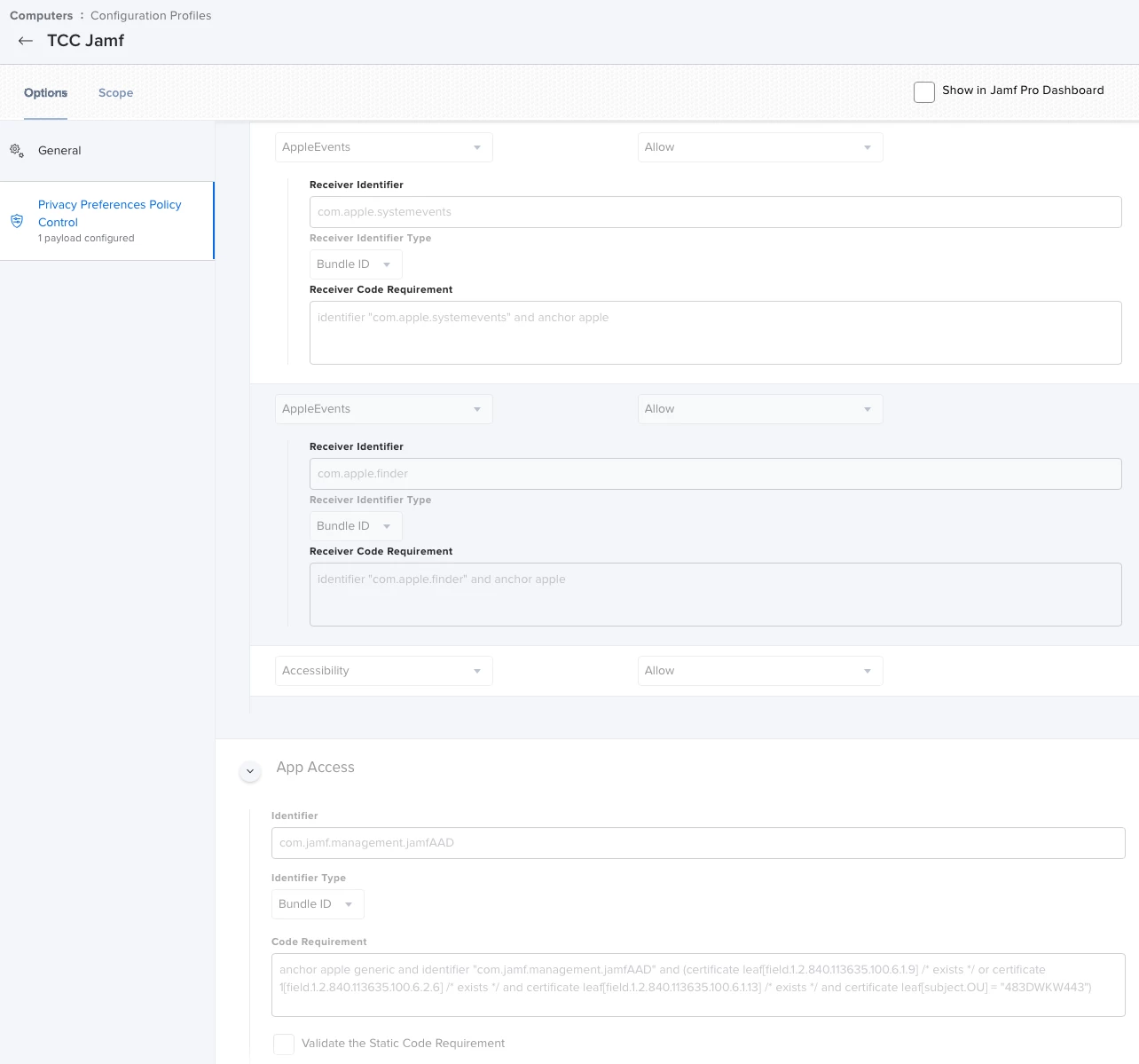

  • Feb 11, 2022 5:24 PM UTC

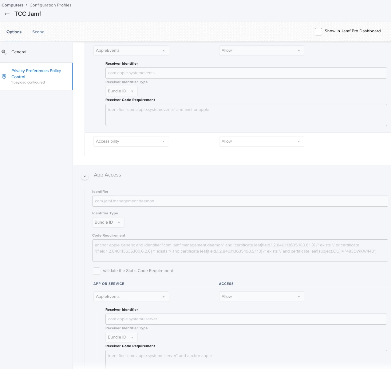

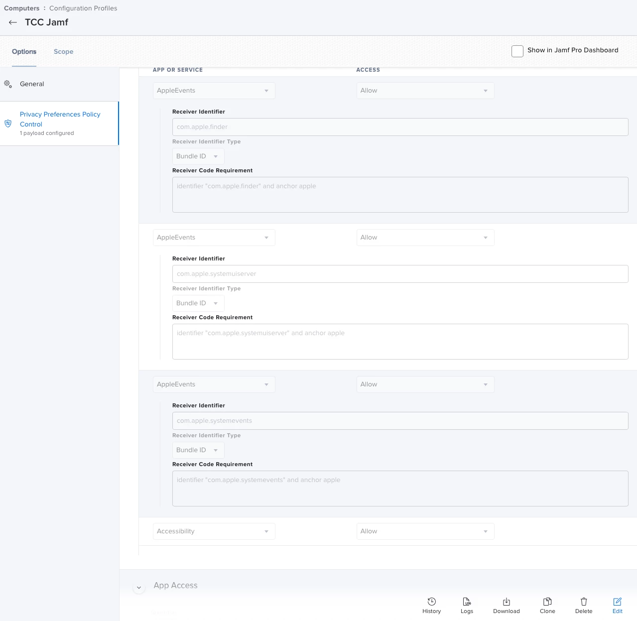

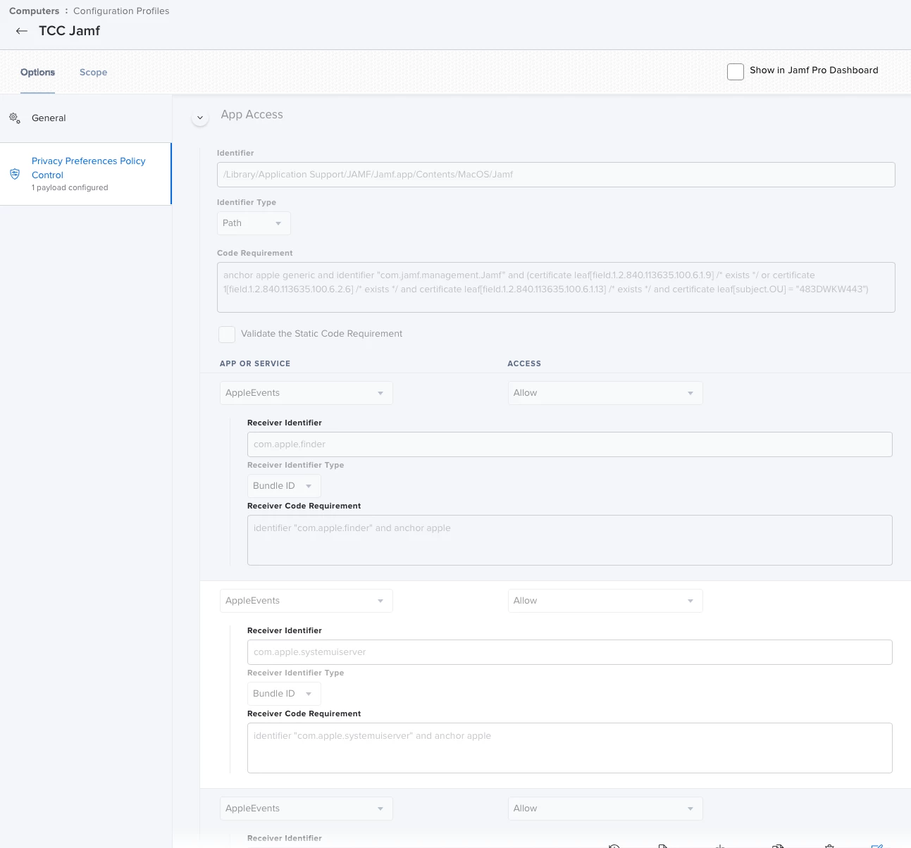

@rich.trouton Thanks so much for the response!
My older Jamf TCC profile which worked before (maybe)11.4 is shown below but I had a 2nd separate TCC profile for osascript.  I have most of the tcc config profiles set separately and again used to work in that regard.  Im going to attempt using just your profile and exclude my two from it, but in looking it over I don't see the access to accessibility that I think it may require to input keyboard typing.  I'll let you know though.
  • Feb 11, 2022 5:48 PM UTC
@rich.trouton So I just tried your profile and it also states the same that Jamf wants access to system events.  (It did also ask for Accessibility as I thought).  Whats interesting if I look at Security & Privacy under Automation as to what got added when I clicked approve, it shows the "Parent" process of JamfDaemon (which looks to be the App and not the process inside the app).

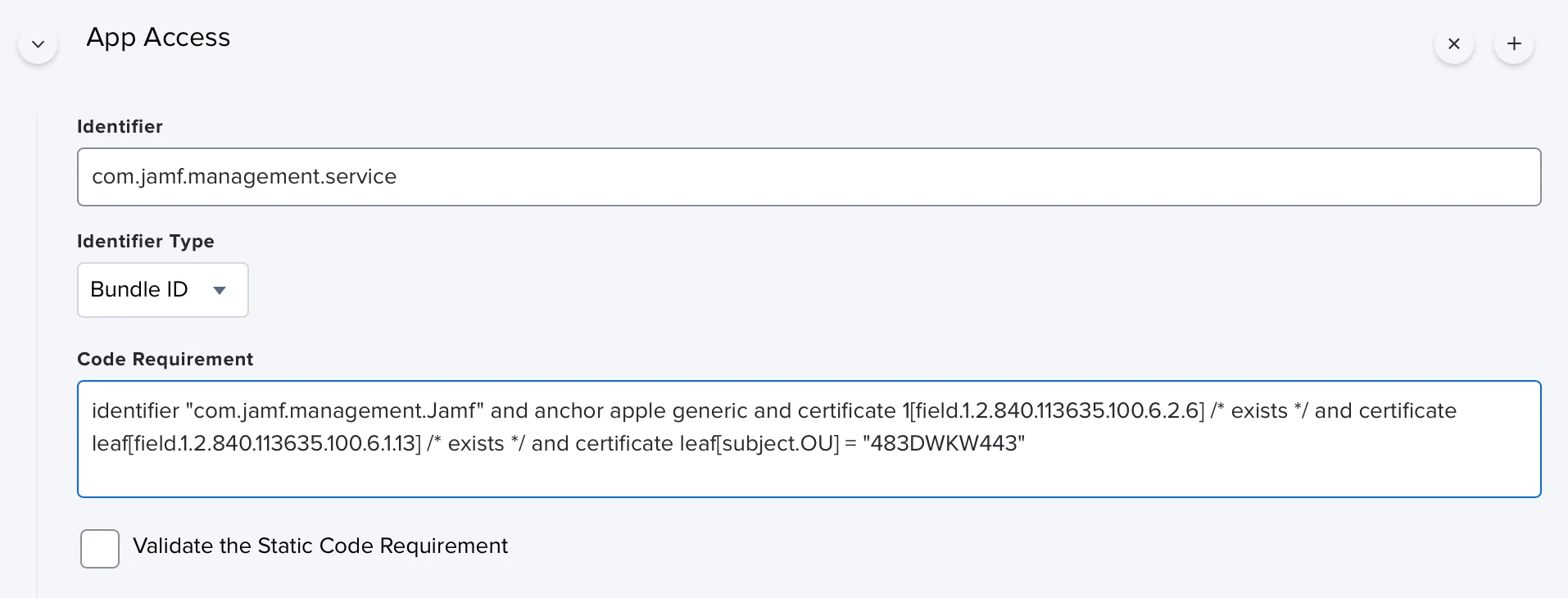

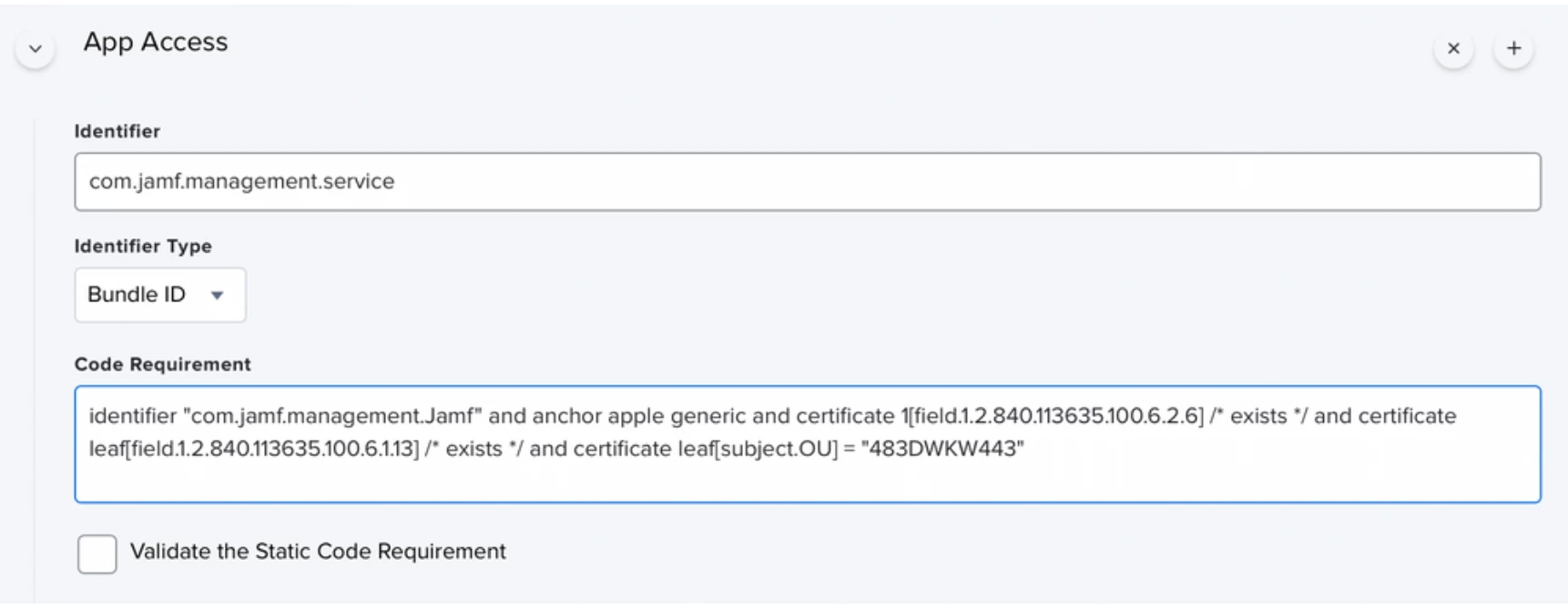

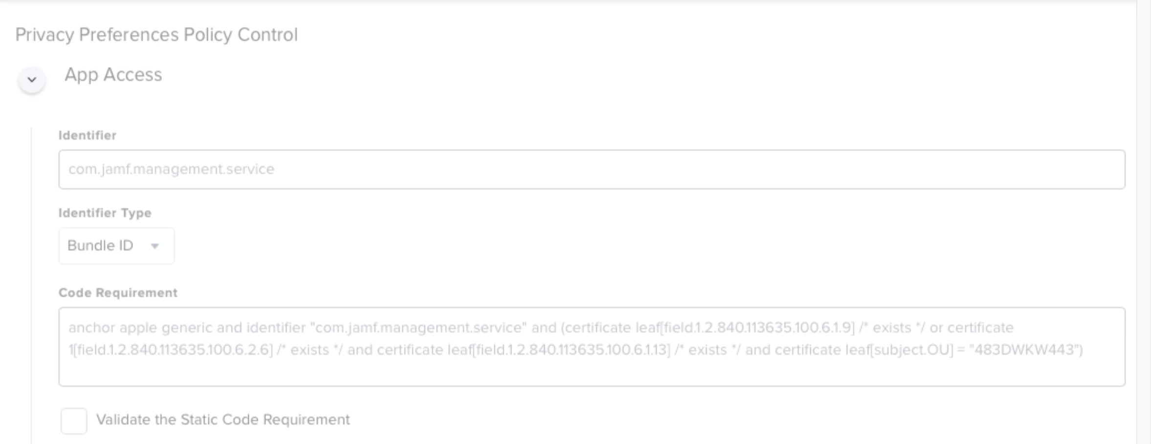

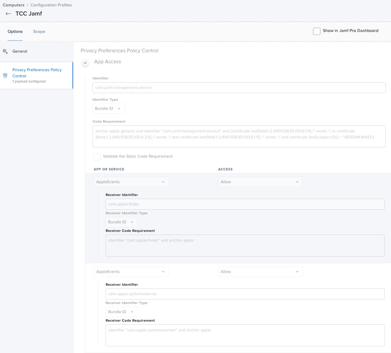

I can take a look at the script, no troubles, but I can already see the problem with your profile. As I mentioned in my original post in this thread, you need to change the code requirement to match the parent jamf.app it's located in, not that of the binary itself.
See your profile picture here;
Change it to look like this, I posted this above accessing osascript;
You need to change this for the daemon (login triggers) and the service (launched from self service)
nagement.service
Let me know if that works or not.

@GabePPS Sorry I didn't get back to you earlier, timezones and a full on week back to school.
nagement.service
