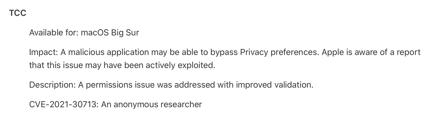

  • Feb 26, 2022 3:35 AM UTC
That change was to fix actively exploited CVE-2021-30713 which is ironic, seems it's a lot easier to bypass than to correctly whitelist permissions!
Kudos to you Mr Shackney for the update, I wasn't aware the accessibility side has been acknowledged and will stop looking into it.
Frankly, the state of tcc right now is a dogs breakfast to say the least. Keep us in the loop!

@GabePPS Well, if you haven't given up on your Apple Script dreams yet.. It's just been acknowledged in testing so hopefully next major release, you could be back in business!
  • Resolves an issue where PPPC payloads for Accessibility and AppleEvents do not suppress user approval prompts.
