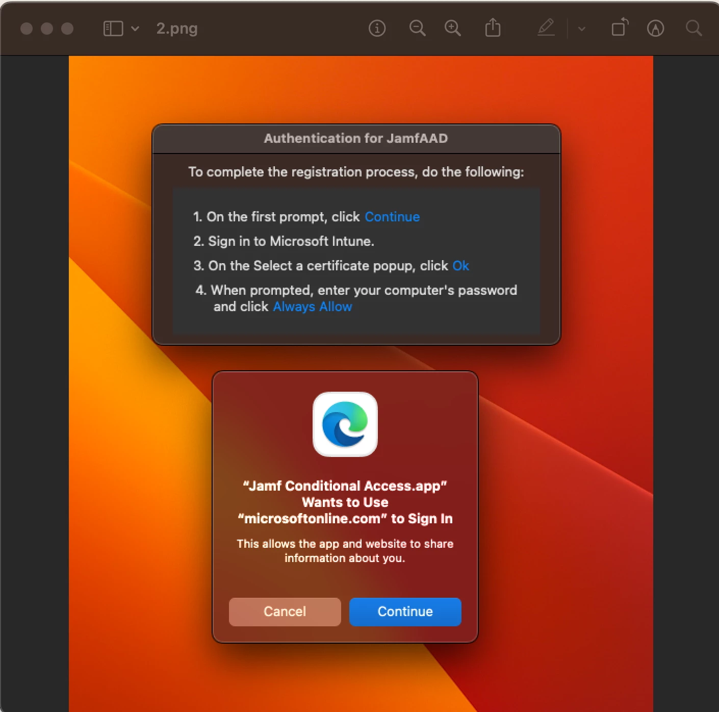

robertoa
Users that have already properly enrolled into Intune and completed enrollment continue to get pop ups of jamfAAD.
I have verified in Intune that the device is enrolled AND the policy was completed successfully in JAMF. This pop up continues to run and request users to continue. This sometimes disrupts end user workflows or presentations while on a zoom call. Is there a setting possible in the profile where I can set the retry option to 0 if already successfully completed. I've tried flushing the logs, delete the device from Intune, then re-enroll the mac back but users still get prompted. Even when I've un-scoped the policy from the user they still get the pop up. Possibly coming form the Intune side? I'm open to any ideas.
Best answer by mvu
To clear that prompt, I ran the script below, removed Company Portal App, and removed the device from InTune. In your case, you'd re-enroll into Intune and see if it's better from a clean slate.
Forgot where I found the script below, but thank you to that person.

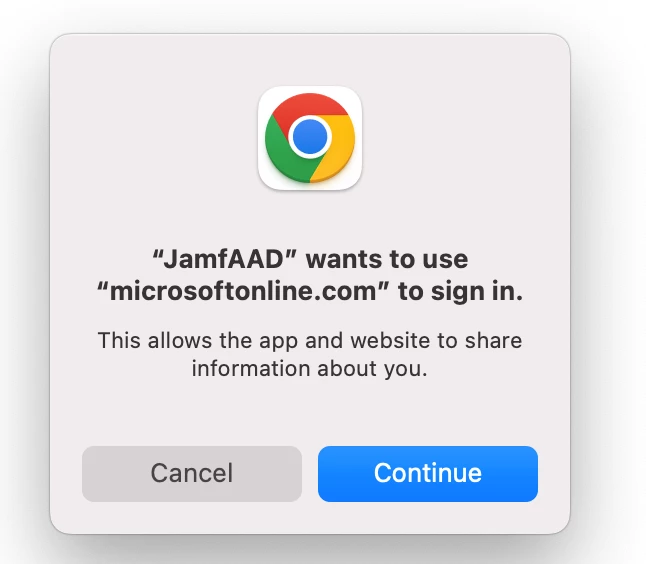

Hello @robertoa
I just want to clarify below that Jamf AAD prompt is something which can come and thats normal, please read below information and feel free to reach me if you need any additional resources as well.
Once the initial registration is completed jamfAAD continues to run in the background and has to authenticate every 24 hours to Azure to confirm the Azure AD record is still intact and confirm the AAD Device ID. Why? Well, because it has to report it to JPRO as proof of the integrity of the registration, and the activity of the device.
This is why we have the WPJ key and cached credentials. jamfAAD actually authenticates silently to Azure and uses the items in the keychain to do so. As long as the WPJ key is ok, the Azure AD record is intact, the device is online (to contact Azure), the cached password is valid…. all is well. jamfAAD silently authenticates, gets the Device ID, reports it to JPRO, JPRO sends inventory data to Intune… everyone happy. (Quick note: JPRO only sends an inventory update to MEM when something changed..)
However, whenever this silent authentications fails, for whatever reason, jamfAAD will go into interactive mode and prompt the end user to authenticate again! This is 100% normal and expected behaviour. Furthermore, there are other situations where Azure may even instruct jamfAAD to go in interactive mode, such as an expired MFA lifetime.
- Sam

@Samstar777 that means JamfAAD is required for Jamf pro (on prem)? In my situation I able to complete the registration via company portal and then JamfAAD popup and asking for Azure Athentication though my device is showing on register complete (on endpoint) and on portal device is showing registered with azure AD. This is the error I am getting after put my Azur authentication
And then showed registration failed
In this situation what I am missing, please help me. Another thing is looks like I couldn't push conditional policy from Intune on Azure register device. Any help is appriciated

As of Jamf 10.43+ the JamfAAD app no longer exists and was replaced by "Jamf Conditional Access", which still accepts the "clean" argument and still get's the job done.
In the above script from @mvu just replace the line
su "$currentuser" -c "/Library/Application\\ Support/JAMF/Jamf.app/Contents/MacOS/JamfAAD.app/Contents/MacOS/JamfAAD clean"
with
su "$currentuser" -c "/Library/Application\\ Support/JAMF/Jamf.app/Contents/MacOS/Jamf\\ Conditional\\ Access.app/Contents/MacOS/Jamf\\ Conditional\\ Access clean"
And watch out for the "Cookes" typo in
rm -r /Users/"$currentuser"/Library/Cookes/com.jamf.management.jamfAAD.binarycookies

HI Guys, someone an idea, why the jamf conditional access app doesnt start with the authentication after running the device registration with the company portal app. The step with the company portal app runs fine. the second step for the conditional access app doesnt work.
Explanation:
I test on 3 devices.
two of this devices are running with my user and the same setup
on one macbook the registration went fine (twice)
on the other macbook the registration stops after the company portal.
How can i check if the conditional access app is installed on a macbook and how to ensure, that the conditional access app starts after device registering with company portal app.

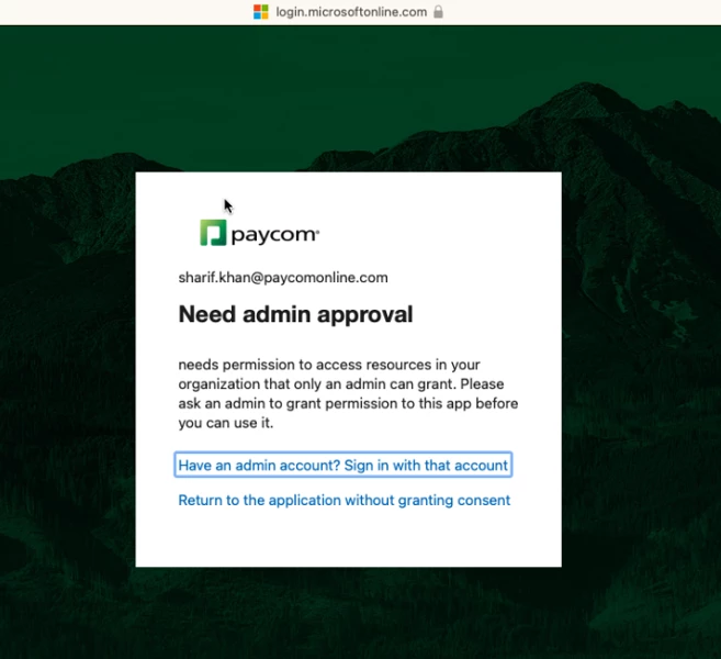

Hi Everyone,
Has anyone been able to solve this problem somehow? Although I asked both Jamf and Microsoft about this, I could not get a satisfactory answer or solution. Especially the Microsoft side is having a hard time understanding the problem. Is the main source of this problem Jamf Pro? Is it wrong for me to ask the Microsoft side a question? If anyone has found a solution can you please help me? I had to suspend a huge project right now. This pop-up is very annoying.
  • August 21, 2023
Hi @husnudagidir
For me this problem has been resolved. To resolve that we had to make chrome default with a profile and also we make a change in MS Azure for Jamf App like gave permission to access MS Azure from Jamf.

In our environment, Chrome is already used as the default browser. However, I can say that I do not fully understand the situation in the other sentence you said. I mean the following sentence.
"we make a change in MS Azure for Jamf App like gave permission to access MS Azure from Jamf."
Can you elaborate a little more on what exactly you do here? Because of this problem, our administrators may decide to completely remove Jamf Pro from the environment. So I urgently need a permanent solution. I would be very grateful if you could help.
  • August 21, 2023
@husnudagidir
You have to follow this document: https://learn.microsoft.com/en-us/mem/intune/protect/conditional-access-integrate-jamf and work with Azure AD for "Create an application in Azure Active Directory" from steps 1 through 16. Here step # 6 to Step # 11 is the part i was talking about. Here your Azure Admin needs to give permission to access Jamf API to access MS Azure AD to avoid that pop-up. I hope I able to make you understand.

Hi,
Actually, I remember doing these steps. Is the following field configured in your environment? I didn't do that. Because it has been said that this feature will be discontinued. I only did it by configuring the Device Compliance part.

Hello @robertoa
- Sam
