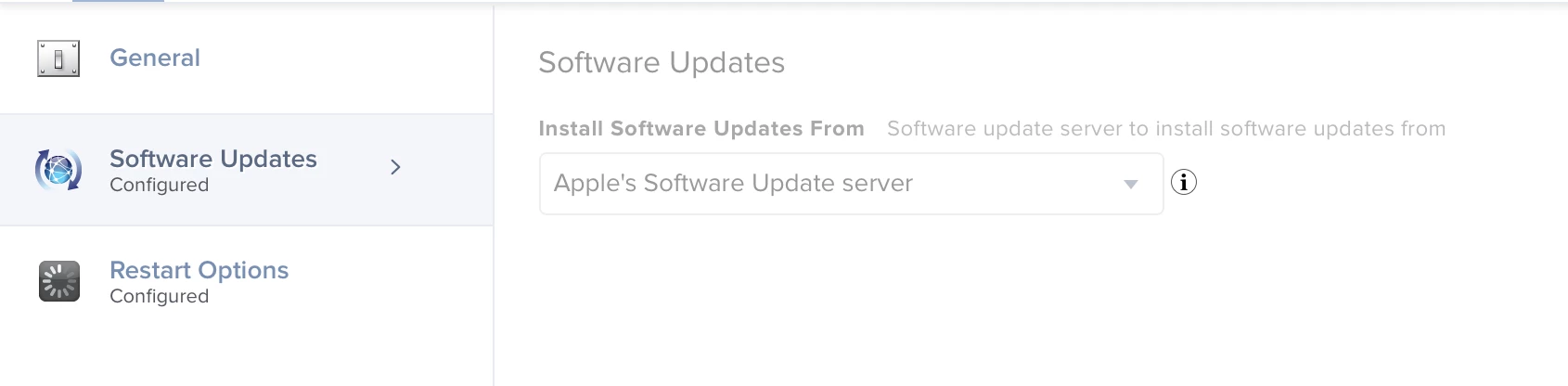

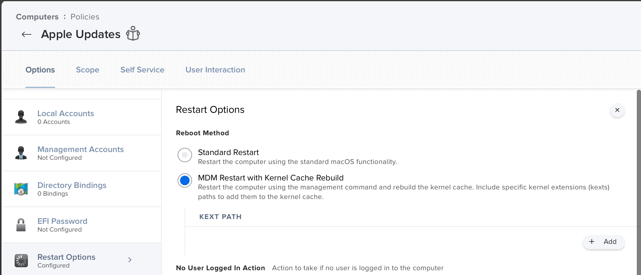

Hey Guys thank you all for your reply. We have develop a new way to do it. It can successfully download the new OS, but it won't install. it require not only a normal reboot. We are using the "Software Update's" interaction policy in Jamf. Following is the screenshot for the policy 28's selections.
  so I'm wondering what will be the suitable command letting the system to install the OS just downloaded. Big thanks

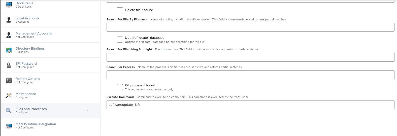

@CYL  go to the Files and Processes payload and run "softwareupdate -aiR". It's more reliable than the software update payload.
@CYLif this is an M1 device you will need a bootstrap token uploaded to the Jamf Pro server. Otherwise, forcing updates on an M1 devices is not possible.

@bwoods Thank you for the advice. I might done it wrong, but it shows that failed due to "authentication failed". this circle back to the start. I put my script as a DMG and run it as a package, and I'm not sure which box should I check in the Maintenance section.
@CYL made a mistake. You need to use the Files and Processes payload. Look for the section called "Execute Command". add "software update -aiR" to that section.
@bwoods for this method I won't need any other scripts or sectioned configured I suppose?
Correct, no packaging required. This payload will just run the softwareupdate command.
