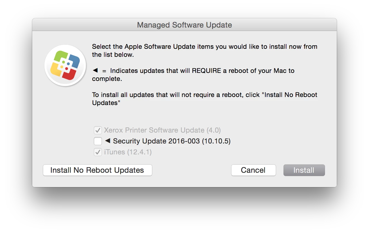

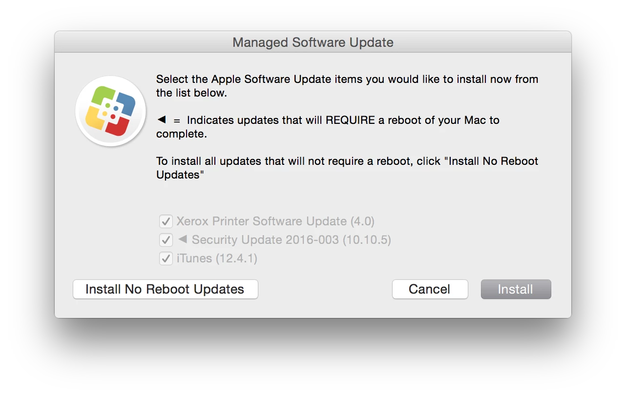

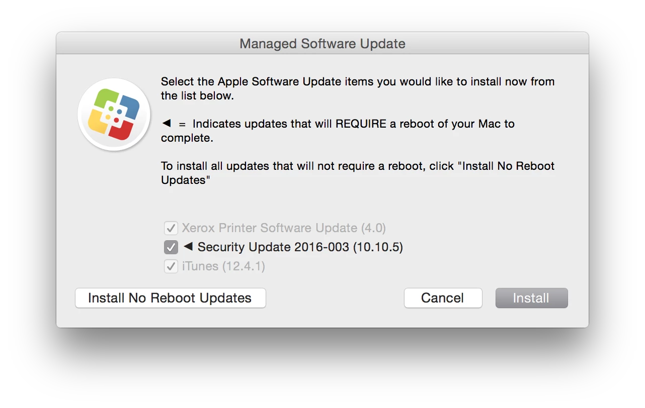

  • July 15, 2016
crazy questions @mm2270 How much work would it be to change your script to not include check boxes? Make more of a "here's what's available to install" in a list. I've taken a quick look at the code, but curious on your thoughts.
Thanks!
Matt
mm2270
  • July 15, 2016
@mbezzo Not crazy. Instead of removing the checkboxes, how about having them all checked but greyed out/disabled instead? Something like this?
Another option I thought of just now would be to have all the non-reboot updates checked and disabled, so the user can't refuse installs of those, but have the Reboot Required ones optional. It can be either not checked but check-able, like so:
Or, checked by default, but enabled for the user to uncheck it if they needed or wanted to.
All these options are possible, because cocoaDialog supports checked and disabled arrays that you can pass to it to tell it which checkbox items in the index should be set those ways. (Its why I continue to love the product and wish it would get some love to keep it viable)
Note that although I just whipped this up in about 5 minutes, I haven't actually tested an install run just yet. I will do that and see if it works as designed. I assume it should, but you know what they say about assuming. :)
