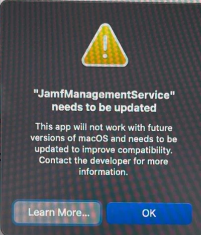

Hey All, I'm getting this message and also one that says JamfDaemon need updating.  I've gone through all of my scripts and EAs to see which ones were calling/using Python and all have been resolved, but I'm still seeing this on new Monterey installs.  Any ideas where else I can look?
Best answer by DBrowning
Did you change anything or just retest?
Changed the one EA that was still had python in it.

Started going through everything again this morning.  Found one EA that my previous searches didn't find using python.  I believe I'm good now.  Rebuilt a machine a couple times this morning and no longer seeing the popups.

Went through all our EAs with a fine tooth comb and removed all with python code. I don't believe I have any python scripts now in our EAs but after two new enrolments (on Monterey) this morning, I am still seeing the popup "JamfDaemon" needs to be updated. Any ideas if there is a different root cause? thanks.

Its most likely there is a line in your script that is calling python that is causing the popup.  You'll want to take a look at all your EAs. MacMule has steps here that can help you easily download all your scripts and EAs to look through.

You'll want to download or look at all your scripts and EAs and see if any of them call python.  I believe the folder will only show items apps run from the device.

So basically every time a RECON runs and goes through the Extension Attributes these 2 jamfdaemon or jamfmanagementservice warning will popup.

In Line 545 to 547 -> call to detect the current user
# After the Apple Setup completed. Now safe to grab the current user. CURRENT_USER=$(/usr/bin/python -c 'from SystemConfiguration import SCDynamicStoreCopyConsoleUser; import sys; username = (SCDynamicStoreCopyConsoleUser(None, None, None) or [None])[0]; username = [username,""][username in [u"loginwindow", None, u""]]; sys.stdout.write(username + "\\n");') echo "$(date "+%a %h %d %H:%M:%S"): Current user set to $CURRENT_USER." >> "$DEP_NOTIFY_DEBUG"

I'd update those calls to this:
LoggedInUser=$(scutil <<< "show State:/Users/ConsoleUser" | awk '/Name :/ && ! /loginwindow/ { print $3 }' )

All depends who wrote the script.  Some will use the full path some will use just python.  So you'd want to be looking for:
python /usr/bin/python
