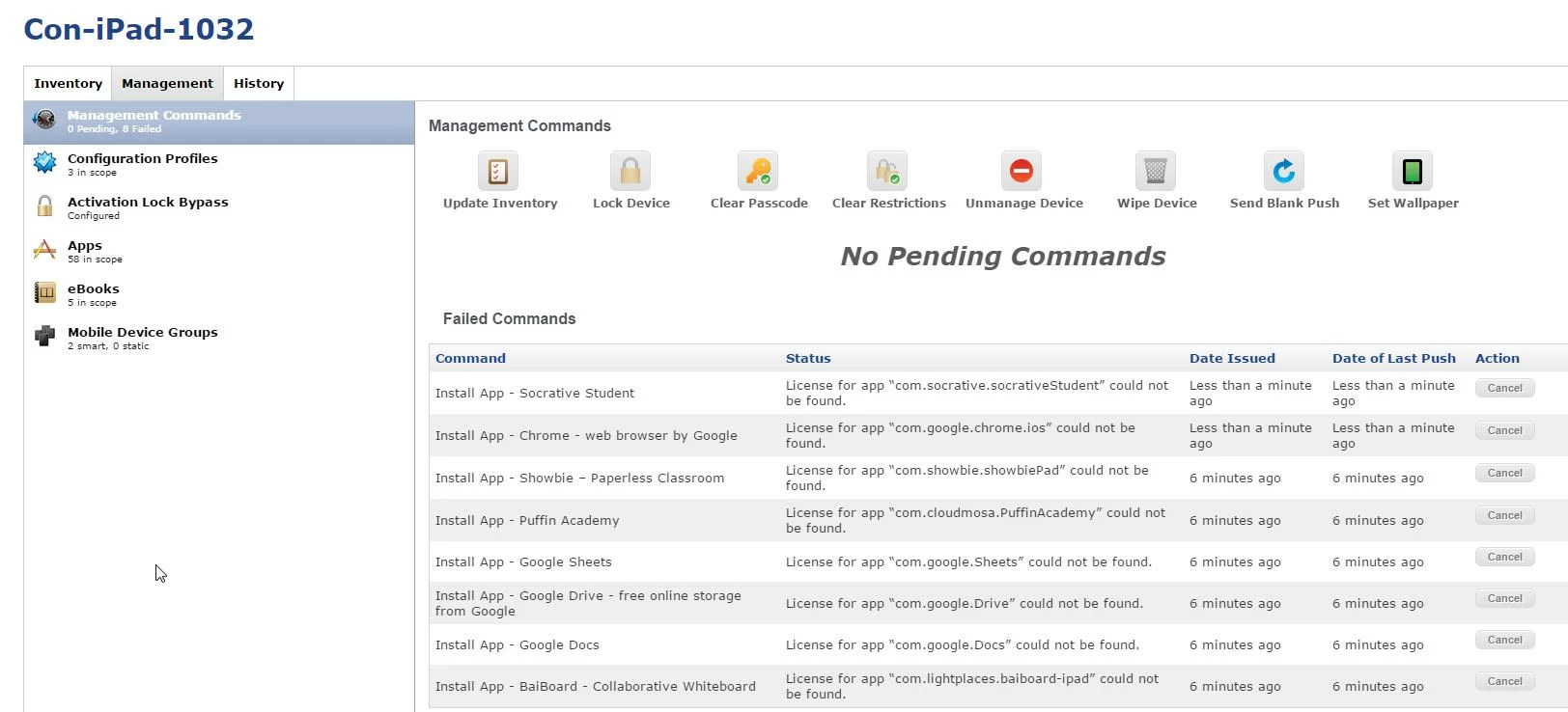

Im getting failed commands in the JSS for ipads status License for app "com.google.chrome.ios" could not be found and other google doc products and other free apps, no issues with paid apps? this is not every ipad and not every user some its a bit baffling? iver cancelled commands and sent blank push numerous times. Also when i go to self service to down load these apps the circle spins and then goes back to the install button, i can though down load from the app store fine?
anyone any ideas thanks.
More importantly "conitsupport" - how did you add the additional "Set Wallpaper" functionality? Please confess!
The iPad needs to be supervised for that option to be available. The easiest way to accomplish this is to put all of your iPads in DEP.
