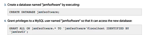

Created in Terminal Database below: CREATE DATABASE jamfsoftware;
'> GRANT ALL ON jamfsoftware.* TO 'jamfsoftware'@localhost IDENTIFIED BY '> 'jamfsw03';

i followed the steps exactly as in the installation manual.

I would make sure to do the steps that @m.donovan pointed out, instead of trying to do:
MySQL 5.7 will throw an error if you do it as one long command like above.

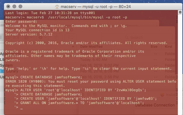

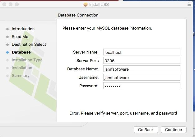

I am exhausted. Please view image above. I don't know what I am doing wrong?
The SQL Server is running
The following is installed:
OS: El Capitan
Casper: 9.100
javaforosx
jdk-8u161-macosx-x64.
SQL VERSION : mysql-5.7.12-osx10.11-x86_64
after all this , I keep getting.
Please verify server, port, username and password when i try to install JSS

Run the following two MySQL commands and display your output if possible. The output should show whether the database got created and whether the user got created properly.
show databases;
select user, host, authentication_string from mysql.user;
Assuming the database got created, the user got created and the password didn't get fat-fingered or something with the proper permissions, have you tried restarting the MySQL service. You could either do that in the System Preferences pane or by using to stop it:
sudo launchctl unload -F /Library/LaunchDaemons/com.oracle.oss.mysql.mysqld.plist
to restart it:
sudo launchctl load -F /Library/LaunchDaemons/com.oracle.oss.mysql.mysqld.plist
