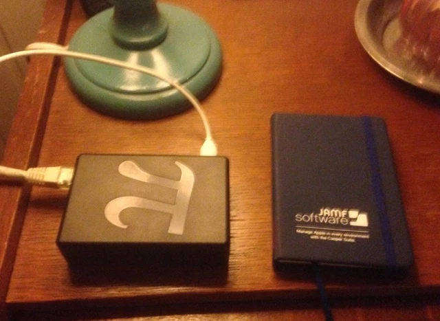

Thanks for sharing! Setting it up went very smooth and it runs ok on my Pi 2. Now i have a running lab environment on a device that is even smaller than my JAMF notebook!

Love the case! I run them in the raw.
