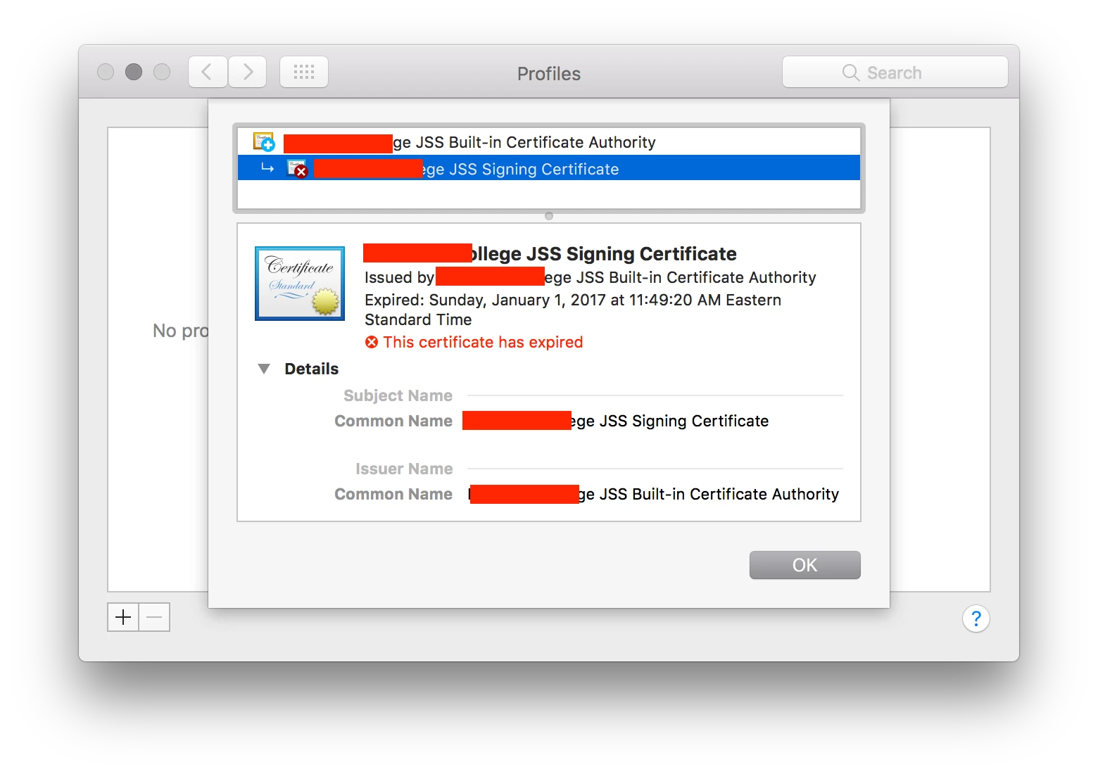

But, when I look at the MDM profile on the client machine, it's unverified because the "JSS Root certificate authority" is valid until 2021, but the JSS Signing Certificate says it expired on January 1st of this year.

Ok, I'm realizing this might be two separate things. I just put a public cert from Comodo on the LB, and my test machine enrolled successfully, since the cert is no longer expired. But my MDM profile on the test machine is still unverified, since the "JSS Signing Certificate", issued by the "JSS Built-in Certificate Authority", expired on January 1st still .

Inside MDM Profile it is showing JSS Signing certs expired on particular date and the profiles shows unverified. However if we remove and manage mdm again it resolves the issue.
But our certificates are not expired. Not sure how it is showing that date
