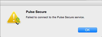

HI Jamf Nation,
I am running into a weird issue in which installing Junos Pulse when installed manually is able to start and add connections just fine. However, when packaging the app in Composer using the normal snapshot method, and packaged as a DMG. Has anyone experienced this or know of a fix? I have attached screenshots below. Thanks!
I get the following error:
Failed to connect to the Pulse Secure service.
This is what it should look like, done with normal install
This is after packaging with composer as a DMG using the snapshot method, Pulse Secure is turned off.
This is the error I receive when trying to add a connection from the DMG that was packaged.

We use Pulse and there is an install script that is required to run in order to get it installed. My install policy copies the actual installer pkg and a configuration file to /users/shared/ and then a script runs that calls upon the installer to reference the files. I was given the installer script by our Network team. I presume it's a script that was provided to them by Junos. You may want to look down that avenue. I would seriously doubt a snapshot is enough to get things working because it's a service that is basically always running and something (maybe a LaunchDaemon?) needs to get it going.
DBrowning
  • July 14, 2016
I have a snapshot package that I use to install Junos during imaging and stand alone if needed. I have baked in our configures. After the install we need to run a script to make sure each computer is getting a unique GUID so that when connecting machines don't kick each other off.
We used to see that error as well and after updating my package to the latest version it hasn't seemed to be an issue. Pulse 5.1.5 (60701)
Below is the script I created to do so.
# stop pulse access service
# remove local guid from connstore.dat
# restart service
sudo launchctl unload /Library/LaunchDaemons/net.juniper.AccessService.plist
sudo rm -rf /Library/Application Support/Juniper Networks/Junos Pulse/DeviceID
sudo sed -i .bak "/guid/d" /Library/Application Support/Juniper Networks/Junos Pulse/connstore.dat
sudo launchctl load /Library/LaunchDaemons/net.juniper.AccessService.plist

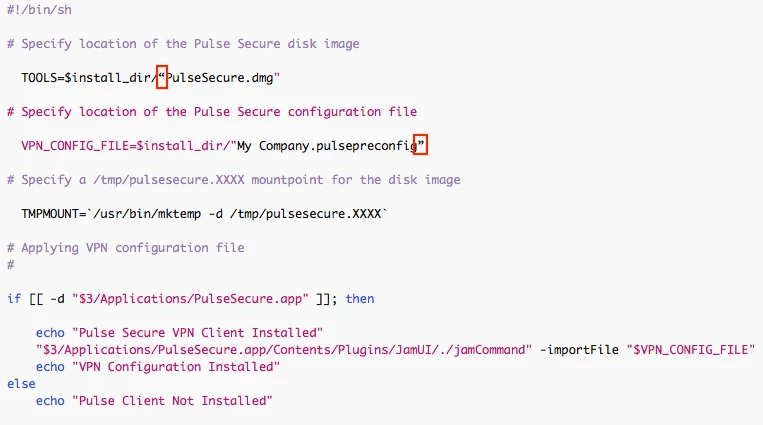

I have just been tasked with trying to get this to work. I have followed @rtrouton guide, and it does not work for me.
Being a new person to Mac, I am taking the unlikely road of "hey just take what he did and rename a few things and hope it sticks"
I know i am doing something wrong, as I am kinda flying blind with this.
The new version of Pulse Secure 5.2R4 is obviously named different than the Junos name, so in the script i renamed what I believe is correct.
I am leveraging Casper so I was not sure if there was something that needs to be done differently to the created package in order for it to work, but just running the .pkg on a machine does not install.
I see things like this is the install.log
./postinstall: installer: Error the package path specified was invalid: ''.
./postinstall: hdiutil: detached failed - no such file or directory
So without a doubt it is not working as intended.
If i am deploying it using Casper, do I need to check off "Require Admin password for installation"? I asume so as it is touching the Application folder.
My .pulsepreconfig file has a space in it, so not sure if that also has something to do with it.
This is just a snippet, but you get the idea that is is just a rename of the client and location names...

@kjohnson,
I think the script is being messed up thanks to smart quotes. I've marked in the script where I see them.
Smart quotes are not recognized as legal quote marks when the script is run, which may be why you're having issues. For more information, please see the link below:
https://derflounder.wordpress.com/2014/02/01/disabling-smart-quotes-in-mavericks/

  • September 16, 2016
Well that looks to have helped. It now installs, but the configuration file does not appear to import (postinstall).
If i understand the install.log, it is saying that it can't find the configuration file.
I am just running the package manually on a machine to test.
So i am definetly in the right direction now..

  • September 19, 2016
@rtrouton Thank you. I copied what you had and everything worked perfectly. I think it may have been how i did the sudo part.
Either case things are working.
