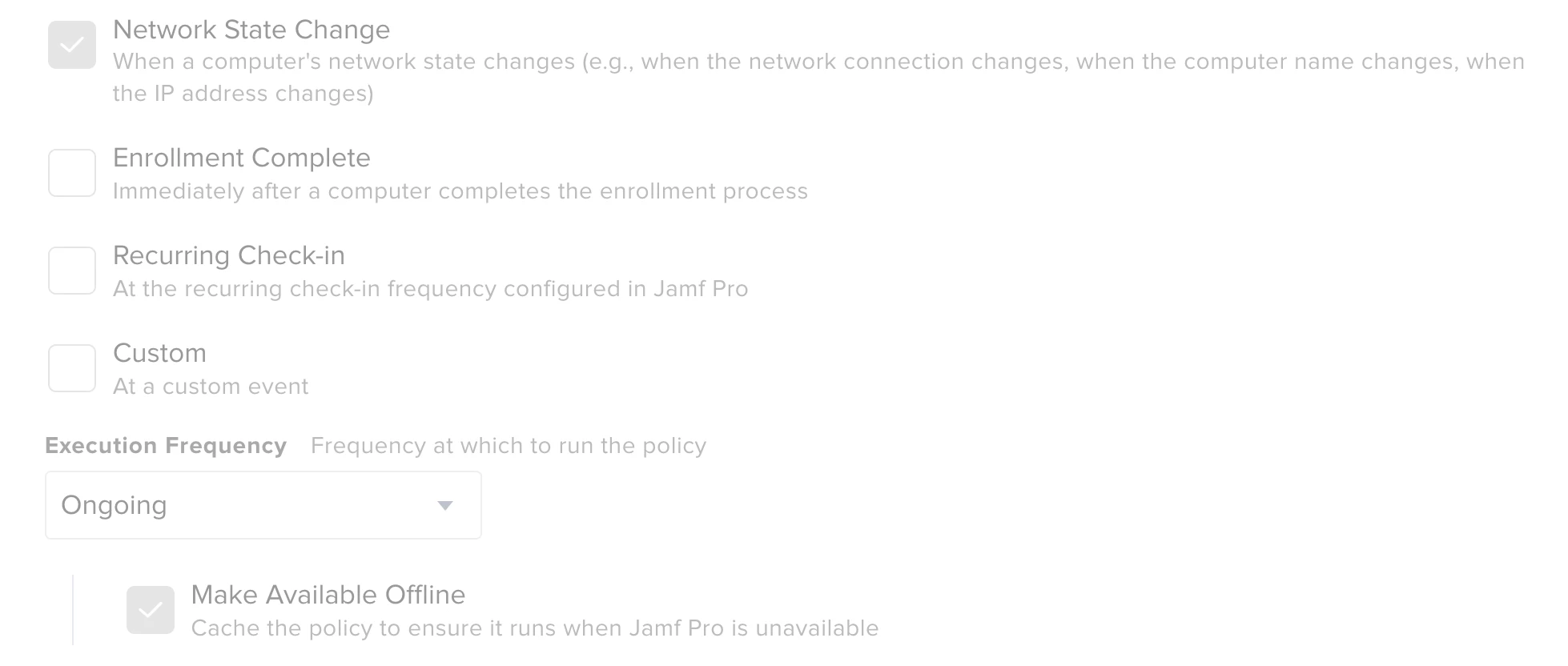

I found when setup as a policy, it works great to disable the wifi when ethernet is connected. But since its a policy, the script doesnt have an opportunity to run and enable the wifi again when disconnected. Did you have a solution for this?

@Taylor.Armstrong Does the script automatically turn WiFi back on when you disconnect from ethernet? If so how did you set it up? I created ongoing policy that triggers on check-in and network state change. Jamf confirmed that since its a policy and no longer has a network connection once I unplugged, it has no way of running and turning the wifi back on.
  • March 6, 2020
It does... not sure who @ Jamf gave you that info, but that's the whole point of the "make available while offline" checkbox.
I believe you'll have to go through at least one checkin cycle first, just so the script gets downloaded to the client, but after that... the policy isn't dependent on the server, so no online access needed for it to run. I'm typing this while on wired connection, now pulling the TB cable out of my laptop and....
9 seconds later by my count, I'm back up and running on wifi. Plug back in and....
18 seconds for me to switch to external monitor, grab DHCP from the dongle plugged into the monitor, and disable wifi.
  • March 6, 2020
@Taylor.Armstrong Wow, im surprised I didnt notice that box. But even more surprised that Jamf support didnt point it out. Sure enough, after checking it off, the script worked perfectly. Thank you!
  • March 6, 2020
My pleasure! I don't need to use it often, but when you need it, it is one of the most valuable check-boxes in the entire product :)
