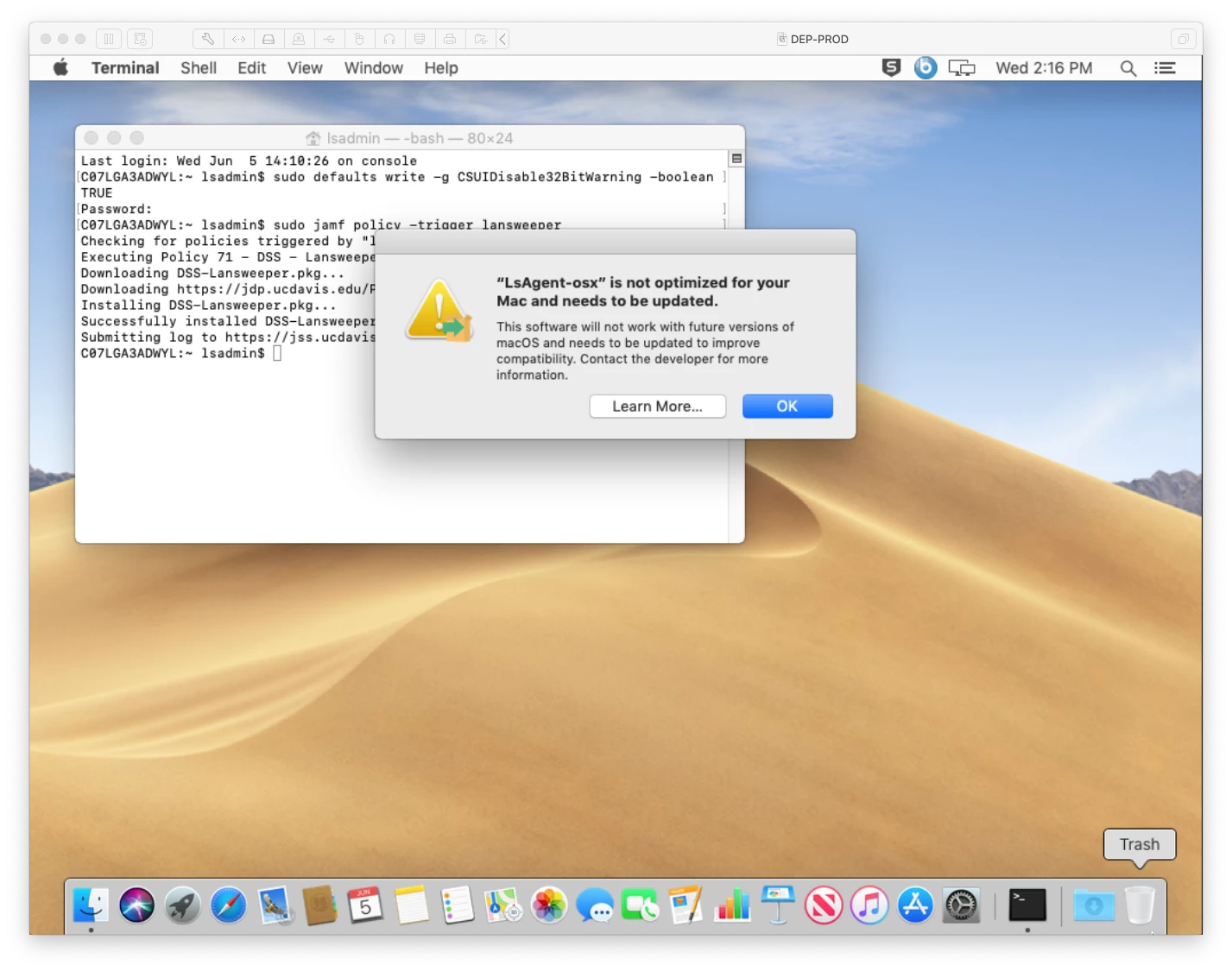

I was able to get the lsagent installed during our build sequence via @Chris script above, however we do get the "App not optimized" notification if we trigger the policy while a user is logged in.
What is the best method for running a policy only when no one is logged in? At log off?
kevin_v
  • Jun 7, 2019 3:21 PM UTC
Forgot to mention I tried disabling the 32bit warnings in that 2nd line of the terminal window without success.

In Mojave, you need to target the
com.apple.coreservices.uiagent
domain to suppress the warning,
here's a profile to do that.
The installer is 32bit. Contact LanSweeper support, there is an open Bug Report you can add your voice to ;)
The agent itself is 64bit.
