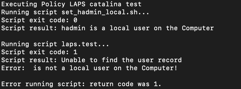

We have been using LAPS to reset our local admin password on a daily basis using https://github.com/NU-ITS/LAPSforMac
I noticed that now all machines running Catalina fail with the attached error related to permission. Any comments?

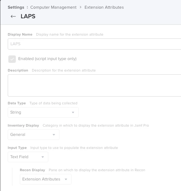

I think you need to make two "Extension Attributes" on your Jamf-server, LAPS and oldLAPS so both the old and the new password can be stored.

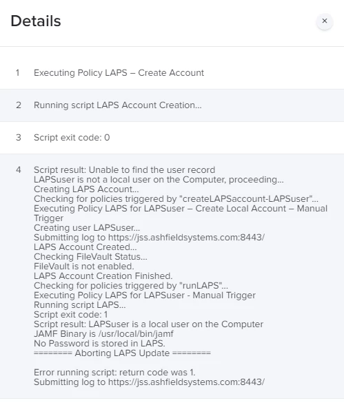

@chrgra Thanks that did help, however even now I have a value in LAPS, when the script runs it still says "No Password is stored in LAPS". So it can't read the LAPS extention attribute value. I gave the API account full rights but still no change.
  • October 1, 2020
Think you need to run "LAPS Account Creation.sh" so you have one pw in your extended attribute or you can edit the value your self.
geoff_widdowson
@chrgra The admin account was created using the script LAPS Account Creation. The password shows in the extention attribute LAPS, only after I created the second extention attribute oldLAPS. I have even edited the oldLAPS to include the same password. Still shows as "No Password is stored in LAPS" when the LAPS script runs.

  • October 1, 2020
In Extension Attributes it should look like this:
  • October 1, 2020

geoff_widdowson
Hi, @chrgra apologies on very late response to you post, had other issues to look at and LDAP is a bit of a side project.
My two extension attributes, LAPS and oldLAPS, look the same as your screenshot. Well they do now, I did have Location in the Recon Display, because that was what the github instruction said.
I might be entering the code into terminal wrong. I ran the first three lines in terminal with my own values for the apiUser, apiPass and apiURL
Everything after that I ran as separate lines verbatim, I didn’t get any error. After the last line $echo $oldPass, nothing was displayed on the return just a blank line and no error.
The result from the code in you last post resulted in an error as I assume I’m typing it wrong.
-bash: syntax error near unexpected token ‘)’
Other than that I also looked at the log for the LAPS policy and the result are odd. The admin account I am creating is called LAPSuser. It shows the password for LAPS is correct up until the end where is then says
Error: LAPS password for LAPSuser is not correct!
Full transcript below:
Executing Policy LAPS for LAPSuser
Running script LAPS...
Script exit code: 1
Script result: LAPSuser is a local user on the Computer
JAMF Binary is /usr/local/bin/jamf
A Password was found in LAPS.
Password stored in LAPS is correct for LAPSuser.
<html>
<head> <title>Status page</title>
</head>
<body style="font-family: sans-serif;">
<p style="font-size: 1.2em;font-weight: bold;margin: 1em 0px;">Conflict</p>
<p>Error: Duplicate serial number</p>
<p>You can get technical details <a href="http://www.w3.org/Protocols/rfc2616/rfc2616-sec10.html#sec10.4.10">here</a>.<br>
Please continue your visit at our <a href="/">home page</a>.
</p>
</body>
</html>
The old Password has been stored
Recording new password for LAPSuser into LAPS.
<html>
</head>
</p>
</body>
</html>
Verifying LAPS password for LAPSuser.
Error running script: return code was 1.

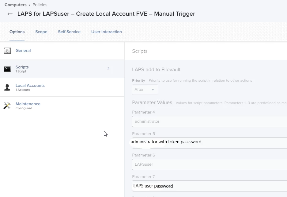

@chrgra I have everything working including FV. The reason I was having problems getting the password to save was I did not have my JSS url set in the LAPS Account Creation script on line 94.
I have FileVault working by adding my own script to the policy: LAPS for LAPSuser – Create Local Account FVE – Manual Trigger
SECURE_TOKEN_USER=$4
SECURE_TOKEN_USER_PASS=$5
NEW_SECURE_TOKEN_USER=$6
NEW_SECURE_TOKEN_USER_PASS=$7
# Give local admin user secure token using admin user credentials
/usr/sbin/sysadminctl -adminUser "$SECURE_TOKEN_USER" -adminPassword "$SECURE_TOKEN_USER_PASS" -secureTokenOn "$NEW_SECURE_TOKEN_USER" -password "$NEW_SECURE_TOKEN_USER_PASS"
exitresult=$(/bin/echo $?)
I also updated the LAPS script to include the line below, so that whenever the LAPS account pw is updated the preboot is also updated.
diskutil apfs updatePreboot /

@rossmclaren I followed the instructions and used scripts from from https://github.com/caffine247/LAPSforMac and on that page it links to an original readme https://github.com/caffine247/LAPSforMac/blob/master/original_readme.md. That original readme explains how to set up everything, groups, policies and extention attributes. The thing is some things are missing (or I could not see them) such as on the LAPS Account Creation script you need to manually update line 94 to your own jss url. You also have to create two extention attributes LAPS and oldLAPS, chrgra above explained that to me and has posted a screenshot on 10/01/2020.
The Filevault policy as written on the github does not work post macOS 10.13, so I made own script as posted above.

I'm having some trouble with implementing LAPS for our organization & I was hoping to get some of your help.
(1) I have 3 scripts saved in my JSS server:
LAPS Account Creation Script: https://github.com/unl/LAPSforMac/blob/master/LAPS%20Account%20Creation.sh
(Link found in the instructions of the original readme file over here: https://github.com/caffine247/LAPSforMac/blob/master/original_readme.md)
For this script, the only edit I made was to update the apiURL to my JSS url, which is cloud-hosted: "https://__.jamfcloud.com:8443"
LAPS Script (based on the latest commit by caffine247): https://github.com/caffine247/LAPSforMac/blob/master/LAPS.sh
(*allegedly updated for mojave)
LAPS Add to FV Script: This is the one you posted above in the thread.
(2) I've set up two extension attributes under Computer Management
  • LAPS (Enabled, String, General, Text Field (Input Type), Extension Attributes (Recon Display)
  • oldLAPS (Enabled, String, General, Text Field (Input Type), Extension Attributes (Recon Display)
(3) I've set up 5 policies
Policy 1: "01 LAPS for edusysadmin - Create Local Account - Manual Trigger"
- Trigger: Custom createLAPSaccount-edusysadmin
- Execution Frequency: Ongoing
  • Script: LAPS Add to FV Script:
  • Parameter 4: Name of local admin account (has secure token)
  • Parameter 5: Password of above local admin account
  • Parameter 6: edusysadmin (name of LAPS admin that I'm intending to create)
  • Parameter 7: Password of the above LAPS admin
+Local Accounts
- Create New Account
- Username: edusysadmin
- Password: Password to the above account
- Home Directory: /Users/edusysadmin
- Allow user to administer computer (ticked)
Policy 2: "02 LAPS for edusysadmin - Create Local Account FVE - Manual Trigger"
Everything here is the same as Policy with the exception of:
- Custom Event: createLAPSaccountFVE-edusysadmin
- Local Accounts: Enable user for FV2 is enabled
Policy 3: "03 LAPS for edusysadmin - Manual Trigger"
  • Trigger: Custom: runsLAPS (once a day)
  • Scripts: LAPS Script (latest commit for mojave)
  • API Username: <new jamf acc>
  • API password: Password to the above jamf acc
  • LAPS Account Shortname: edusysadmin
Policy 4: "04 LAPS for edusysadmin"
  • Trigger: Recurring Check-in
  • Execution Frequency: Ongoing
Behaviour
(1) I managed to create a new local admin account with "edusysadmin" on the machine. I can see it under Users & it's also showing up on Jamf Inventory after I did a sudo jamf recon on Terminal.
(2) Your FV script is also successful at granting that user "edusysadmin" a secure token.
(3) Policy 4: LAPS for edusysadmin failed to run:
Here's what the logs said:
Executing Policy 04 LAPS for edusysadmin Running script [Sys Config] LAPS Script... Script exit code: 1 Script result: Unable to find the user record Error: is not a local user on the Computer! Error running script: return code was 1.
If you can point me in the right direction, I'd be greatly appreciated!
Thank you, @geoff.widdowson !
