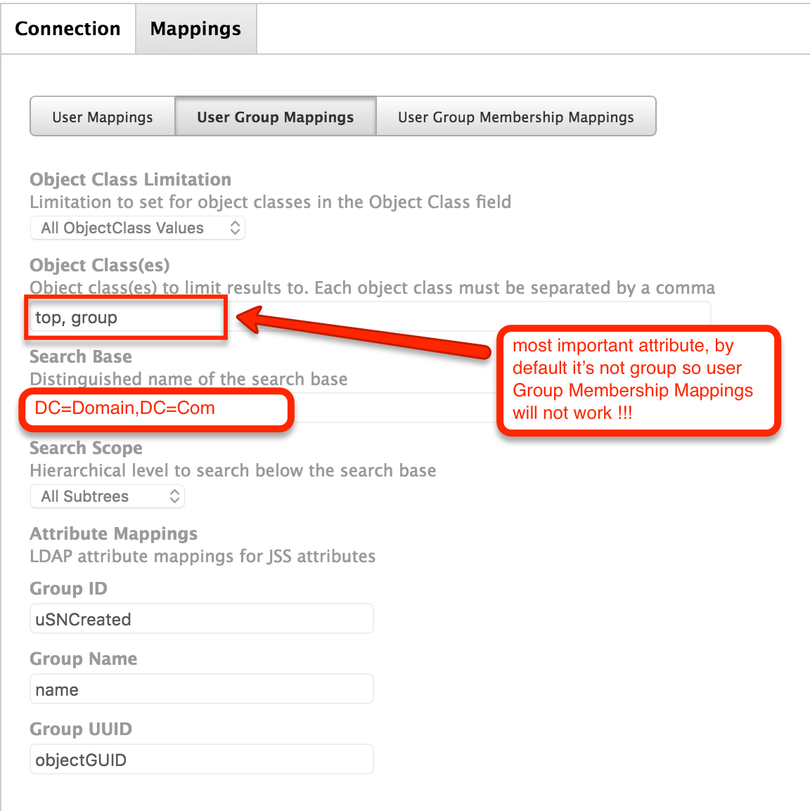

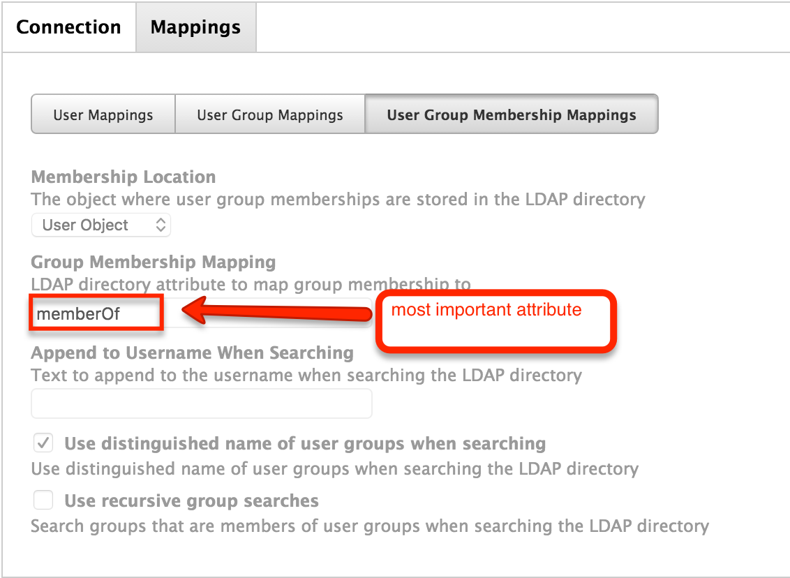

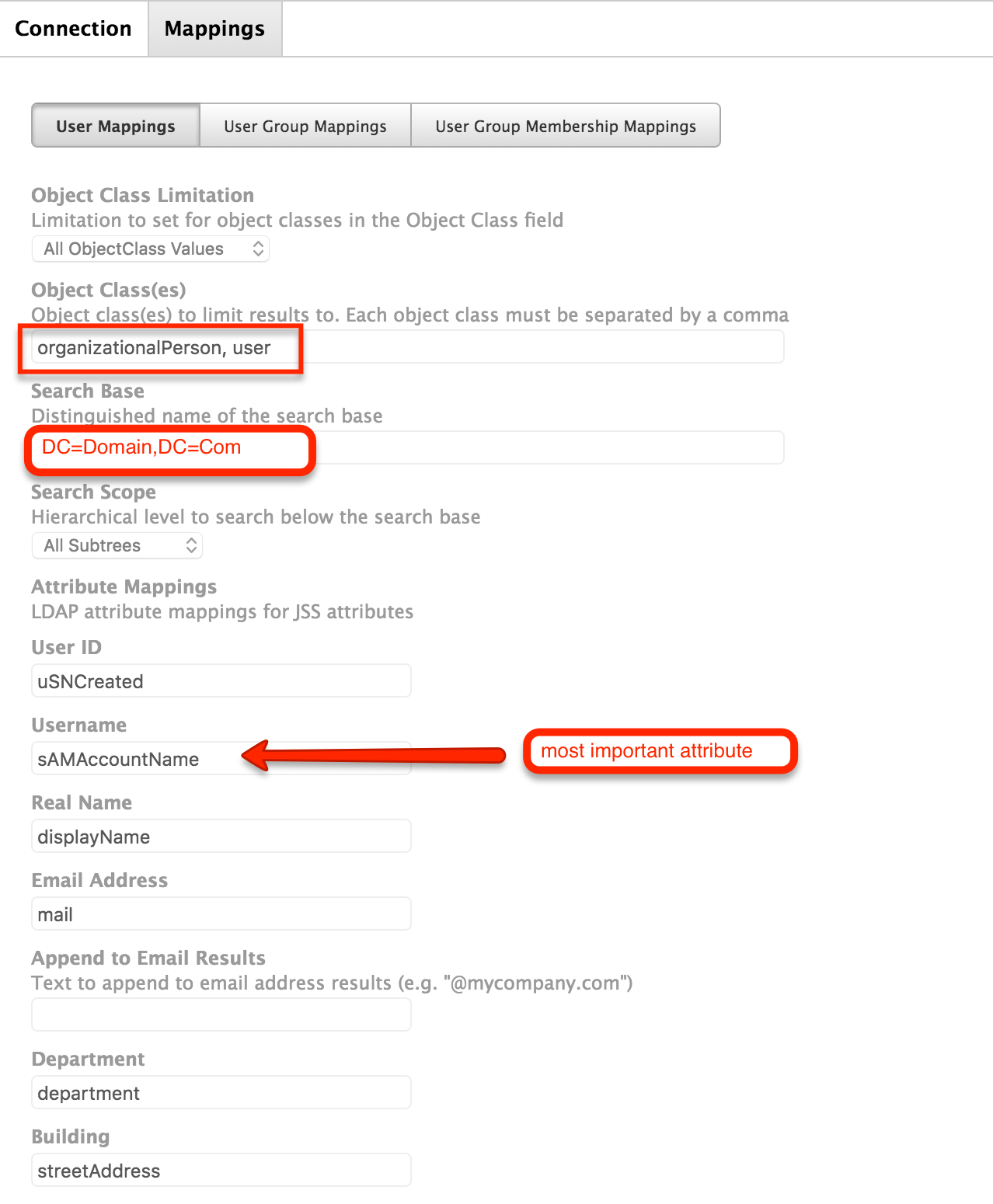

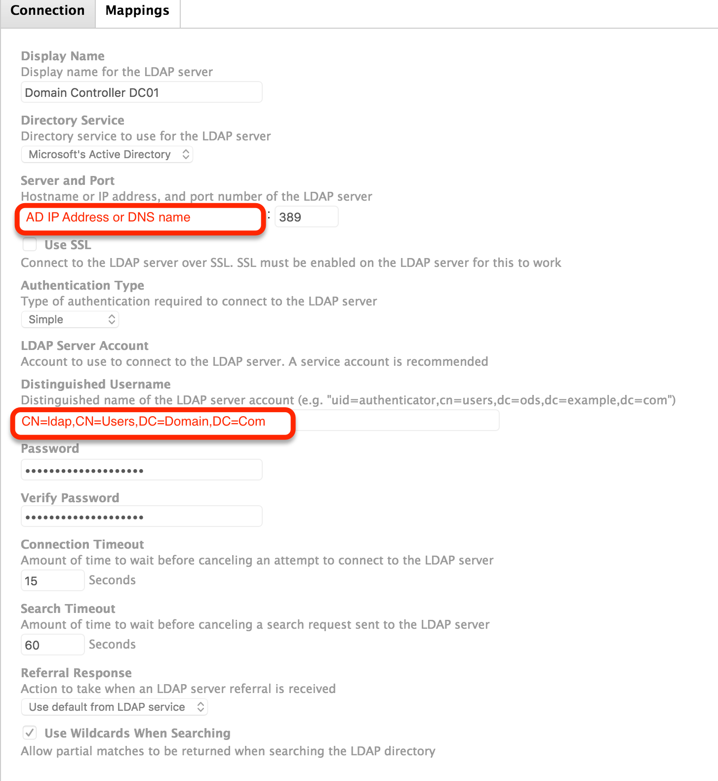

In order to Configure LDAP Server use the following settings :
1. Create a general user for ldap search called ldap under users organization unit.
2. Change the LDAP Mappings as followed : - User Mappings - User Group Mappings - User Group Membership Mappings
