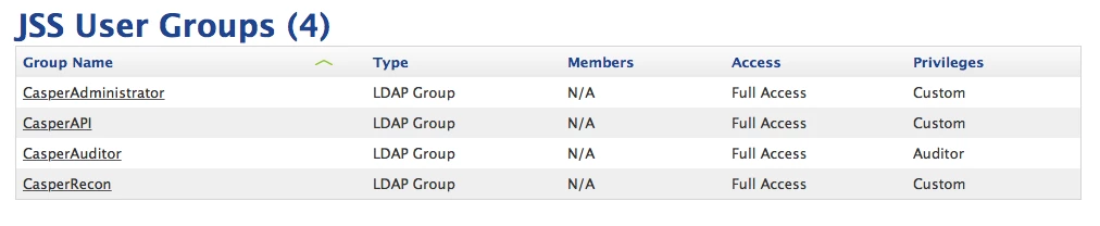

I've got all the mappings working so that the test cases in the LDAP settings work as intended, but when I go into the JSS User Accounts & Groups section in the JSS, the groups show up, but the Members still shows as "N/A". I definitely have members in each of the groups in my Active Directory.
Any thoughts?
Forum|alt.badge.img+15
  • August 5, 2015
Hi @krispayne my groups show the same under members. Does authentication work for the users in those groups?
Dan
  • August 5, 2015
@dderusha, I am able to login with my test AD account, so no issues there, just was curious to see the grouped members in the JSS vs. going into AD

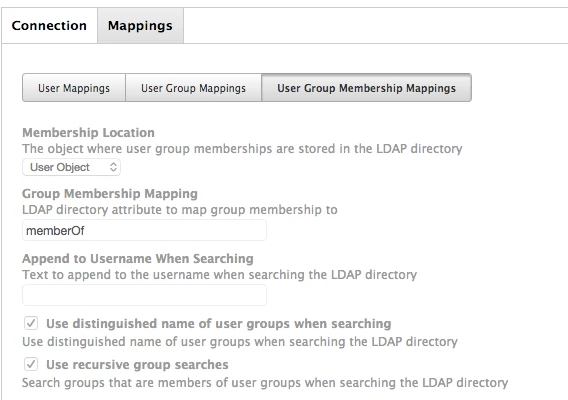

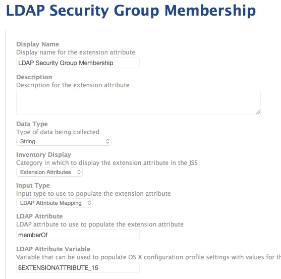

Related to this, I've been trying to get an Extension attribute working that lists all security groups from AD that the user is a part of. At the moment, the extension attribute is only displaying 1 security group, not all of them. Any ideas if I'm doing something wrong?
Extension Attribute listed on computer:
LDAP Security Group Extension Attribute settings:
JSS LDAP User Group Membership Mappings Settings:

Thank you so much for the post @dderusha I've been trying to figure out why I couldn't scope to a security group in LDAP and making sure that our LDAP was set up properly made everything work.
This helped so much and solved my issues on Computer Records, Management, Policies, I was getting an LDAP error and once I changed it to User Object the error went away!
Specific Error: ERROR CALCULATING POLICIES IN SCOPE
Check that your LDAP server is properly configured and accessible
