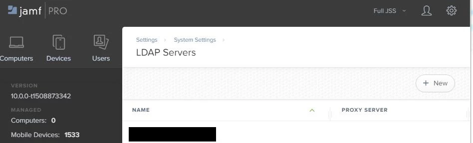

Hi we are in the process of taking over a primary school and already have our school linked to Jamf Pro via Active Directory(AD) and im wondering whether we can simply just add another AD server to our JAMF Pro for authentication. At present our server is internal BUT we do have a DMZ server setup for outside of school connections / access.
Is it feasible and has anyone done this? if so how?

Basically if i add another Active directory server here, would it overwrite our existing school one? or would it now look at both AD servers for authenticating users when enrolling iPad?

It would use both. It would start searching in the one with the lower JSS ID as shown in the JSS url when in the object, essentially always prioritizing the one that was created first. Some orgs use this logic if they have a really large directory and actually add the same AD multiple times, first starting with the main OU they plan to search and then adding it again with the full or larger OU so that way it would search one specific one first prior to moving on to the entire domain.

Thanks for the responses, im really just waiting on JAMF to say yes it wont break what you've got setup, but with this information i think i may try / test it out, Sterritt. as for duplicated we have different naming conventions for the AD Accounts (or will have)

You can absolutely add two. We have both a staff and a student domain set up slightly differently and it's worked fine for many years.

Thanks people for your replies, ive set it up and its working.
