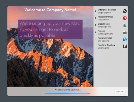

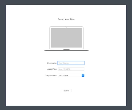

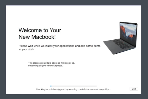

I realize this is the SplashBuddy mini event discussion. But, I did tell the attendees I would share these links to all three uFBI titles and here they are. Some Assembly Required... Good Luck.
Download locations:
SplashBuddy - Francois Levaux-Tiffreau
http://jamf.it/splashbuddy
DEP-Enrollment - tramscloud.co.uk
previously maintained by Gavin Pardoe http://jamf.it/depenrollment
Progress Screen - Jason Tratta
http://jamf.it/progressScreen

1) Will any of the above appear over the top of the login screen? I'm intrigued with the idea of using one of these, but I would need it to run at the login screen, as we skip user creation and as many of the other Setup Assistant steps as possible.
2) I see DEP-Enrollment has some possible interactivity. Ideally, I'd like to have a solution that, in some way, allows for setting the computer name, as we would then use this for lab and classroom computers, which have a particular set of policies that run based on computer name. Is DEP-Enrollment my best bet in this case, or is there one or more of the above that will work (again, keeping in mind that this would all have to work above the login window).
