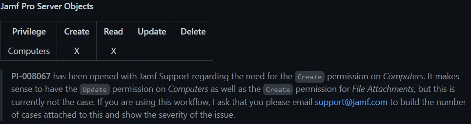

I'm trying to set up and test LogCollection. I created a Jamf user account and want to give it the barest privileges, only what is needed to connect and upload the logs. The only privileges I have configured for this account is create/update Attachment Assignments and create/update File Attachments.
When I run the policy, I get the error "The request requires user authentication". What else do I need to provide this account to be able to connect and upload the log files?

Found answer in FAQ https://github.com/kc9wwh/logCollection/wiki/FAQ's

Can someone please help me with the exact Jamf user permissions ?
  • February 14, 2023
In https://github.com/kc9wwh/logCollection/wiki/FAQ's:
