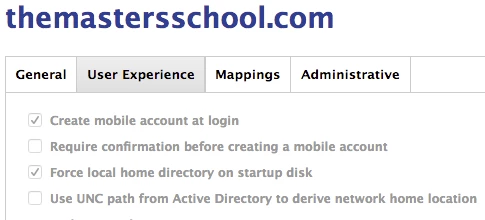

@Crowe87 this is a well known issue that we experienced ourselves and had to learn the hard way.
It has to do with the deriving of the UNC path setting in Directory Bindings. Just uncheck that box. You can update this setting on already deployed machines by running the following command:
sudo dsconfigad -useuncpath disable
If you use this to derive the user's network folder, you'll also want to disable the sharepoint setting as well:
sudo dsconfigad -sharepoint disable

@aporlebeke Thanks for the reply mate.
Tried adding in these commands but the problem still persists.
What I've noticed is when the little orange dot does not appear in user name field the login fails. On occasion it will be there when the computer connects using the loginwindow credentials, but most of the time it will not appear until the second time you try to log in.
