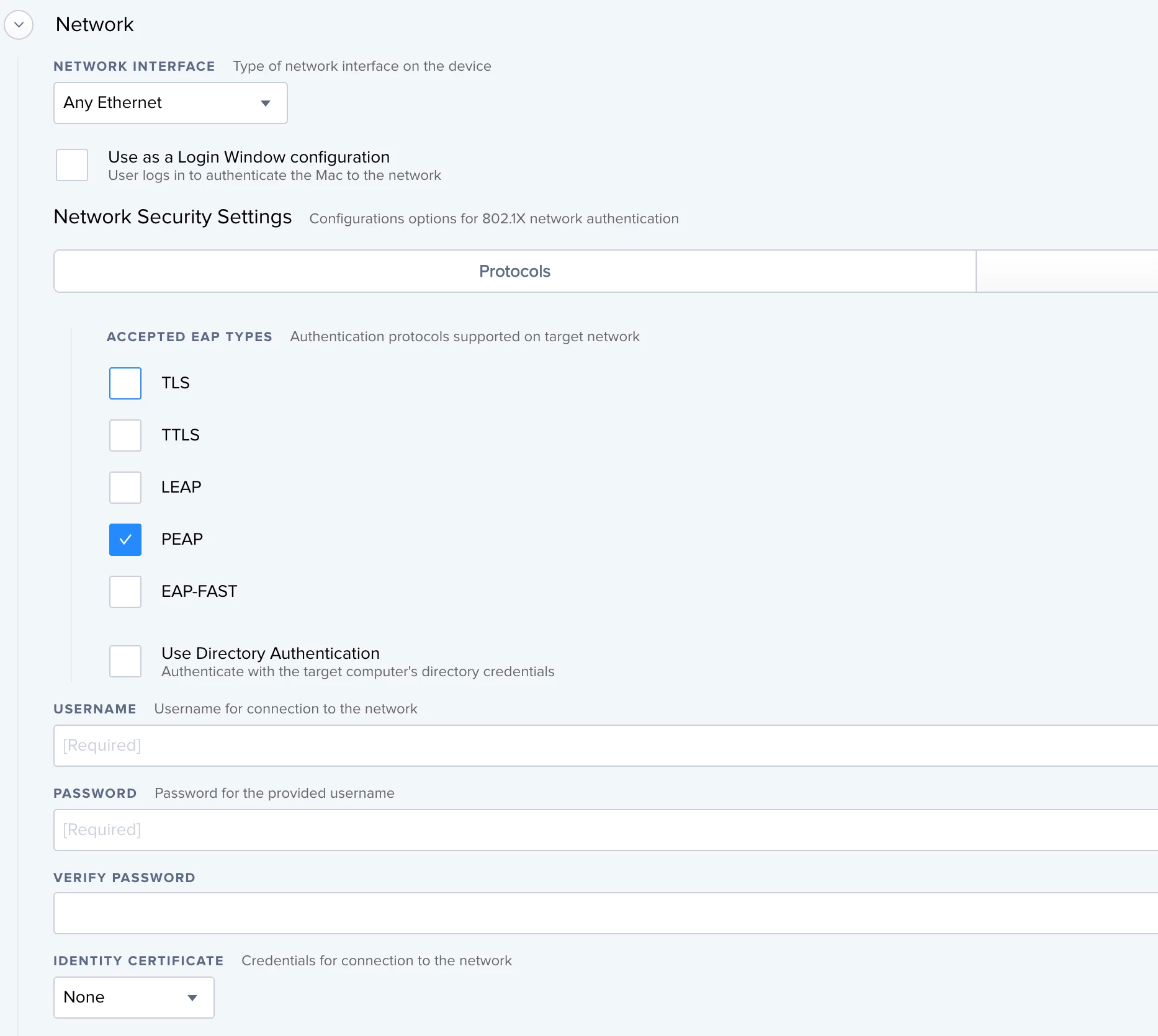

Our network team has started to roll out 802.1X port policies around campus. On the Mac side it's causing a bit of a problem. Our Macs are bound to AD so they should be passing credentials. I set up a config profile for 802.1X to our network teams specs. It works and doesn't work at the same time.
On my Mac for example, if I restart it, I don't get authenticated, I have to go into network settings and hit connect on 802.1X and then it's fine. Obviously this is a problem for users because they will not know what to do unless guided.
I have it setup as follows
Network Interface - Any Ethernet
Use as a Login Window configuration - Checked
Accepted EAP types - PEAP
Use Directory Authentication - Checked
Like I said, it works if I manually hit connect but I need it to authenticate at login. From what I understand I shouldn't need a config because macOS is supposed to pass this automatically but that also doesn't work.
Any advice?

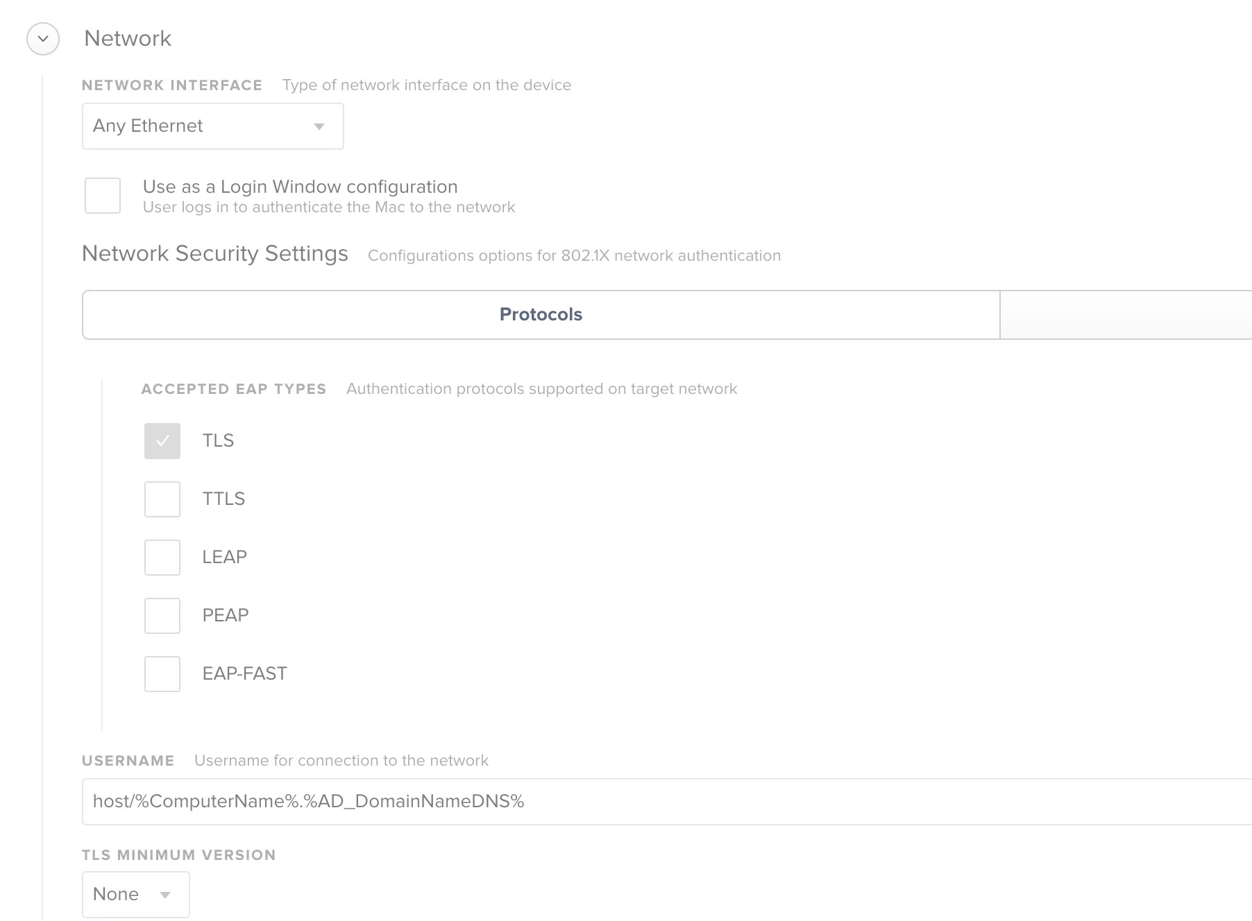

Also would look at this post I commented on as we had to make sure our 8021x could use a CA issued unique name cert (system SN#)
Not sure if same setup you are using but something that took a Apple Enterprise Support request to figure out (changing username to host/%ComputerName%.%AD_DomainNameDNS%)

@sbirdsley I looked at the post you linked, are you referring to the username field that comes up if you DON'T select "Use Directory Authentication"? If so, the password field is required. I would just put host/%ComputerName%.%AD_DomainNameDNS% in that username field or somewhere else?
  • July 12, 2018
@dmitchell The username filed is under the Network payload and TLS is selected, If not using TLS not sure if won't see this
  • July 12, 2018
@sbirdsley Ah yes, PEAP is slightly different and requires a PW, I guess i'll need to talk to my network team or use a role account but that kind of defeats the whole purpose.
