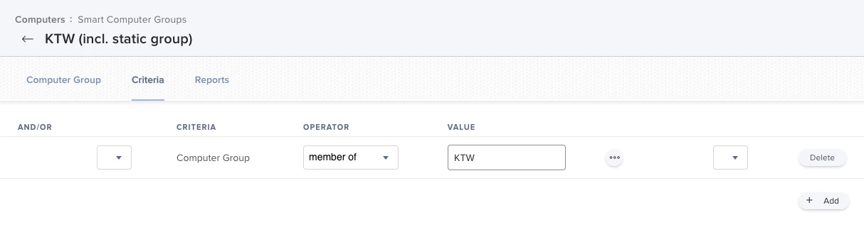

@erichughes one workaround that has been pointed out to me is that you can create Smart Groups that use a Static Group as its criteria. I know that this is 'clunky' as you would have to create a new Smart Group for each Static Group that you want to use in App Installers however it will work. In the attached screenshots you can see where we have used a Static Group called 'KTW" as the criteria for a new Smart Group called 'KTW (inc. Static Group)'. This Smart group is then available to select in my App Installers scope.

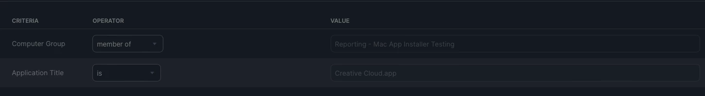

An exclusion groups option would be nice as well.  Currently piloting this with a bunch of apps and what I had to do was make a static group to add the actual machines into, and then a smart group that shows all members of the group that currently have the application I am trying to update installed.  If I don't do that it the application is going to install as soon as I add it to the static group, even if the machine doesn't already have it.
