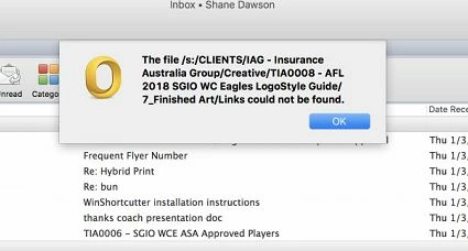

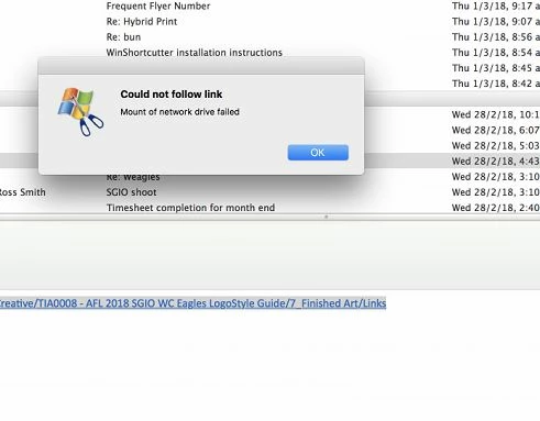

I hope we might be able to find a solution to this. I have a Mac user who is quite successfully connected to a Windows Domain and has no trouble any other way of connecting to the data drive through Finder and such. However, when he is sent a link via Outlook email for Mac if he clicks on it he gets the error, "Links could not be found" and if he right clicks and goes to Services and to Open as a Windows Link he gets a "Could not follow Link, Mount of Network Drive Failed" error. Please see attached pics.
He already has installed WindowsShortCutter and set that up but nothing happens. As I said there is nothing wrong with the actual Network link to the required drive he can manually follow link but for some of them they are rather long and it just shouldn't happen...lol.

This is because your machine has no idea where 'S:' points to. Its the same if you paste a link from a mac machine to a PC user, it has no idea of the originating server that is attached to /Volumes/.
A way we have around this is that all of our shares are advertised on DFS and mac users can connect to them using SMB and the oonly difference in the path is / or depending on the platform.

The Outlook icon looks like it is from Office 2011.
Support ended last October. Does it balk if you use Outlook 2016? (Dunno if you have a license, but worth a try.)
Also, the syntax looks a little off. Does it work if you add a second front whack after the /s:/... so it looks like /s://CLIENTS... ?
  • March 7, 2018
@EyeSpy8 yeah the problem as was mentioned earlier is that Macs don’t mount network shares as drive letters. Most likely the actual file path it is mounted under is /Volumes/CLIENTS/IAG - Insurance Australia Group/..../.../
All Windows Shortcutter does usually is invert the paths from servernamewindows sharesomefilepath to smb://Windows share/some/file/path and from what I remember COULD mount/access the network share if the url to the file started as the server name itself.
