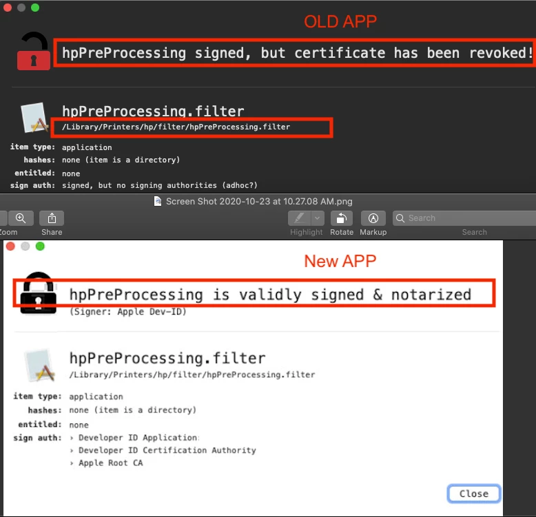

Another option is replacing the code signature of the process with an adhoc signed one. I used console to determine that ,in my case, the code signatures for hpPostProcesing and hpPreProcessing were invalid. I used the following terminal commands to replace the code signatures of each binary and now users are able to print. I have only tested this on macs with issues on HP printers.
sudo codesign -f -s - /Library/Printers/hp/filter/hpPostProcessing.bundle/Contents/MacOS/hpPostProcessing
sudo codesign -f -s - /Library/Printers/hp/filter/hpPreProcessing.filter/Contents/MacOS/hpPreProcessing

We found that the code signing cert was revoked for some of the HP software including frameworks at /Library/Printers/hp/Frameworks
Download the HP Easy Admin app. Then download hp-printer-essentials-S-5_15_8_4.

Note: I used the app "What's your sign" to confirm that the signing cert was expired. Very cool app, check it out.

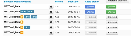

Update: It seems they pulled MRT 1.68 and re-issued MRT 1.67 on 10/24/20

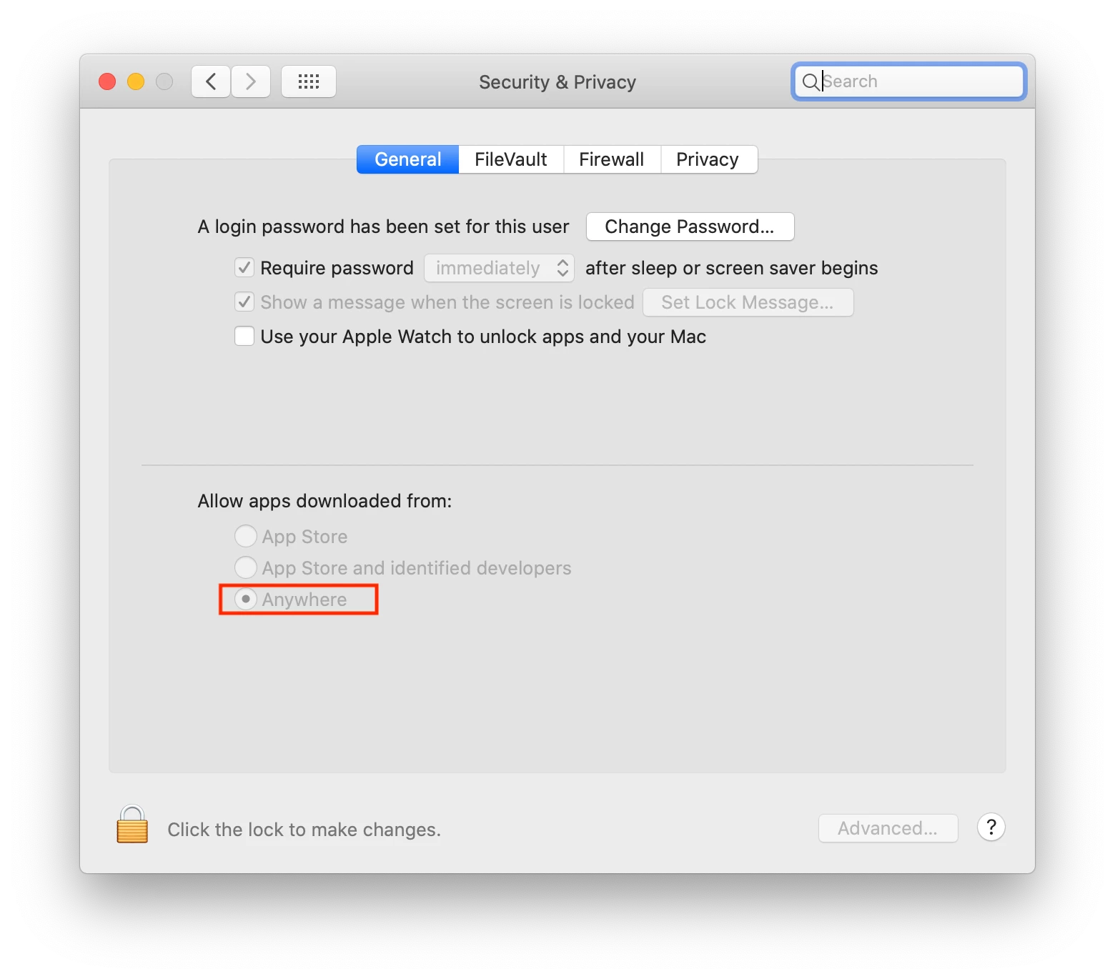

Actually, would this have affected Macs that had Gatekeeper set to "Allow apps downloaded from: Anywhere"?
When running the following command to look at the HP Utility app
spctl --assess --type install --context context:primary-signature -v /Library/Printers/hp/Utilities/HP Utility.app
For problem machines if they are set to only allow apps downloaded from the "App Store" or "App Store and Identified developers" then you will get the following back:
/Library/Printers/hp/Utilities/HP Utility.app: rejected Source=Unnotarized Developer ID
If you run this command on a machine set to "Allow apps downloaded from: Anywhere"
You will get the following back:
/Library/Printers/hp/Utilities/HP Utility.app: accepted override=security disabled
