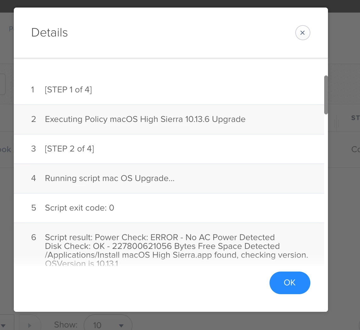

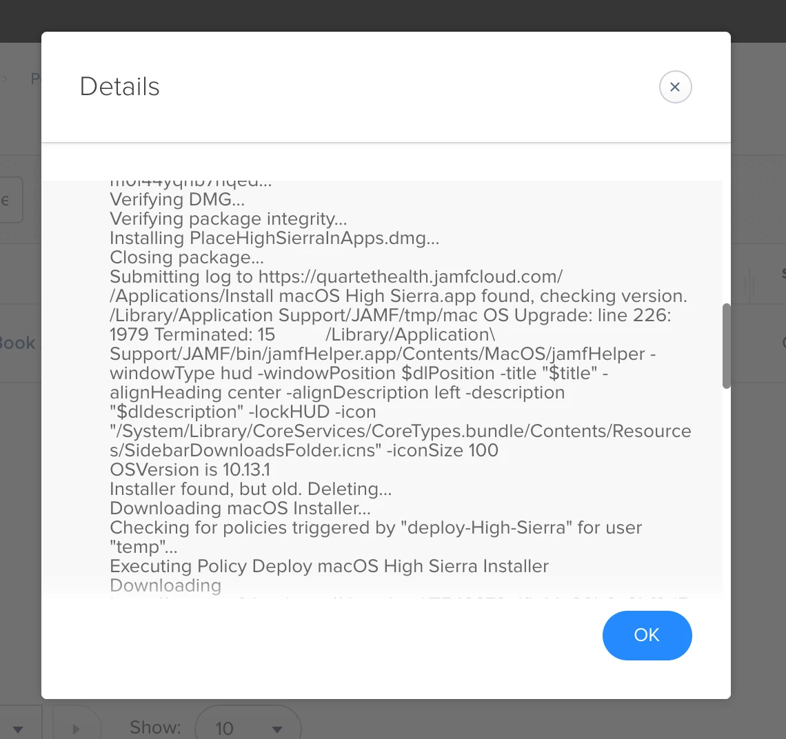

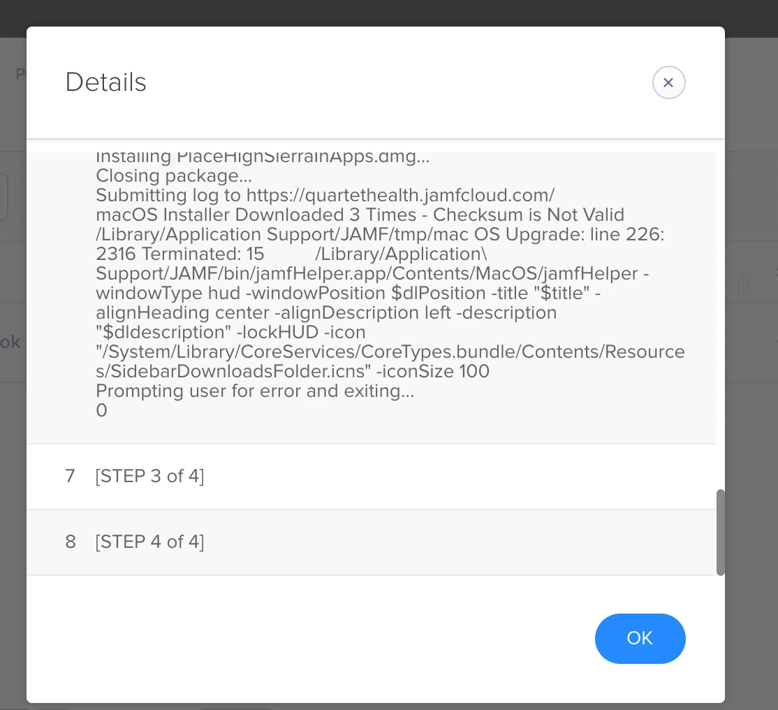

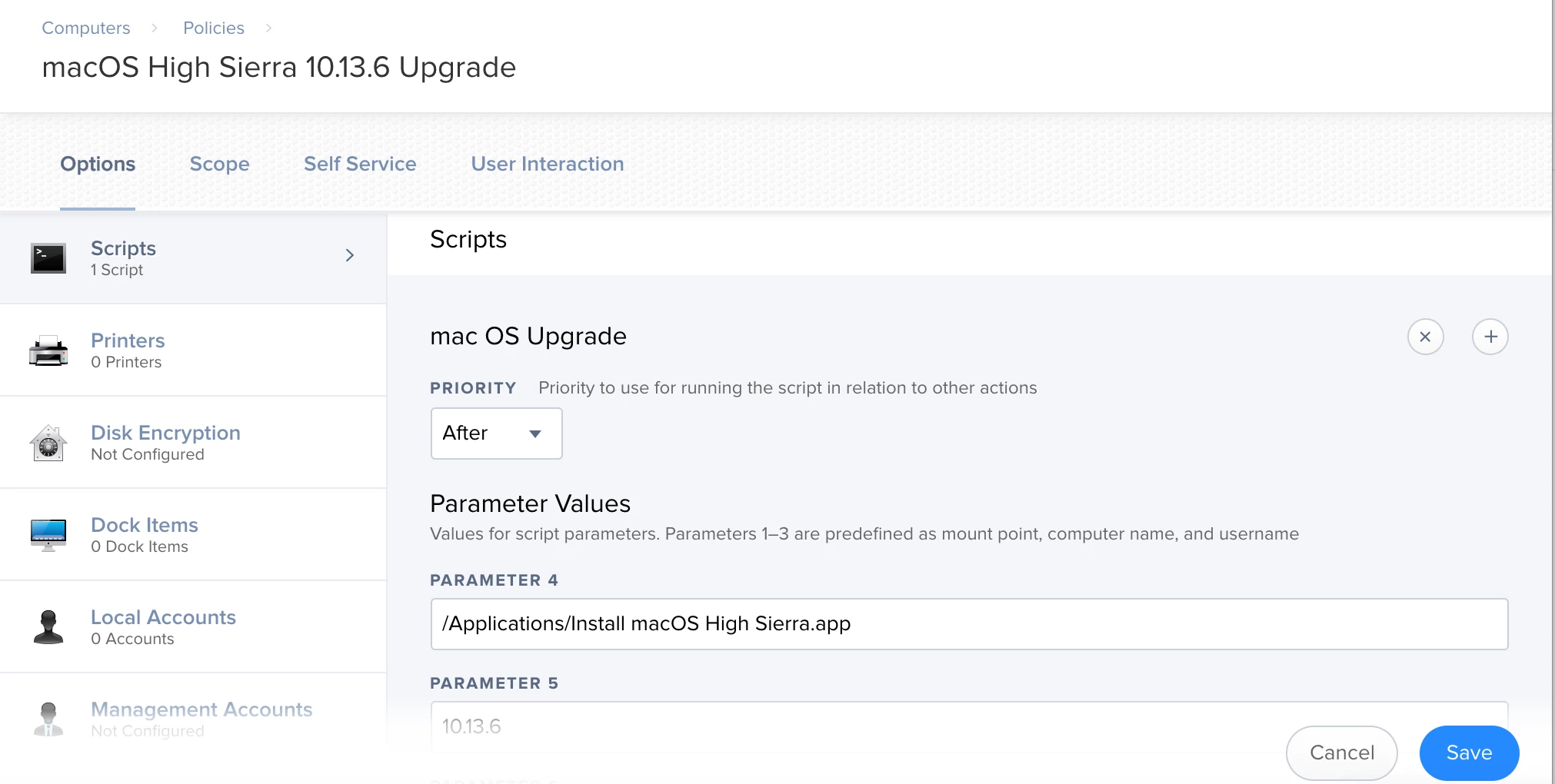

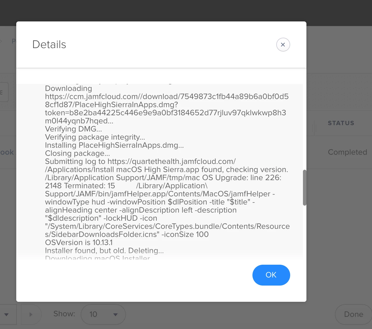

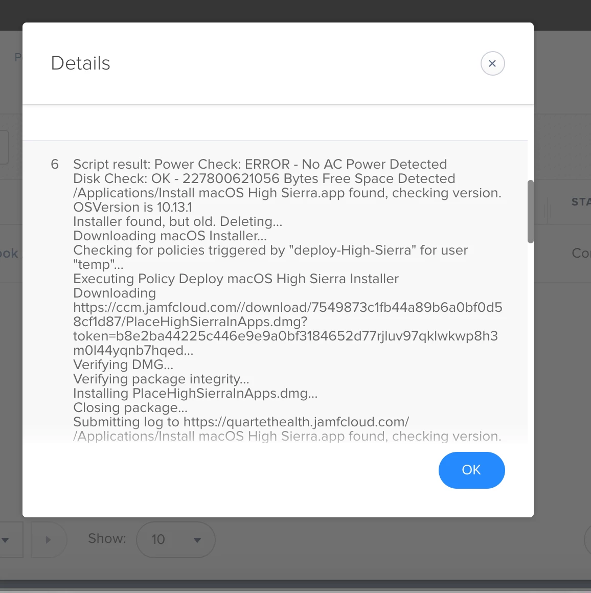

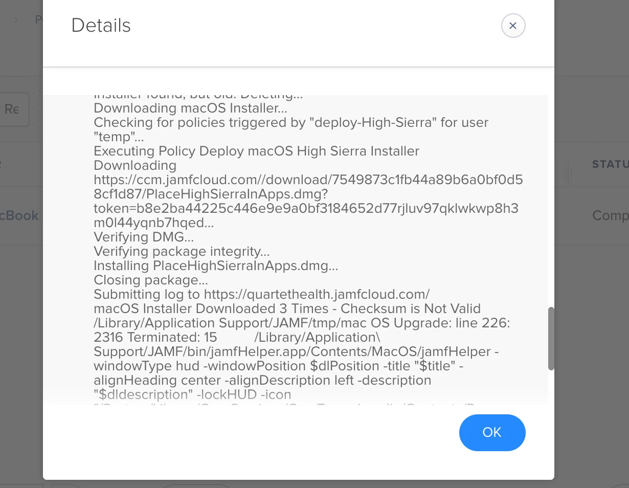

I checked the log and it looks like its looping. It finds my high sierra package, calls it old, then deletes it.
Ok guys I've figured it out. I put the wrong os version for the parameter. Also, I was using the high sierra deployment package on my own. I didn't know that the script reaches for it and uses it.
