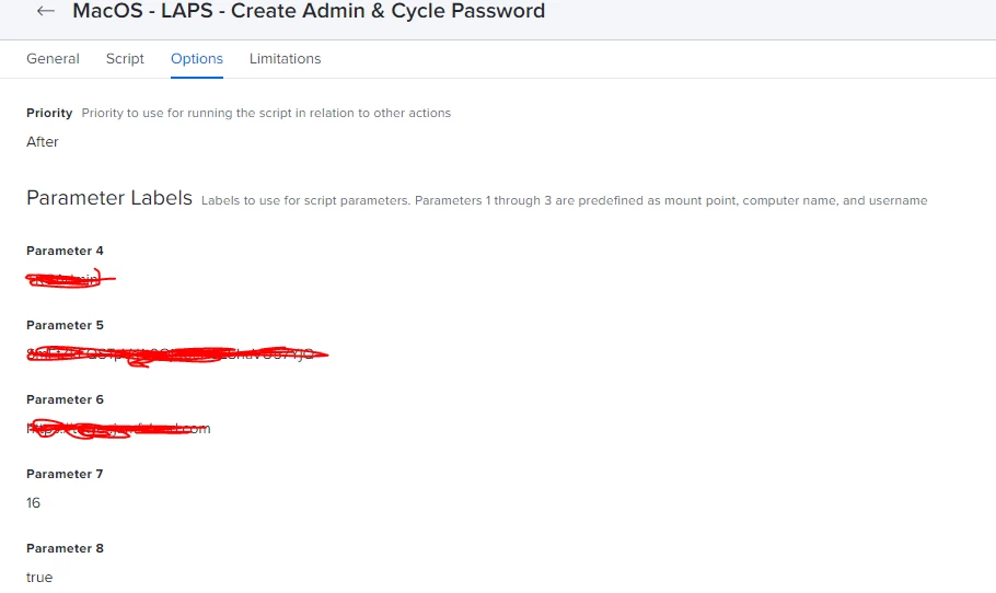

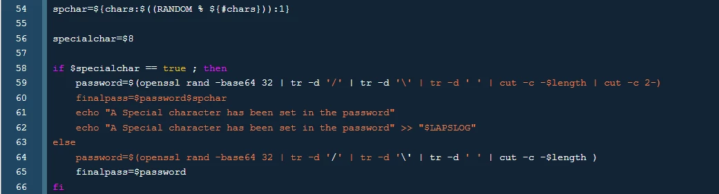

I like you article but your script LAPS Create Cycel Password is failing with the error message unknow command. Can you help me with this
perryd84
  • Feb 17, 2023 7:04 AM UTC
Hi @Evinrude
Do you have a log from jamf or the local Lapslog? If you can share this I can take a look.
  • Feb 17, 2023 7:43 AM UTC
Hi @Evinrude

We are running this script from the Jamf Only. We haven't made any modification in the script apart from removing the slack notification part from the script.
Its fails in line 58 which is
if $specialchar == true ; then
password=$(openssl rand -base64 32 | tr -d '/' | tr -d '\\' | tr -d ' ' | cut -c -$length | cut -c 2-)
Ah ok that's line 68 in the current version.
Are you entering a true or false flag in parameter 8 in the script policy? If the variable is left blank then the if statement will have nothing to compare so that could be why it's trying to run == as a command.
  • Feb 17, 2023 9:08 AM UTC
Yes, i am entering a true flag in parameter 8 in the script policy. Its weird why is failing
It's really odd. It's not pulling in any of the parameters set in jamf or something is stripping the variables.
You can see all the parameter options are blank.
"Password length is set to (blank) characters"
"(blank) does not exist"
Then the if statement is failing as parameter 8 is coming through as blank.
You can also see the plist creation part is failing as there is no user being populated into the file path.
Really odd issue can't say I've seen this before. I would test another script to see if variables set in the jamf policy are being striped out as well.
