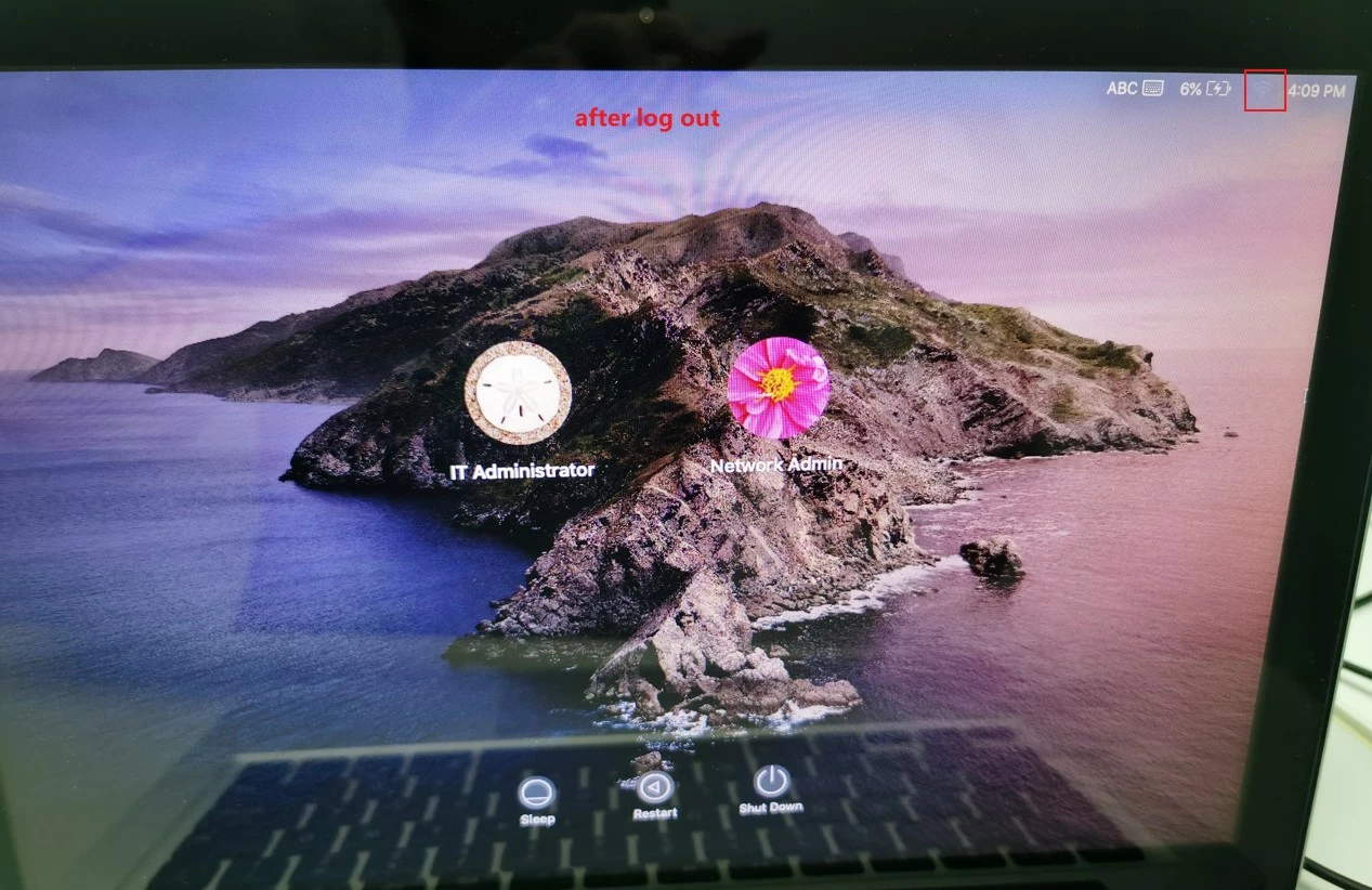

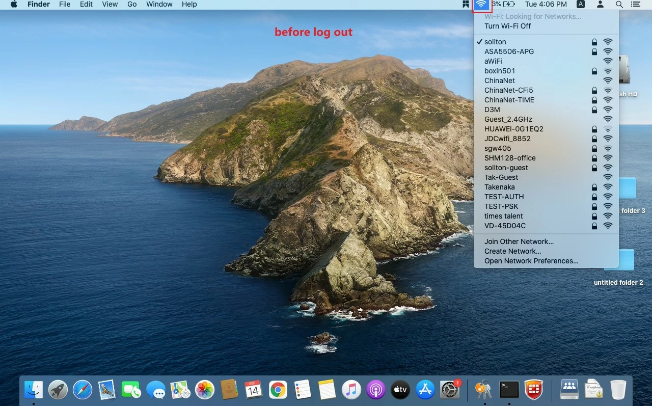

After installing the network certificate , the Mac computers can connect to company Wi-Fi and join domain, but can't login with domain account.
The network will be disconnected if i log out , but it'll be connected if i login again .

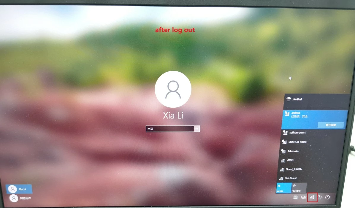

The network works fine on Windows computers.
May i ask is there a way to keep the network connected in Mac OS login window ?

The MacBooks haven't joined domain previously , we are going to do some test under domain evironment first. Currently the MacBook can join domain , but after i log out the local account , the network will be disconnected under login window,so i can't login with a domain account.

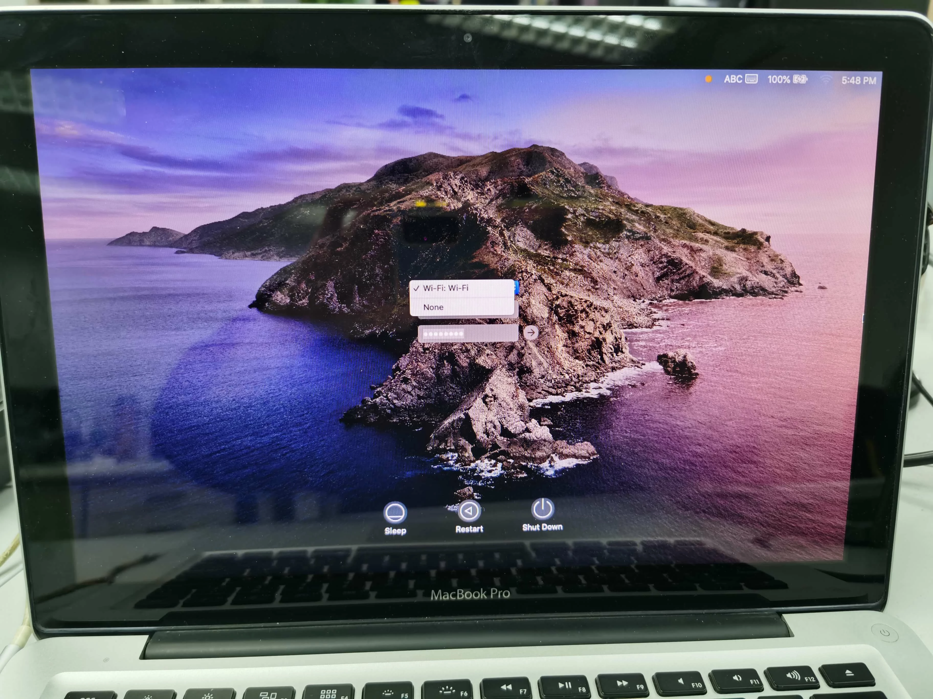

I've installed the profile .
I'm going to authenticate the wi-fi at login screen , but i can't find the correct SSID in the pull-down menu..
