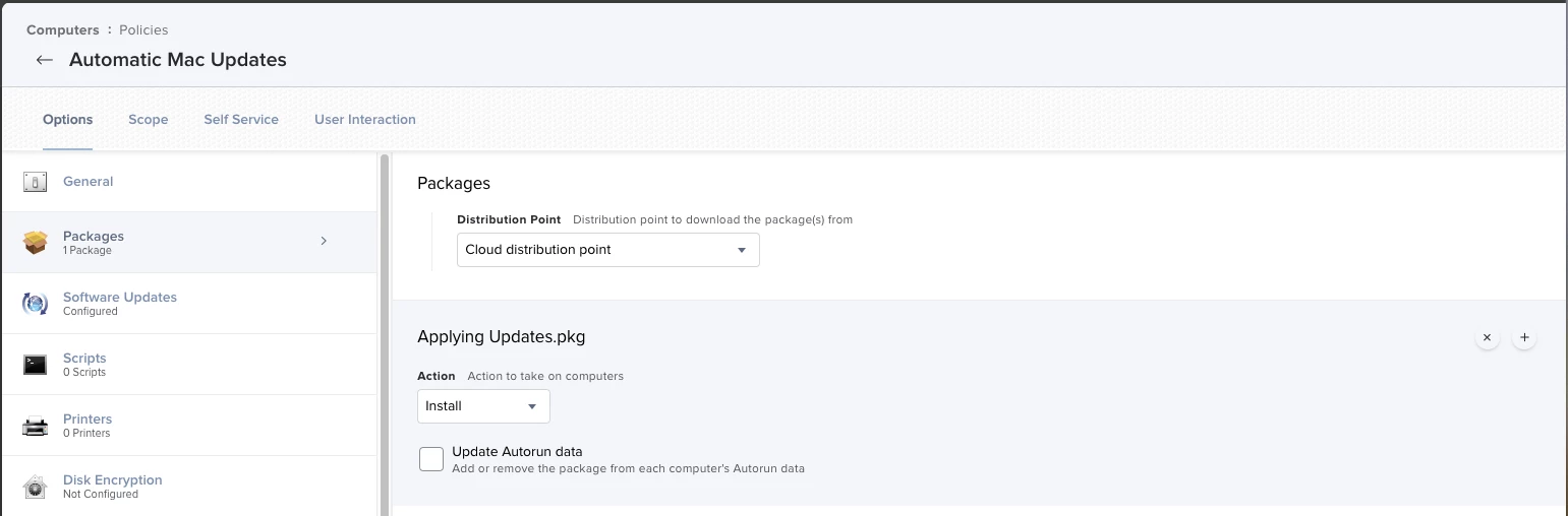

To bring the scripts into JAMF, I use composer to create a package with places the scripts into, "/private/tmp/Updates."  The package is uploaded into JAMF.  I don't really care about cleaning up the source folder after the fact since rebooting clears it automatically.

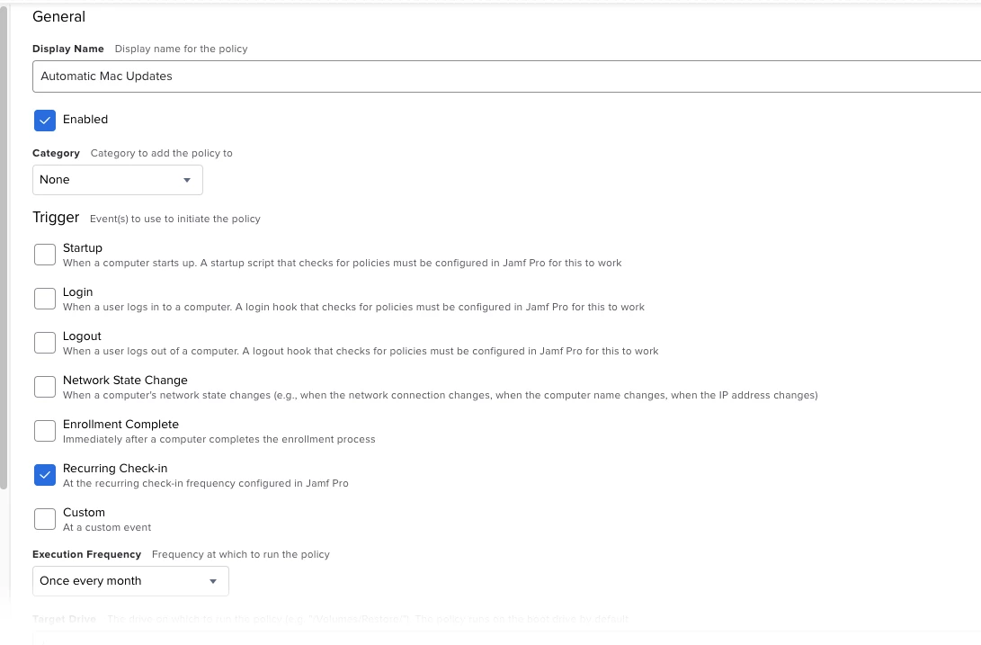

I create a JAMF policy and call it, "Automatic Mac Updates."  The policy has 4 configuration items.
Packages which contains the package that I just build for composer.

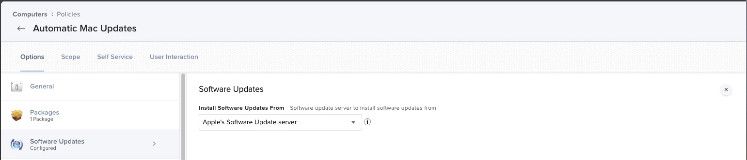

Software Updates is set to check from Apple's Software Update server.  (Current updates are blocked while I vet this process.)

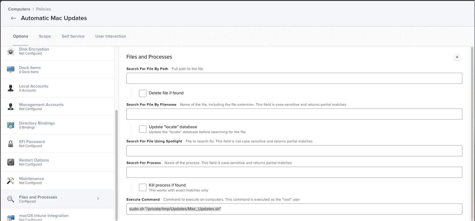

Then I add a command in Files and Processes to call the script, "sudo sh "/private/tmp/Updates/Mac_Updates.sh."
Under the general configuration, I set the policy to enable and set to recurring check-in, but set the Execution Frequency for once a month to avoid multiple software update triggers. The goal is to keep this consistent with our Windows patching.

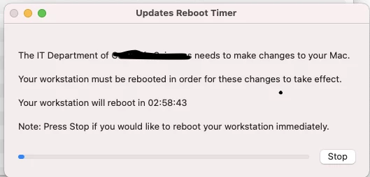

Once the policy is configure, I set up my test scope collection, and the users are greeted with this message if an update need to be applied.

This script is the Applescript reboot toast notification.
-- Progress Bar - Reboot Timer try progress_timer("03:00:00", "Reboot Timer") -- call the progress timer with an HMS time and timer label on error error_message number error_number if error_number is equal to -128 then do shell script "sudo softwareupdate -i -a -R" end if end try do shell script "sudo softwareupdate -i -a -R" return result ------------------------------------------ -- subroutines in alphabetical order -- ------------------------------------------ -- getTimeConversion converts a time in HMS format (hh:mm:ss) to a time in seconds on getTimeConversion(HMS_Time) set HMSlist to the words of HMS_Time -- get {hh, mm, ss} from HMS time (p. 158 Rosenthal) set theHours to item 1 of HMSlist set theMinutes to item 2 of HMSlist set theSeconds to item 3 of HMSlist return round (theHours * (60 ^ 2) + theMinutes * 60 + theSeconds) end getTimeConversion -- progress_timer displays the elapsed time in a progress bar. For information on progress bars see: https://developer.apple.com/library/archive/documentation/LanguagesUtilities/Conceptual/MacAutomationScriptingGuide/DisplayProgress.html on progress_timer(HMS_Time, timerLabel) set theTimeSec to getTimeConversion(HMS_Time) -- convert the HMS format to seconds set progress total steps to theTimeSec set progress completed steps to 0 set startTime to (current date) repeat with i from 0 to theTimeSec -- begin at i = 0 to start the timer at 00:00:00 set HMS_SoFar to TimetoText(i) -- convert the seconds so far to HMS format for display set HMS_ToGo to TimetoText(theTimeSec - i) -- convert the seconds to go to HMS format for display set progress completed steps to 0 set progress description to " Your IT Department needs to make changes to your Mac. Your workstation must be rebooted in order for these changes to take effect. Your workstation will reboot in " & HMS_ToGo & " Note: Press Stop if you would like to reboot your workstation immediately." set progress additional description to ¬ "" --"Time Elapsed: " & HMS_SoFar & return & ¬ --"Counting Down: " & HMS_ToGo set progress completed steps to i set elapsedTime to (current date) - startTime -- get actual elapsed time for adjusting delay set lagAdjust to elapsedTime - i -- compute lag adjustment delay 1 - lagAdjust -- delay 1 second minus any cumulative lag that needs removing end repeat --set HMS_Elapsed to TimetoText(elapsedTime) -- convert elapsedTime back to HMS format for display set dialogText to null --set dialogText to "Elapsed Time: " & return & ¬ -- "Nominal = " & HMS_Time & return & ¬ -- "Actual = " & HMS_Elapsed tell me to activate --display dialog dialogText with title timerLabel & " Timer" return dialogText end progress_timer -- TimetoText converts a time in seconds to a time in HMS format (hh:mm:ss) on TimetoText(theTime) -- parameters - TheTime [integer]: the time in seconds -- returns [text]: the time in the format hh:mm:ss -- Nigel Garvey points out this script is only valid for parameter values up to 86399 seconds (23:59:59) and offers a solution for longer times here: https://macscripter.net/viewtopic.php?pid=134656#p134656 if (class of theTime) as text is "integer" then set TimeString to 1000000 + 10000 * (theTime mod days div hours) -- hours set TimeString to TimeString + 100 * (theTime mod hours div minutes) -- minutes set TimeString to (TimeString + (theTime mod minutes)) as text -- seconds tell TimeString to set theTime to (text -6 thru -5) & ":" & (text -4 thru -3) & ":" & (text -2 thru -1) end if return theTime end TimetoText

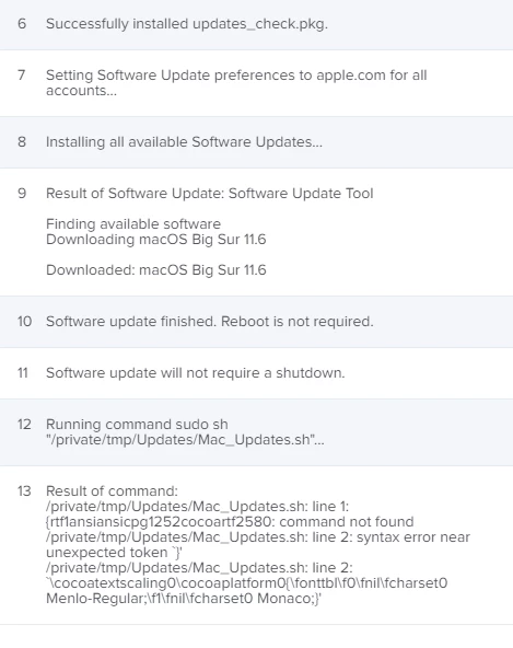

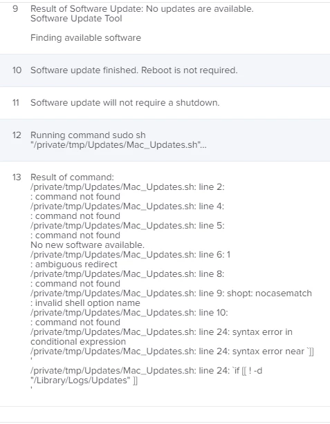

Hello,
I am setting up a update policy using your script but when it triggers a error shows up. Any insight on what the issue might be?
Result of command:
/private/tmp/Updates/Mac_Updates.sh: line 1: {rtf1ansiansicpg1252cocoartf2580: command not found /private/tmp/Updates/Mac_Updates.sh: line 2: syntax error near unexpected token `}' /private/tmp/Updates/Mac_Updates.sh: line 2: `\\cocoatextscaling0\\cocoaplatform0{\\fonttbl\\f0\\fnil\\fcharset0 Menlo-Regular;\\f1\\fnil\\fcharset0 Monaco;}'
After realizing the text editor was part of the issue i got:
update:
After messing with these scripts for awhile it seems it was notepad++ causing issues and they worked fine when doing them directly in the Apple editors
