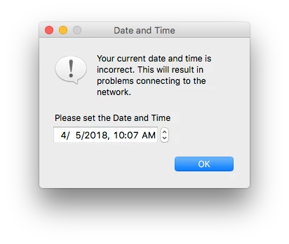

I updated your script using pashua dialog. This way users can't really muck up the date and time format.

@boberito i love it and am eager to test! In short I only want it to fire off in extreme situations but what was kicking my butt was the user input error checking...this solves that problem perfectly. I’m marking as solution pending testing, but I love seeing how people can make it better.

@Stubakka I just tried @boberito's script with Pashua and it works in Catalina. I manually set my system clock to 3 years in the past, then ran it in Terminal (and commented out the shutdown line), but it does appear to work. I do like how this gives users the ability to fix their own clock when they aren't admins.

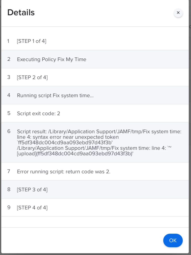

@boberito When I try to run your version via Self service , get this error, Both on a 10.14.6 and 10.15.5 system , any ideas?
boberito
Forum|alt.badge.img+22
  • June 18, 2020
@Stubakka remove line 4.

The jamf board somehow added it. I'm not sure why or whatever but that's the way you link to an image or something you've attached. I edited the post with the script and removed it.
