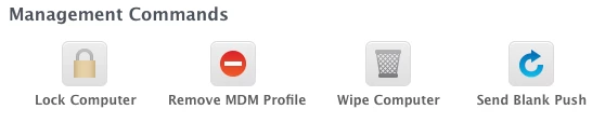

When you say the "efi is disabled" what are you referring to?
It sounds like it could be a management command pushed from the JSS.
If that's the case, you should be able to boot into the recovery partition and enter the code that was used to lock the machine.
