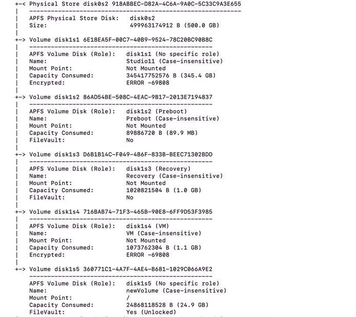

Running "diskutil apfs list" reveals an error for the boot volume (disk1s1) and VM volume (disk1s4).
So maybe the security update corrupted the volume information.
