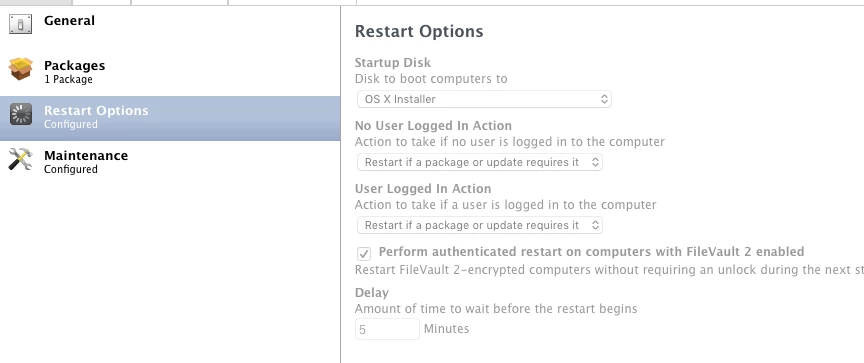

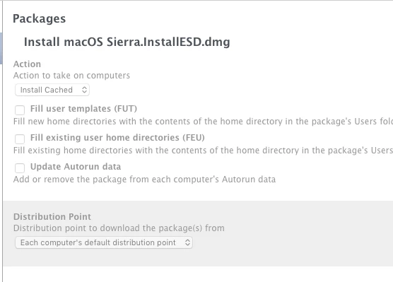

Normally, I would create an in-place upgrade policy that would install the cached installer package (that i cached with a previous policy) and then reboot to the installer with a restart option (see attached fig 1 and fig 2).
If I choose to use the script provided here, along with created a dmg of the installer and placing it in Users/Shared, do i still handle the overall policy the same with the added script? 1. Do i run the script as an "after" script or a "at reboot" script?
2. Do i set the policy restart options still to specify the start up disk as "OS X Installer"?
Thanks!
