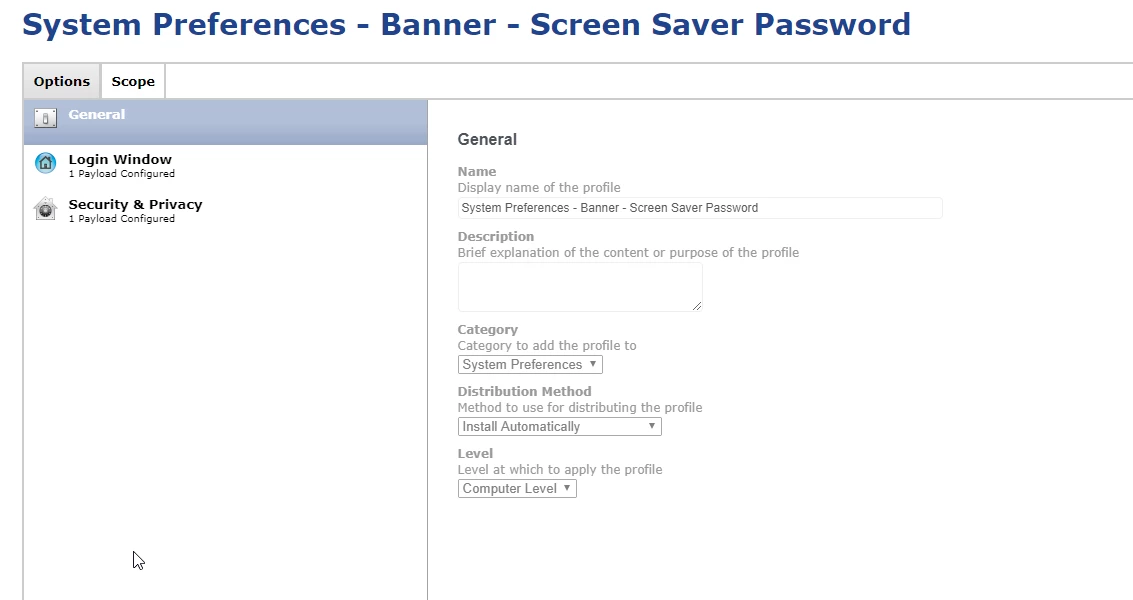

Hey there! Lately, we have noticed that our macs are not consistently using a login window screensaver after 15 minutes, as set by a config profile in JSS.
We have also noticed that sometimes if a mac is freshly restarted, then it will get a screensaver at the login screen. However, this is inconsistent. Also, more times than not, if a user logs into the computer, and logs off after they're done with the computer, if the computer is sitting at the login screen, then a screensaver will not open.
We've created an additional config profile specifically targeted to a test machine -- with everything else the same as all of our other computers, and sometimes that will work, sometimes not.
Is there something wrong with our config profile that doesn't allow a screensaver at login?
Something else to note, the login window screensaver -- when it does work -- is arabesque.saver, and when a user is logged in, it's flurry.saver, I don't know if this is set somewhere else, but I think it's independent of the login one. The timing, however, seems to be the same at login screen vs logged in.

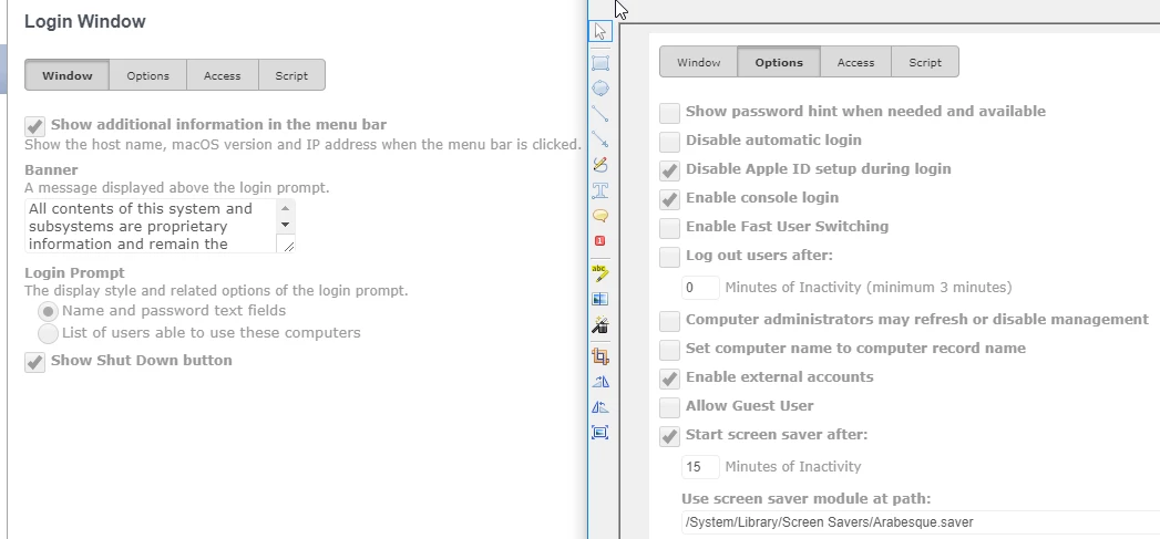

Attached is an image of the login window config profile settings. The settings in the "access" and "script" tabs are their default.

do different test, on combining the payload "Login Window" and "Security & Privacy" if that doesn't work do a separate configuration profile for each payload.
in our enviroment at the end it worked by combining the two payloads.

another question: what settings do you have under General>Distribution Method and Level?
  • November 9, 2017
We have 4 macs that we are testing on. If we are messing around with the config policies, then it usually behaves. However, we noticed that this morning, all four of them were just sitting on the login screen without a screensaver, even though they were screensavering fine yesterday during testing.
Looking around JAMF Nation, some people suggest to separate the two, others say to keep them combined. We had them combined, then we separated them, now we will recombine them.
The Distribution Method is set to Install Automatically, and the level is at Computer Level.
