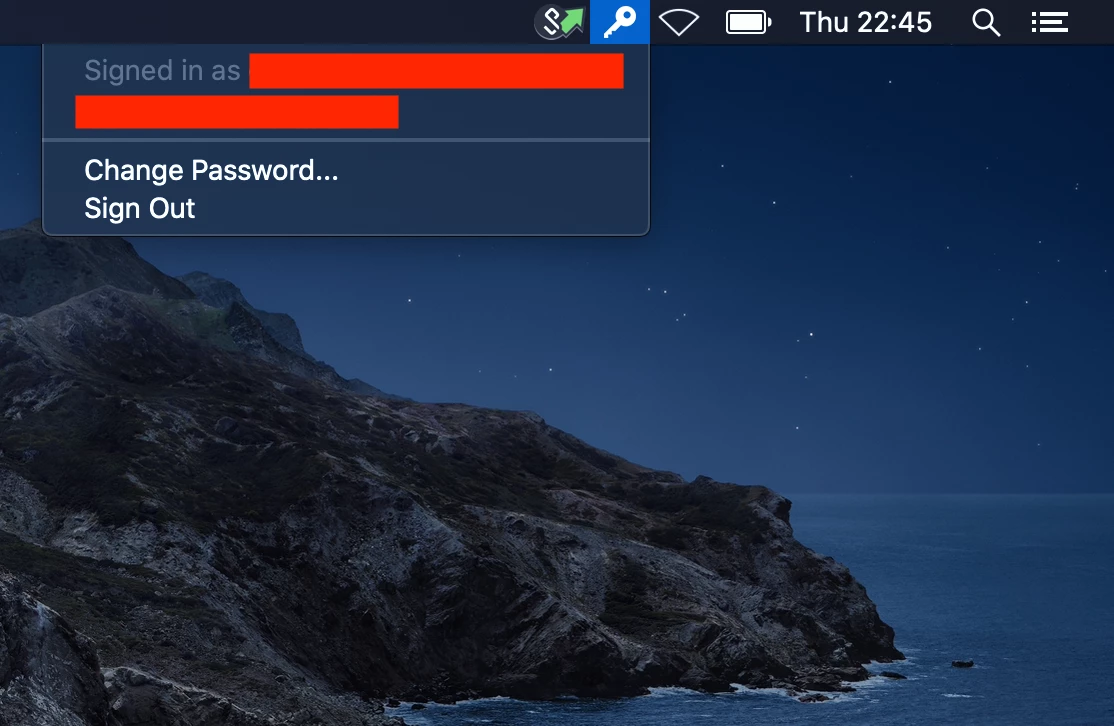

I have experience with NoMAD specifically, which is still free to use, as long as you feel you don't need their support plan. It works well to keep local accounts and their respective AD passwords in sync. There is a little "know-how" in terms of setting it up, with the correct Config Profile deployed and so on. I would take a look at the page for it here: https://nomad.menu/products/#nomad

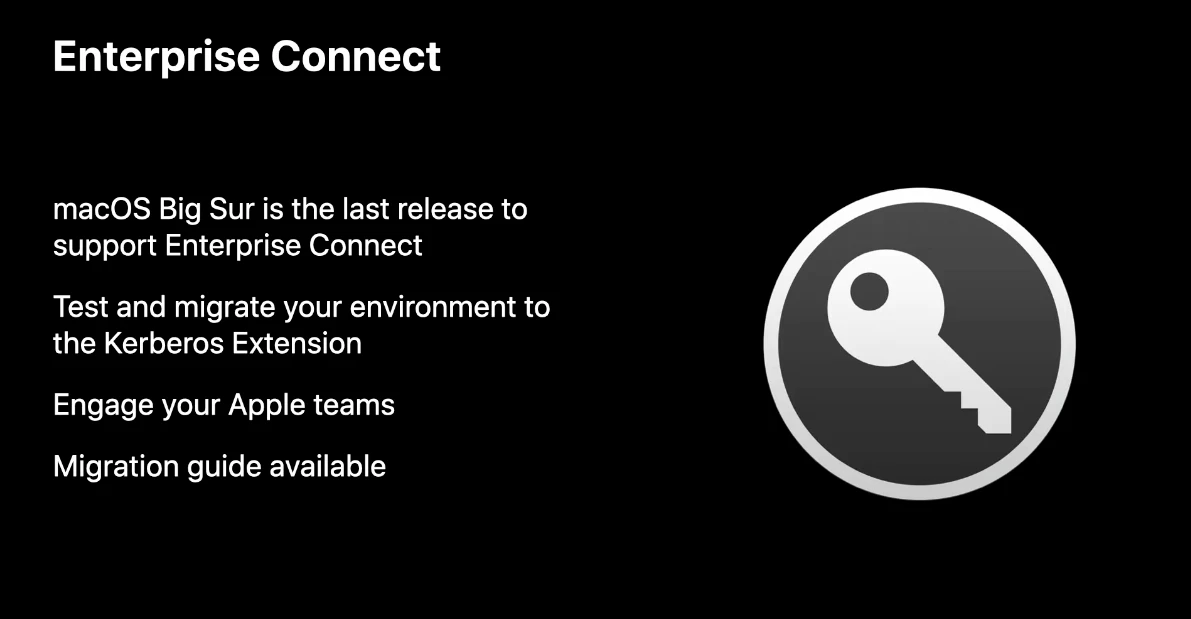

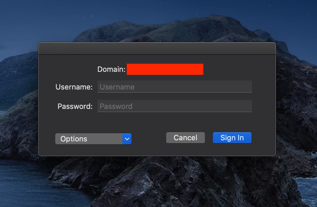

I've just been testing Apple's Single Sign-on Kerberos extension yesterday which is now built into 10.15
You can find instructions for setting it up here:
Apple Kerberos SSO PDF
It replaces enterprise connect and is free/built into the OS
You just need to set up a configuration profile in Jamf & deploy it to a machine for testing.

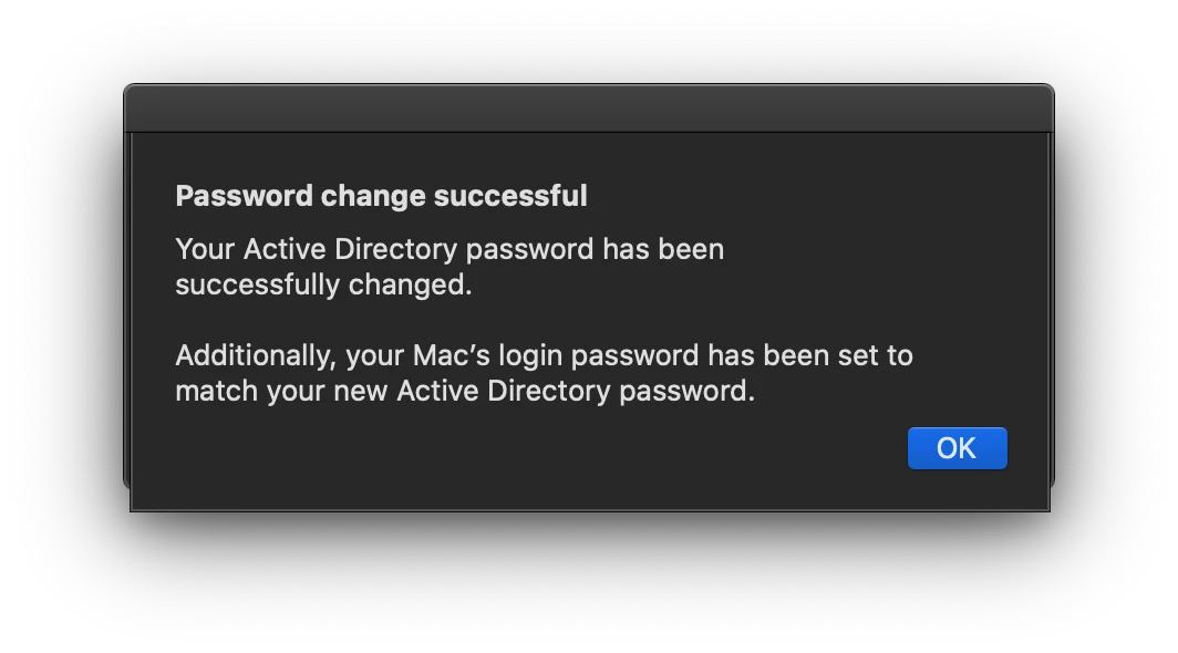

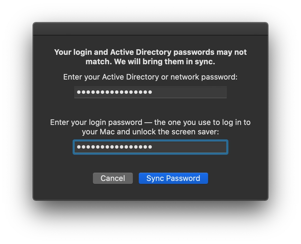

It keeps the AD account and local account passwords in sync with the AD password being the master.
The whole point is that the user changes the password themselves. IT doesn't do it. If they have VPN access into your network, they can change their AD password from their desktop using this extension. It grants them a kerberos ticket. The machine doesn't have to be bound to AD any more.

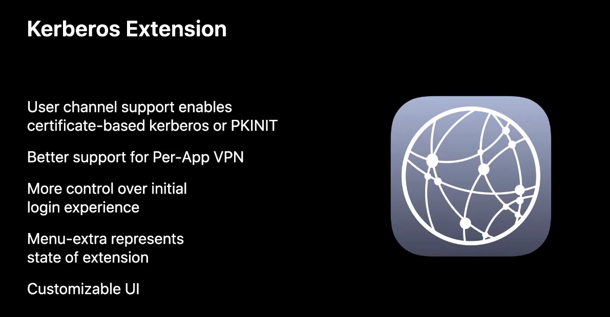

There's a WWDC 2020 video on it here:
WWDC 2020 Video
Using Apple's Kerberos extension:
Allows Mac to get a Kerberos ticket-granting-ticket (TGT).
Grants access to directory resources, like servers and printers.

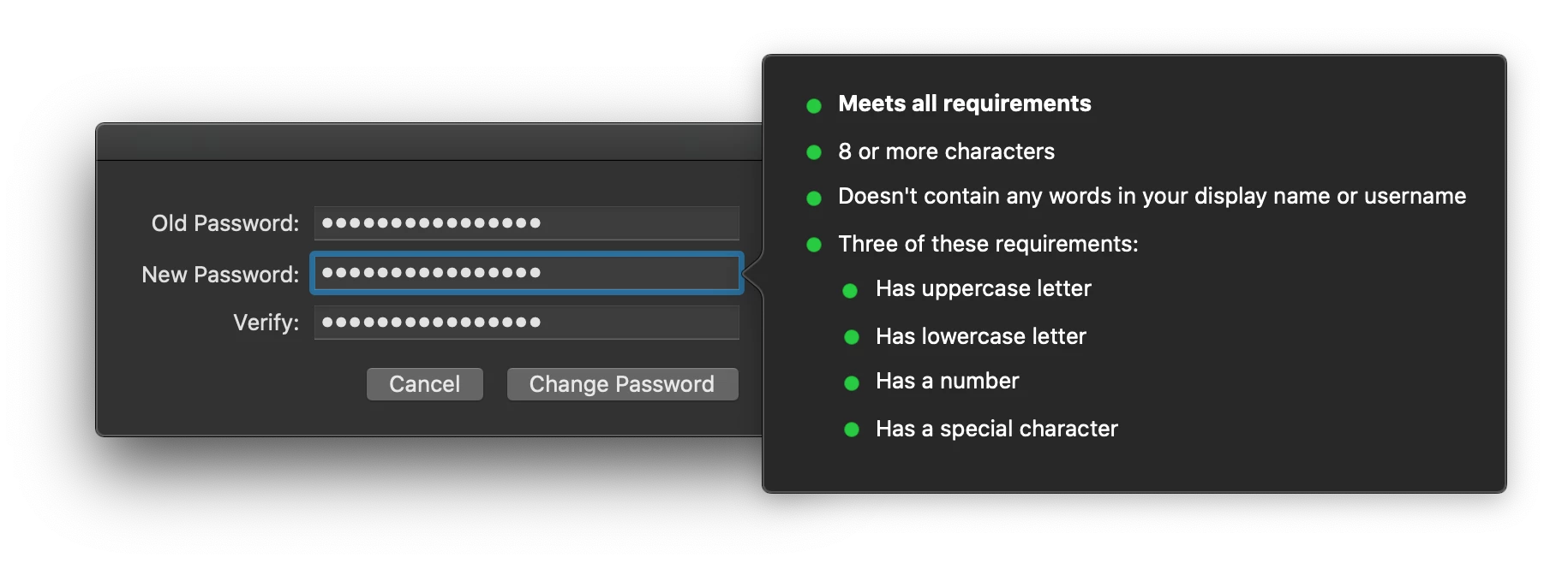

Keep local accounts' passwords synced with counterpart account in directory service and comply with organizations' password complexity rules.

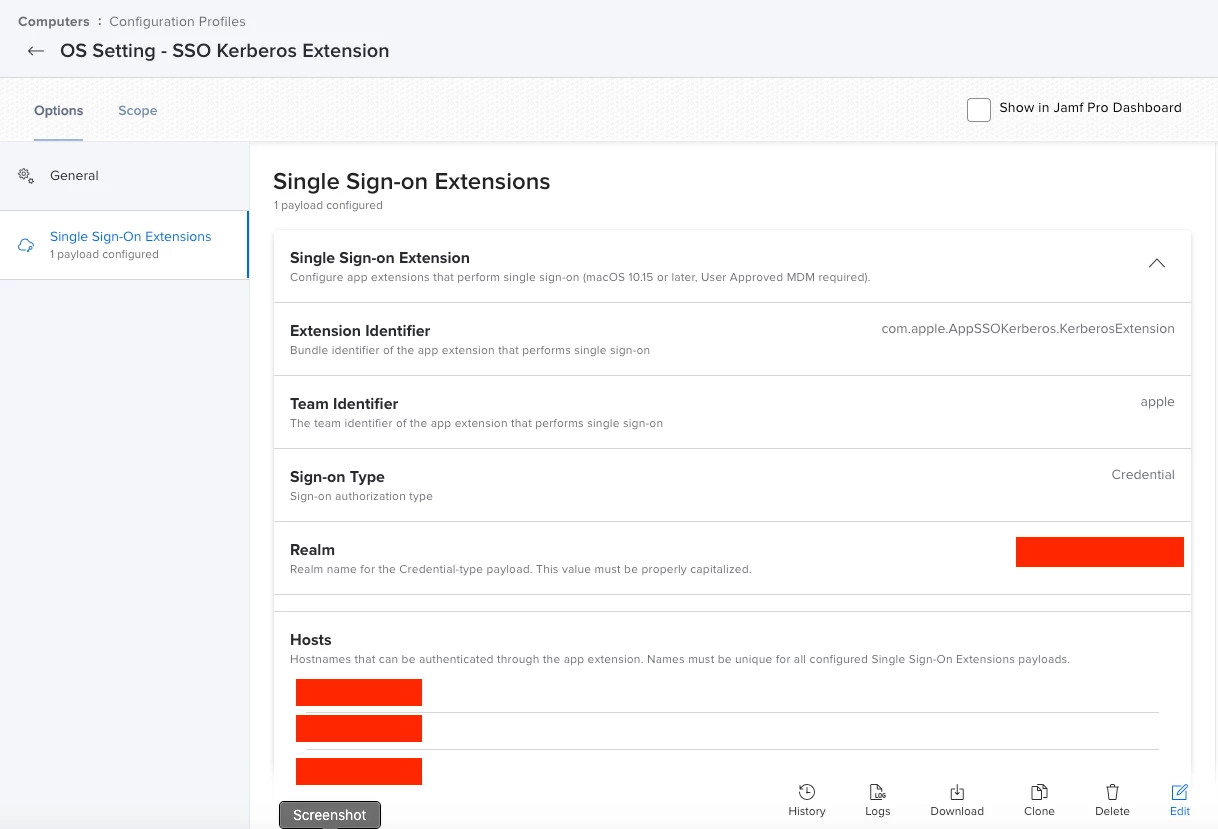

You'll need the below plist code options to import into the Configuration Profile in Jamf.
It's at the bottom where it says drag a file here or browse for file.
<plist version="1.0">
<dict>
    <key>pwNotificationDays</key><integer>15</integer>
    <key>requireUserPresence</key><false/>
    <key>allowAutomaticLogin</key><true/>
    <key>syncLocalPassword</key><true/>
    <key>useSiteAutoDiscovery</key><true/>
    <key>isDefaultRealm</key><false/>
    <key>pwReqComplexity</key><true/>
</dict>
</plist>
I don't know what will happen if you change the AD password while the user is offline. I have not tested that.

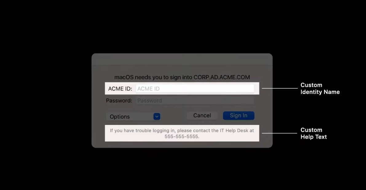

Big Sur 11.0 will allow you to customize the sign in window that pops up. Currently you can't in 10.15
I forgot to say - the missing piece of the puzzle regarding local account creation.

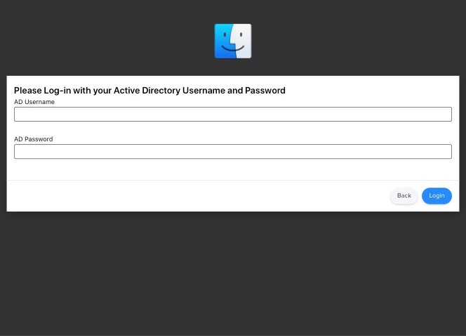

If you have an LDAP server integrated with your Jamf server either directly or via a JIM instance, when your devices are going through Automated Device Enrollment in a 1 to 1 deployment, you can create a customized enrollment payne that requests the user authenticate with their LDAP credentials. This will pull their AD account info into the Jamf machine record and also prepopulate the local user account Full Name and Username with their AD details. You can lock these details (in the prestage enrollment, account creation section) to stop them from being changed by the user. Advise the user to use their AD password as their local user account password during setup. Even if they dont comply and use a different password, SSO Kerberos extension will sync the two to match their AD password once they get logged in to the local account and sign in to AD using the extension.
It will look something like this during ADE. All aspects of the window are customizable including the image at the top.

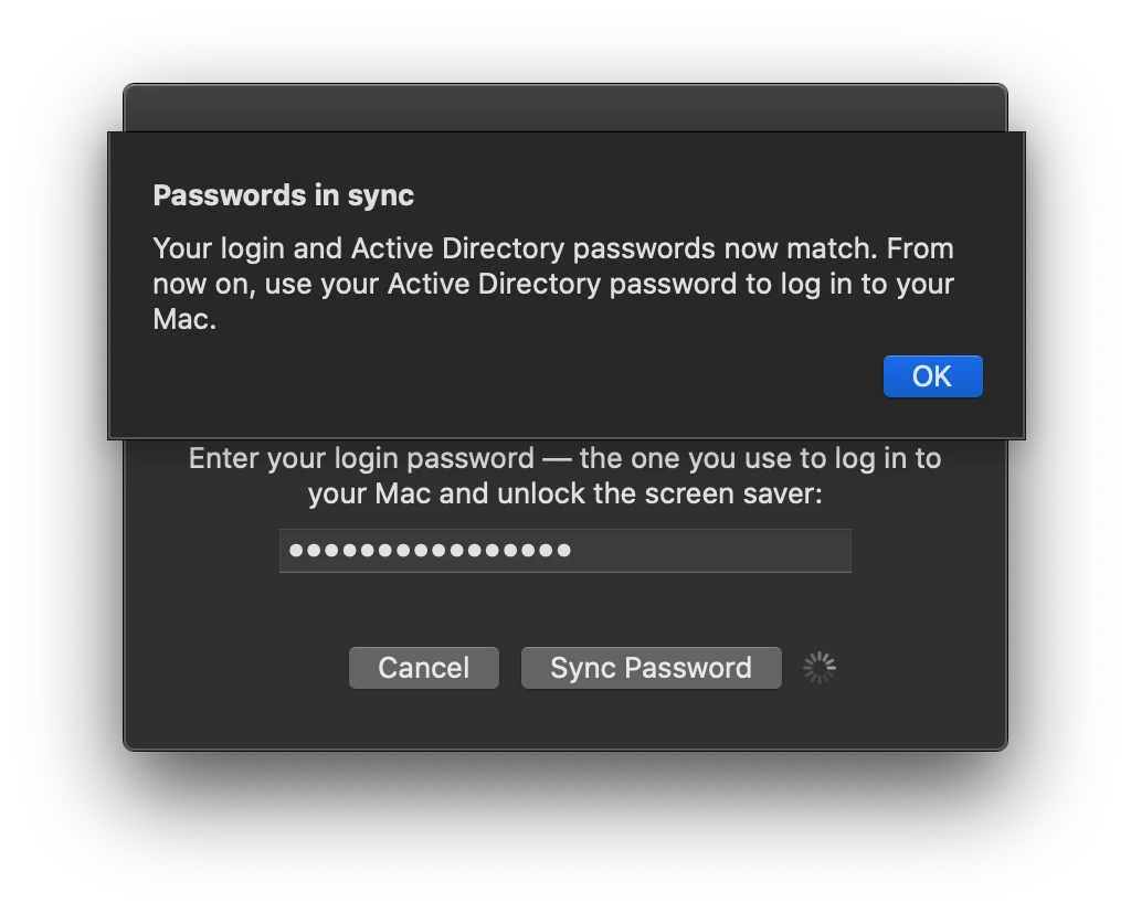

It is also critical to escrow FileVault recovery keys for this workflow.
If a user cannot log into their local account or unlock FileVault provide them with the escrowed FileVault recovery key.
They can then reset their local account password and log into the Mac. Then sign into Kerberos SSO with their AD credentials. This may have already been reset by the help desk.
At that point Kerberos SSO will resync the local password to the AD password.
