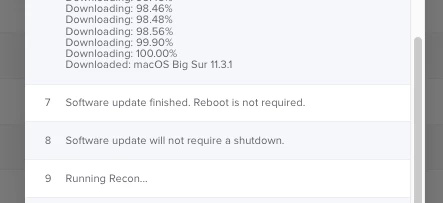

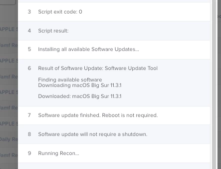

I'm seeing this also with the 11.3.1 update.
I restarted the laptop and nothing installed.
I ran 'recon' and the software update was saying it's still available so i logged back out again and the policy quickly ran without a reboot and the log for the second time around said no updates available. Here are 2 images of each 'details' from the policy.
but recon still shows the 11.3.1 update is available for the computer.

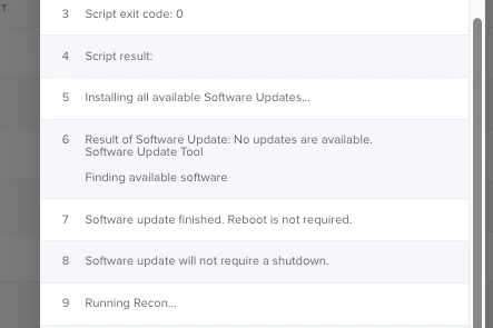

  • May 5, 2021
something strange going on with this 11.3.1 update being run through policy. Now the 3rd and 4th time through im seeing this (see image), but laptop still says its running 11.3.0 and software updates says 0. When i run recon it then again shows 11.3.1 update available.
Gonna exclude Big Sur computers from my software update policy and have users run it manually.
