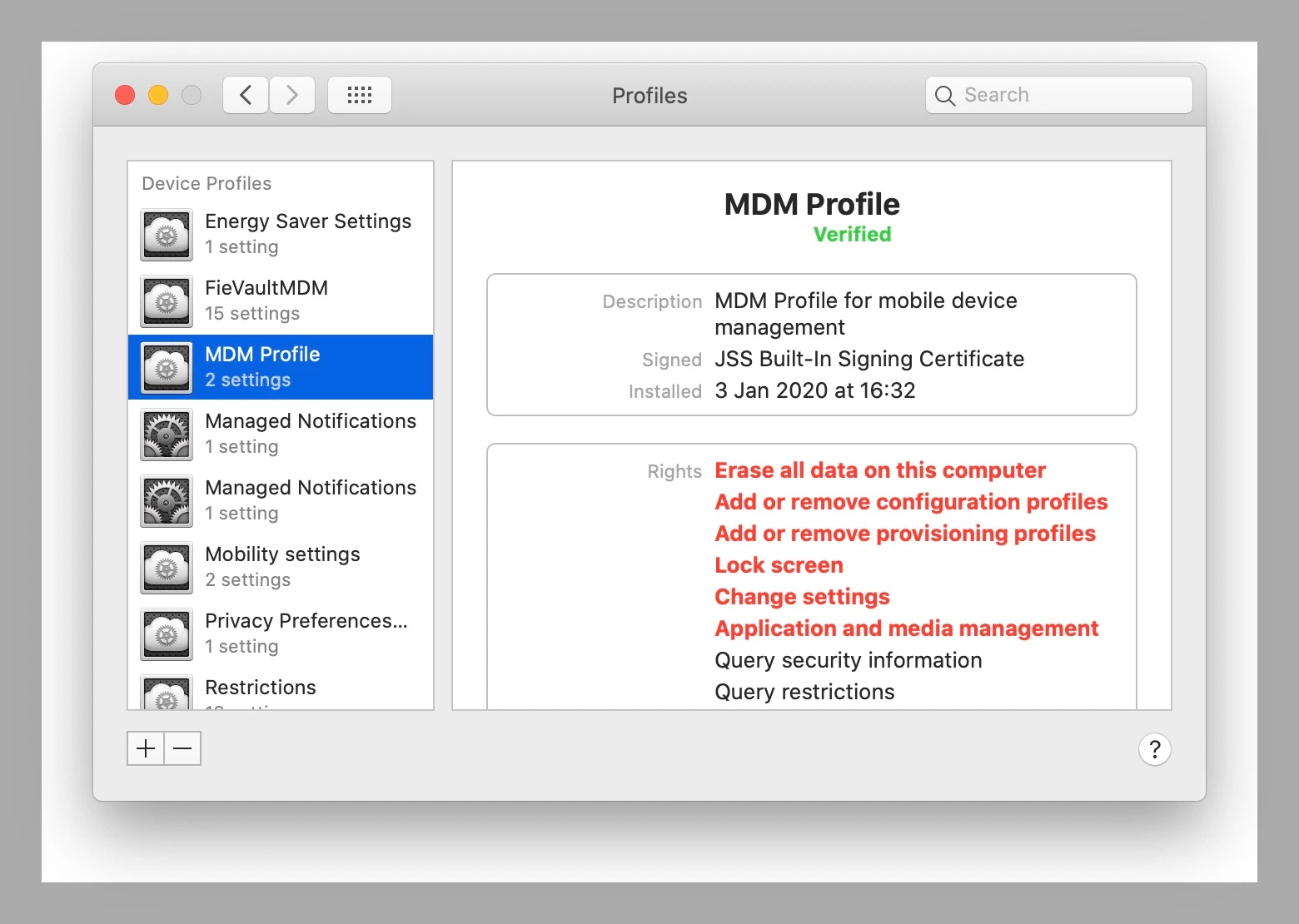

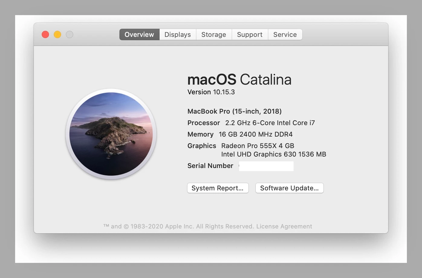

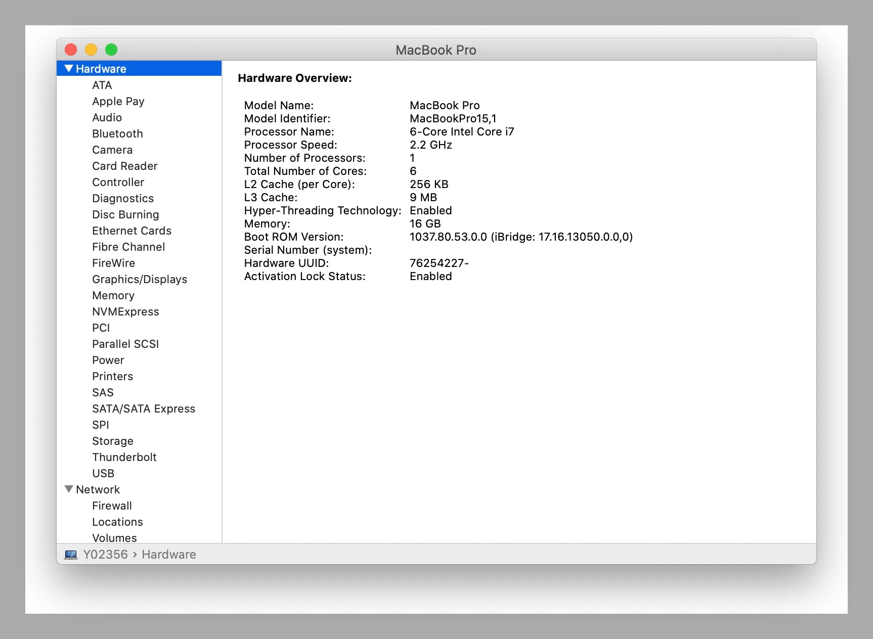

@jtrant Unless I am misinterpreting things your Jamf CSM is wrong. See the following screen captures. These are taken on a MacBook Pro 15-inch 2018 model which therefore has a T2 chip. As per the screen captures it is running Catalina 10.15.3 and is logged in to iCloud and is managed by Jamf. Again according to the screen captures it does have Activation Lock enabled.
Jamf binary information is -
% jamf -version
version=10.17.0-t1572881164
The following command also queries the status of Activation lock and returns it in Terminal.
% /usr/sbin/system_profiler SPHardwareDataType | awk '/Activation Lock Status/{print $NF}'
Enabled

@lockwojo , I will point out that it does not appear that your Mac in the screenshots is supervised which may be what changes whether activation lock enables or not.
  • February 6, 2020
@lockwojo What enrollment process did you use? Not DEP/automated enrollment, since not supervised in your screenshots.

Following up on this, it does appear that Activation Lock is enabled upon iCloud sign in, regardless of supervision status on T2 Macs. In my case, the System Report showed 'Disabled' but running the script above showed 'Enabled'. I booted the Mac to recovery mode and tried to wipe the drive and was then prompted for a password.
My initial response is to disable the setting using a plist file (com.apple.icloud.managed.plist) and setting "DisableFMMiCloudSetting" to "YES". This would only prevent clients from activating the feature and would not disable it on clients that have already done so.
I've followed up with my Jamf CSM.
  • February 14, 2020
@jtran That is curious, I have so far used the System report status. Strange the script shows enabled. The fact that you are asked to enter a password when booting to recovery is expected behaviour, because there is a configured local user.

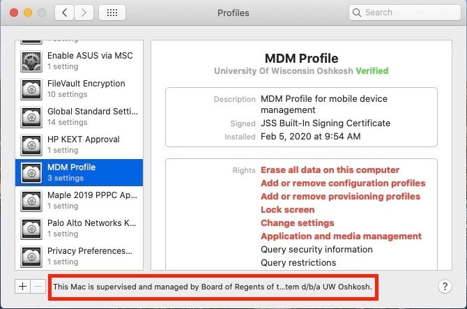

@nelsoni I see above you have highlighted a piece of the MDM profile showing the profile is being managed, next to +/- buttons. Is there some special way you are making this appear? I don't see it myself in my MDM profile but would prefer to have that language appear to inform users.
  • February 17, 2020
mconners, This text appears when the device is DEP enrolled and supervised by Jamf.
Forum|alt.badge.img+20
  • February 17, 2020
That's interesting @nelsoni as we do both, supervised by Jamf and DEP enrolled, for a few years actually. I wonder how we can get that to display? I will reach out to Jamf support, I bet it is a simple checkbox that I am missing.
  • February 18, 2020
I should clarify that it only shows up on Catalina machines.
