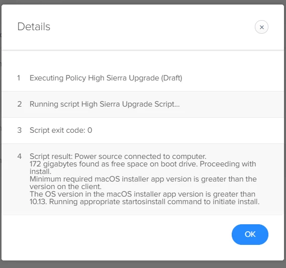

  • May 15, 2018 4:05 PM UTC
Hello,
I have a bit of an odd issue. It looks like the script runs and prompts for the authenticated restart credentials, but after that, it does not run the installer. Logs don't show any exit codes or errors.
Not sure where to start to troubleshoot. Help would be greatly appreciated!
Thanks,
Jose

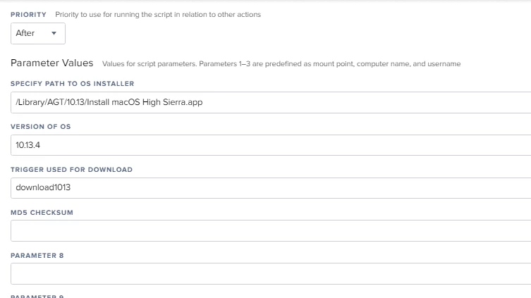

  • May 15, 2018 7:09 PM UTC
@BreakingZeus What do you have variable/paramter #5 (OS version) set to in your script within your install policy?
  • May 23, 2018 3:10 PM UTC
Apologies for the late response. I have that parameter currently set to macOS High Sierra. I wasn't sure if this was just a version number of the name of the OS.
  • May 23, 2018 5:29 PM UTC
@BreakingZeus You want to set it to the version number
See my example

  • Jun 8, 2018 6:38 PM UTC
I'm using the macOSupgrade script with 10.13.4 but it just puts my test Mac into a download loop. It will download the High Sierra installer to the Applications folder. Then the installer is deleted and downloaded again and again. Any ideas?
Also my High Sierra install is packaged as a DMG to go to the Applications folder. Maybe it needs to be an install package?
Rosko
  • Employee
  • Jun 8, 2018 7:09 PM UTC
@spraguga does the target version in the script parameter match the version you have packaged in the DMG?
  • Jun 8, 2018 9:11 PM UTC
@Rosko No, I'd didn't even realize I actually downloaded 10.13.5. I was putting in 10.13.4. Well I know that part works. All set now! Thanks!

  • Aug 1, 2018 3:15 PM UTC
Hello,
We're trying to use @Rosko 's script to do in place upgrades. But I'm a little confused as to what I should insert for parameter 6. TBH, I'm not too sure on how to use custom triggers just yet. Any help would be great! Thanks!
  • Aug 1, 2018 3:17 PM UTC
Trigger 6 should be the policy trigger for the policy you setup to download and install the pkg that installs the "Install macOS High Sierra.app " onto the system to be used/called
  • Aug 1, 2018 3:30 PM UTC
@lstrm When you create the new download policy this should install to here:
/Applications/Install macOS High Sierra.app
For the Trigger, check "Custom" and enter a "Custom Event". You should enter something that makes sense to what the policy actually is like DLHIGHSIERRA. I always use caps for my custom event triggers but you don't have to.
A policy with a Custom only trigger can only be executed by the Custom Event. For example, from the command line on a user's Mac like this:
jamf policy -event DLHIGHSIERRA
Whatever you put in the Custom Event field is what you should put in parameter #6. For my example above you would put DLHIGHSIERRA
