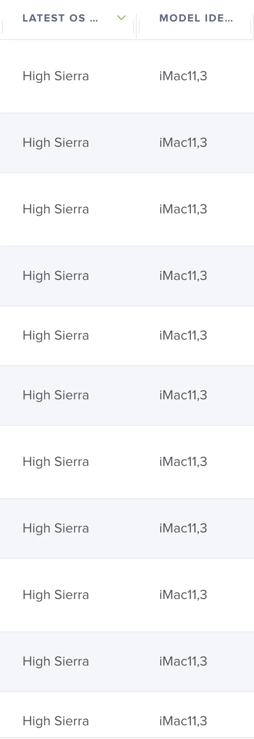

  • Sep 11, 2020 10:20 AM UTC
based on the script in this thread I made this for big sur model checking. I think the list is correct so check before you use it.
Easy enough to adapt for other OS versions.
