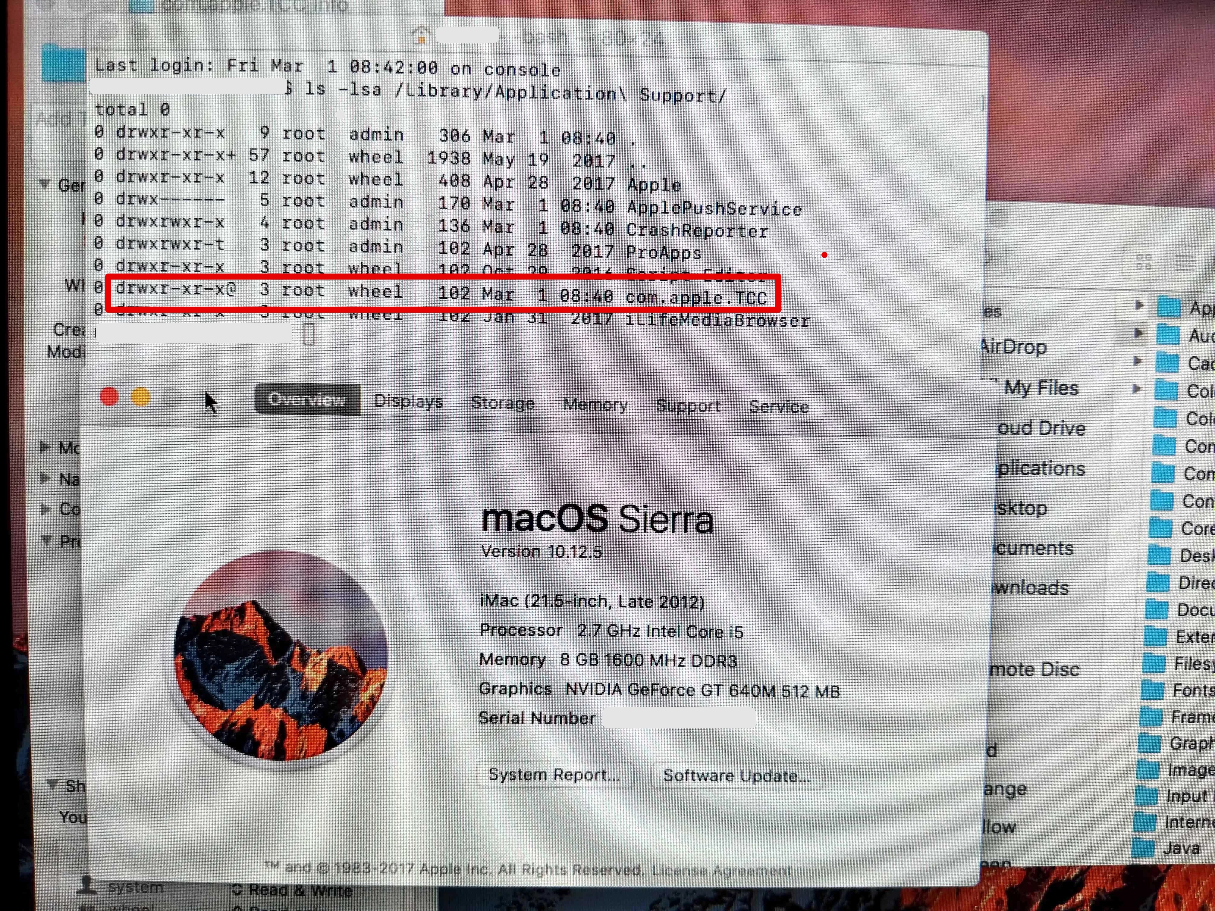

End-user approvals and configuration profile approvals are stored in /Library/Application Support/com.Apple.TCC. Inside of that folder is a database (tcc.db) that records end user approvals as well as an MDMOverrides.plist that contains approvals pushed from JAMF. (I believe this plist only shows in Mojave).
The reason that we were seeing this prompt, even though everything was in place to ensure it worked properly, is that the machine isn't able to read that MDMOverrides.plist file.

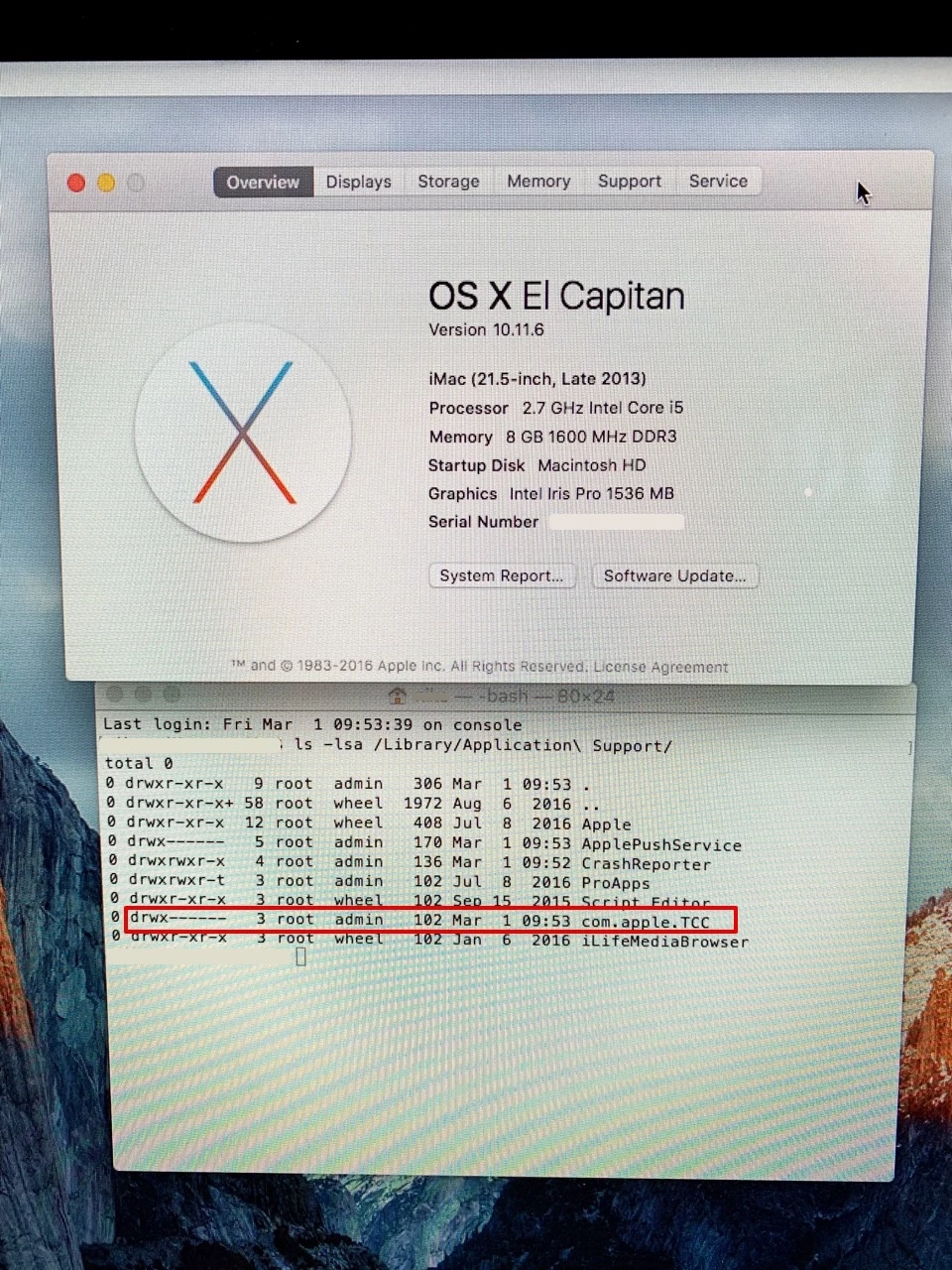

In macOS 11 El Cap, the permissions on this folder are drwx------@ 4 root : admin. The CORRECT permissions that appear in later versions of the OS is drwxr-xr-x@ root : wheel. Unfortunately, these folder permissions are never changed during macOS upgrades from 10.11 to newer operating systems and at some point (10.13?) the folder became SIP protected, making it nearly impossible to change the permissions on the folder manually without jumping through a lot of hoops. Without the ability for a machine to read the .plist in that com.Apple.TCC folder, it's not able to authenticate that the script is whitelisted by the configuration profile and fails over to prompting the end user to manually approve.
