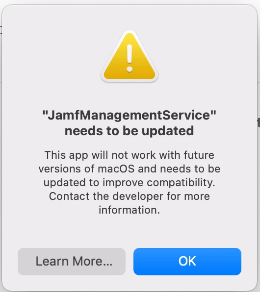

macOS Monterey and JamfManagementService warning in Self Service
  • September 29, 2021
  • 7 replies
  • 66 views
Forum|alt.badge.img+15
I'm starting to test out macOS Monterey, and I just encountered this pop-up warning when running a Self Service policy. I tried clicking the Learn More button, but I was not redirected to a browser to get more info. In the past a similar warning has appeared in preparation for kext and 32-bit deprecation, and it sounds like there's something new on the horizon to be aware of.
Anyone testing Monterey encounter this pop-up?
Best answer by brandonpeek
Likely Python related?
@brandonpeek ahhh... yeah this could be it! The policy is for dockutil to set a user's dock icons and that's using Python.
You can give this a shot.
https://grahamrpugh.com/2021/10/25/monterey-disable-python-2-deprecation-warnings.html
Im trying this on monterey atm,
Otherwise this works for python3
https://github.com/erikng/dockutil/tree/py3
