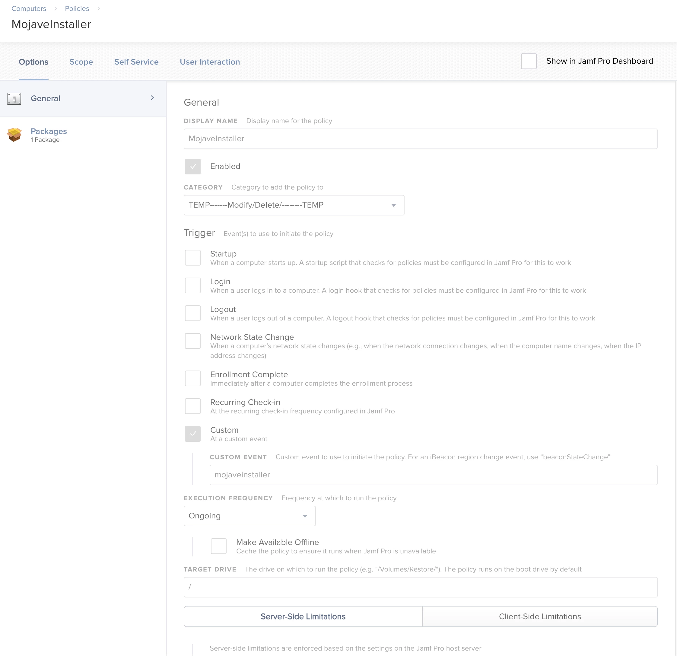

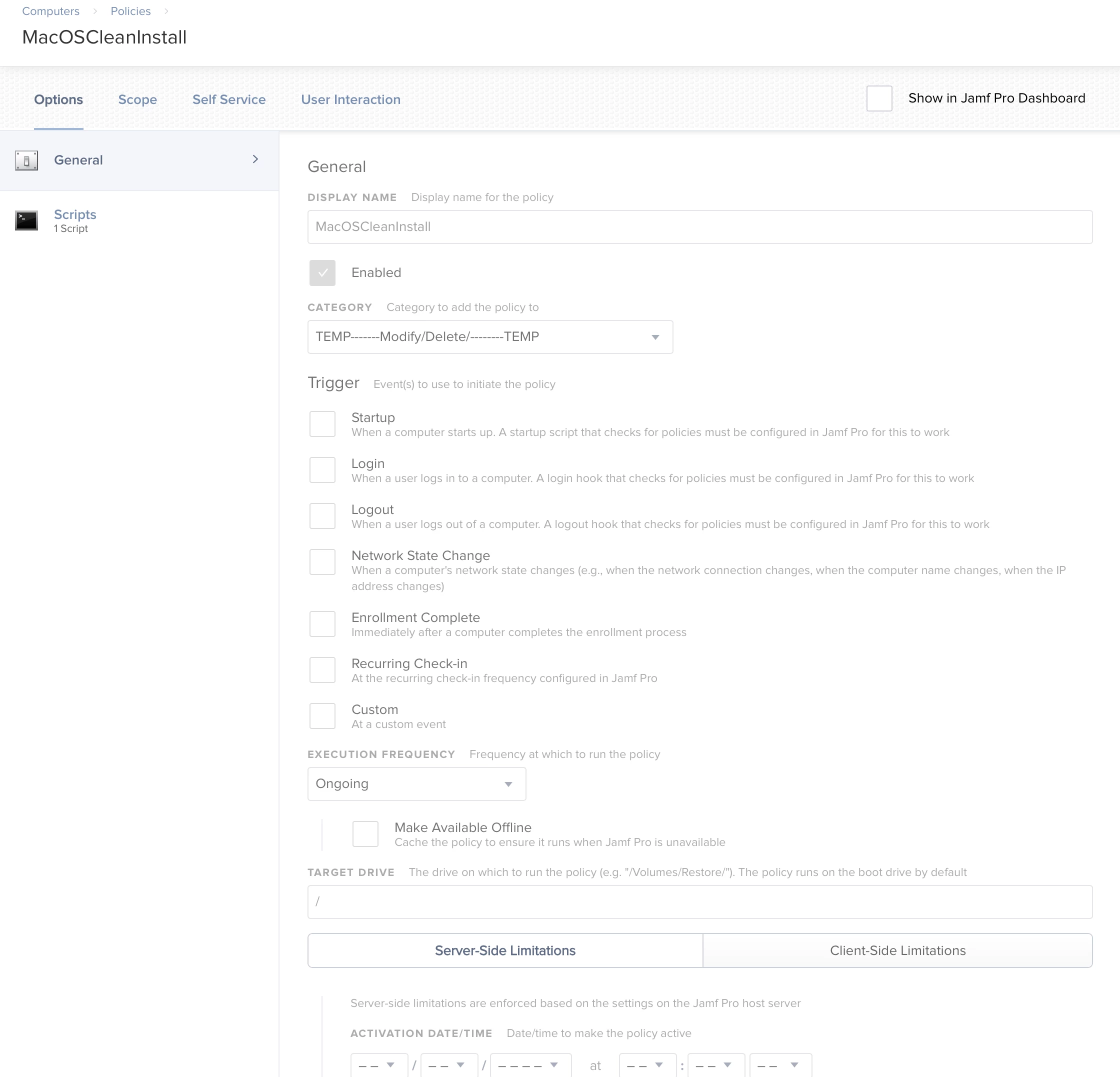

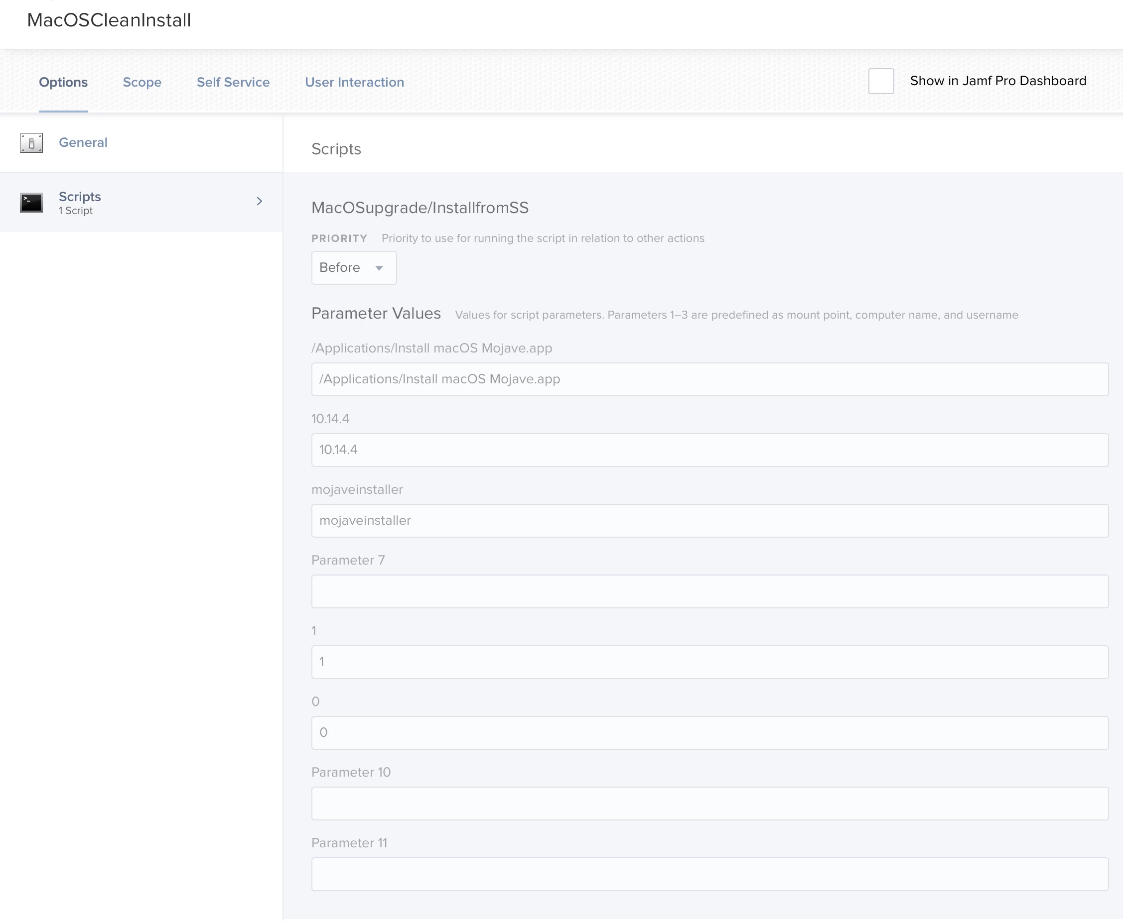

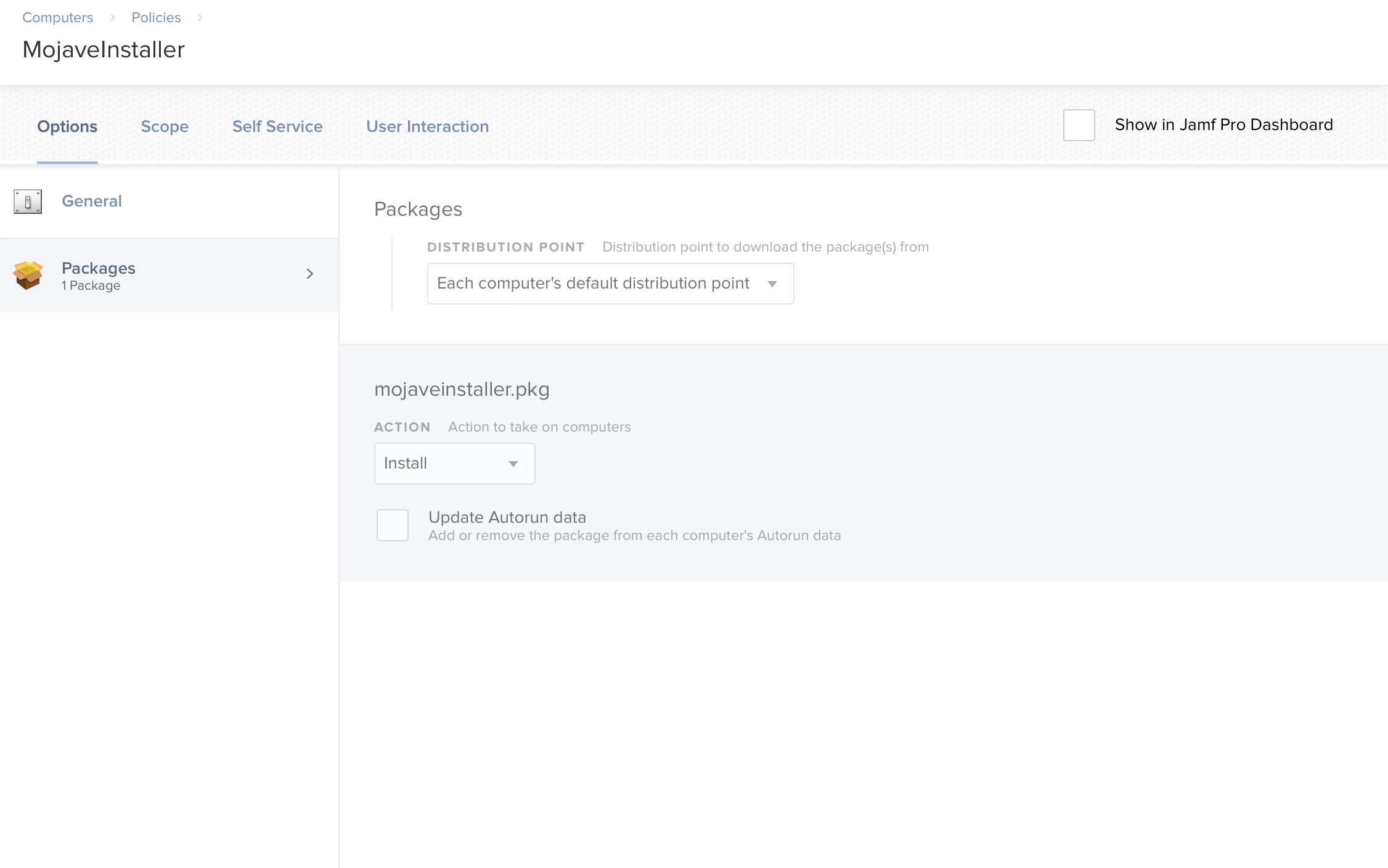

I have attached screenshots for the two policies. Both policies are scoped the same!
mm2270
  • 7886 replies
  • May 10, 2019
Ok, first glance, that all looks to be in order. Is the Install macOS Mojave.app you're using already predownloaded to the machine when you run this, or are you relying on the mojaveinstaller custom triggered policy to download it at run time? If you're doing the latter, I would try pre-downloading it to see if it makes any difference.
Other than that, I'm not sure yet what to tell you. It should be working I think.

@fedagain In your screen shot of MacOSCleanInstall settings there's no trigger specified for the policy. Are you trying to run it from Self Service?
  • 55 replies
  • May 10, 2019
@sdagley
I've run that policy both by CLI (calling it by -id) and SS. The MacOSCleanInstall policy is an SS policy and is set to ongoing, so that should be fine for that part.

Found the issue... the name of my script had a / in the title.... for some reason that broke the whole thing!

@fedagain Thanks for the update, that's a good one to know. Along the same lines I discovered today that you can't use a ! in the password for a distribution point. That problem has become a PI so it'll (hopefully) get fixed at some point in the future. You might share your discovery of the / issue in script names with your technical contact to see if a PI will be created for it.
mm2270
  • 7886 replies
  • May 10, 2019
It makes sense you can’t use a forward slash in a script name. It might apply to other items as well, like packages. It would be seen as a path delimiter (I guess).
The strange thing to me is that Jamf Pro even allows you to name it that way without a warning. If the product isn’t going to support slashes in names, then the least it can do is warn you not to do that.

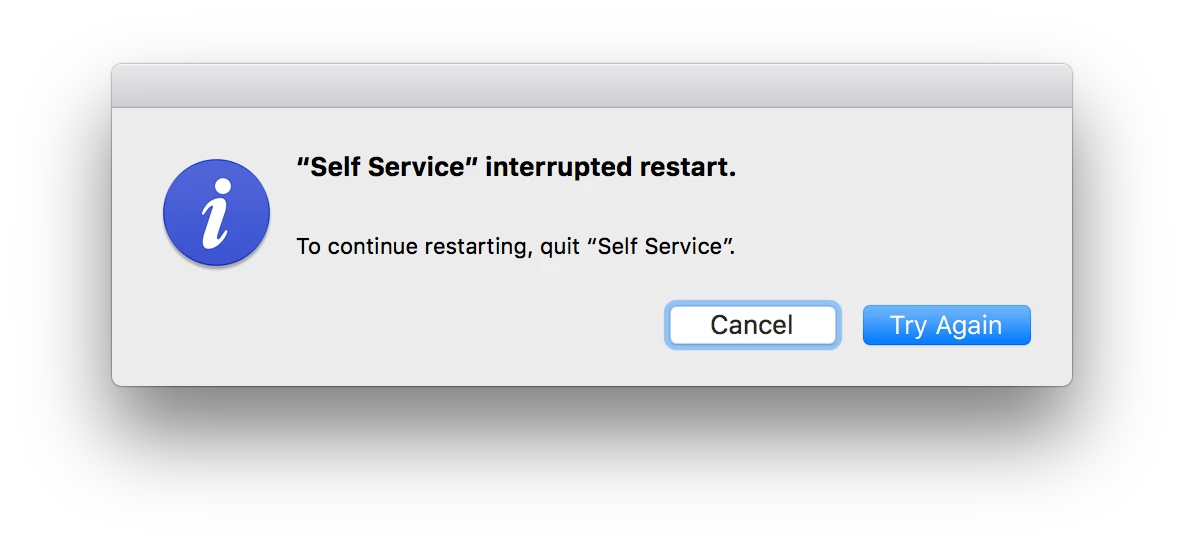

  • 90 replies
  • January 21, 2020
Followed everything to the T with the c9wwh /macOSUpgrade script (Thanks for this!) but one problem. And we've noticed this mostly on the Sierra machines we are trying to upgrade to Mojave. Right when its about to restart to install, we get this:
Anyone else seen this?
AVmcclint
Forum|alt.badge.img+21
  • 1043 replies
  • March 19, 2020
@monaronyc I'm seeing it with Macs being upgraded from Mojave to Catalina. Clicking Try Again 3 times seems to be enough to quit Self Service and begin with the reboot.
jbisgett
  • 107 replies
  • March 19, 2020
@monaronyc this is an open item on the GitHub page for this script, one workaround is to add
killall Self Service
right before
##Load LaunchAgent
on line 491

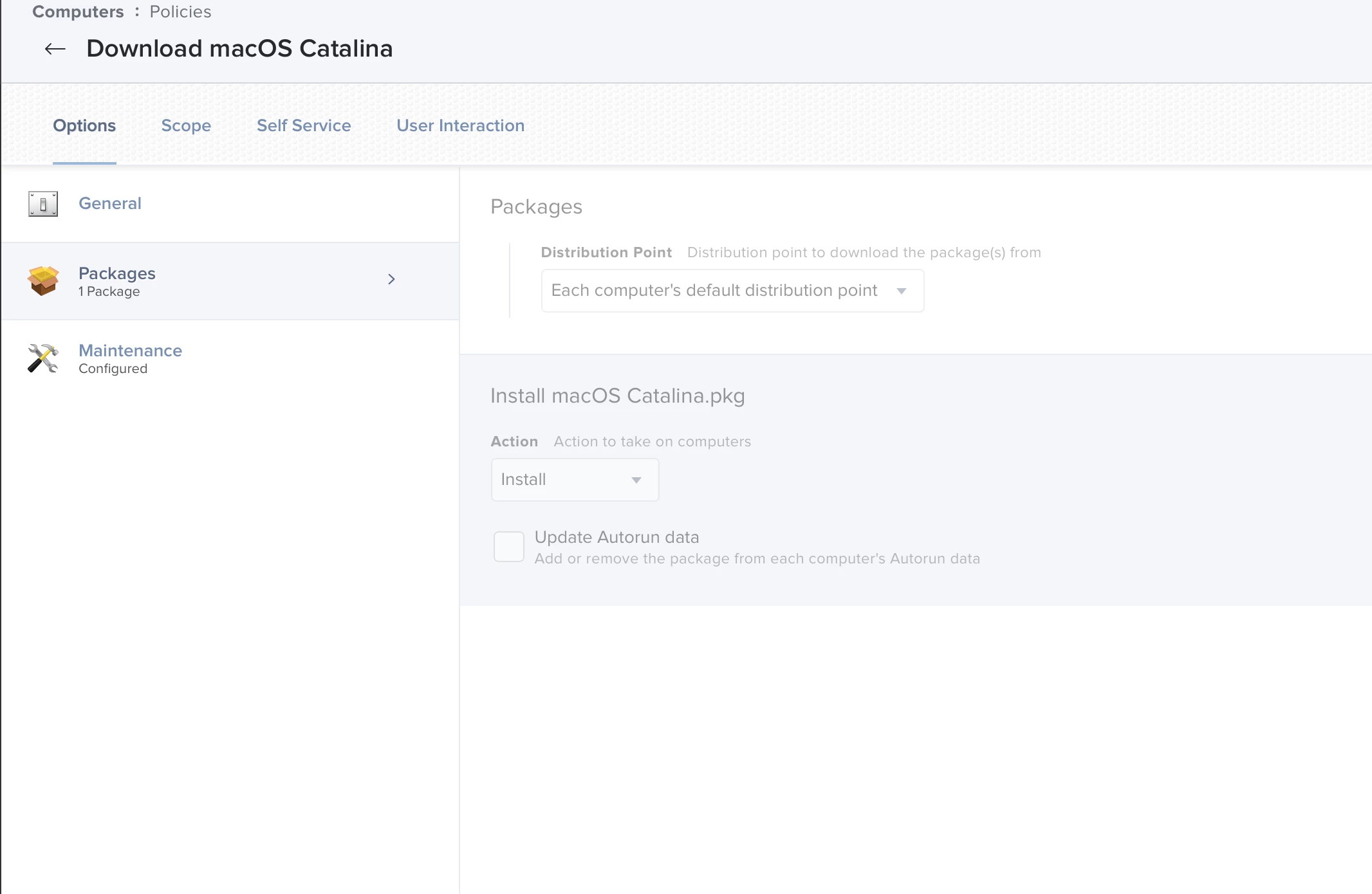

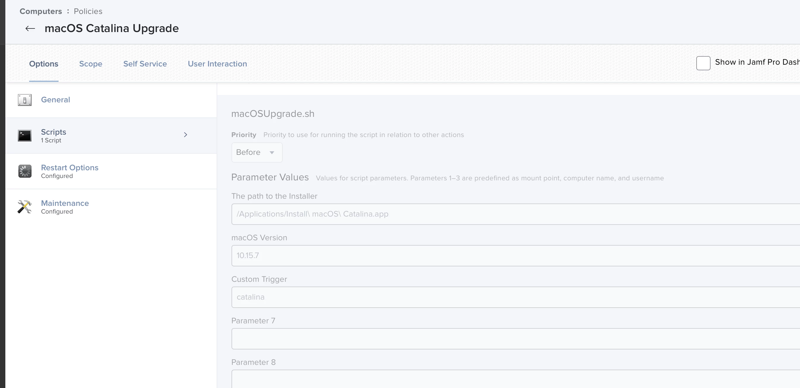

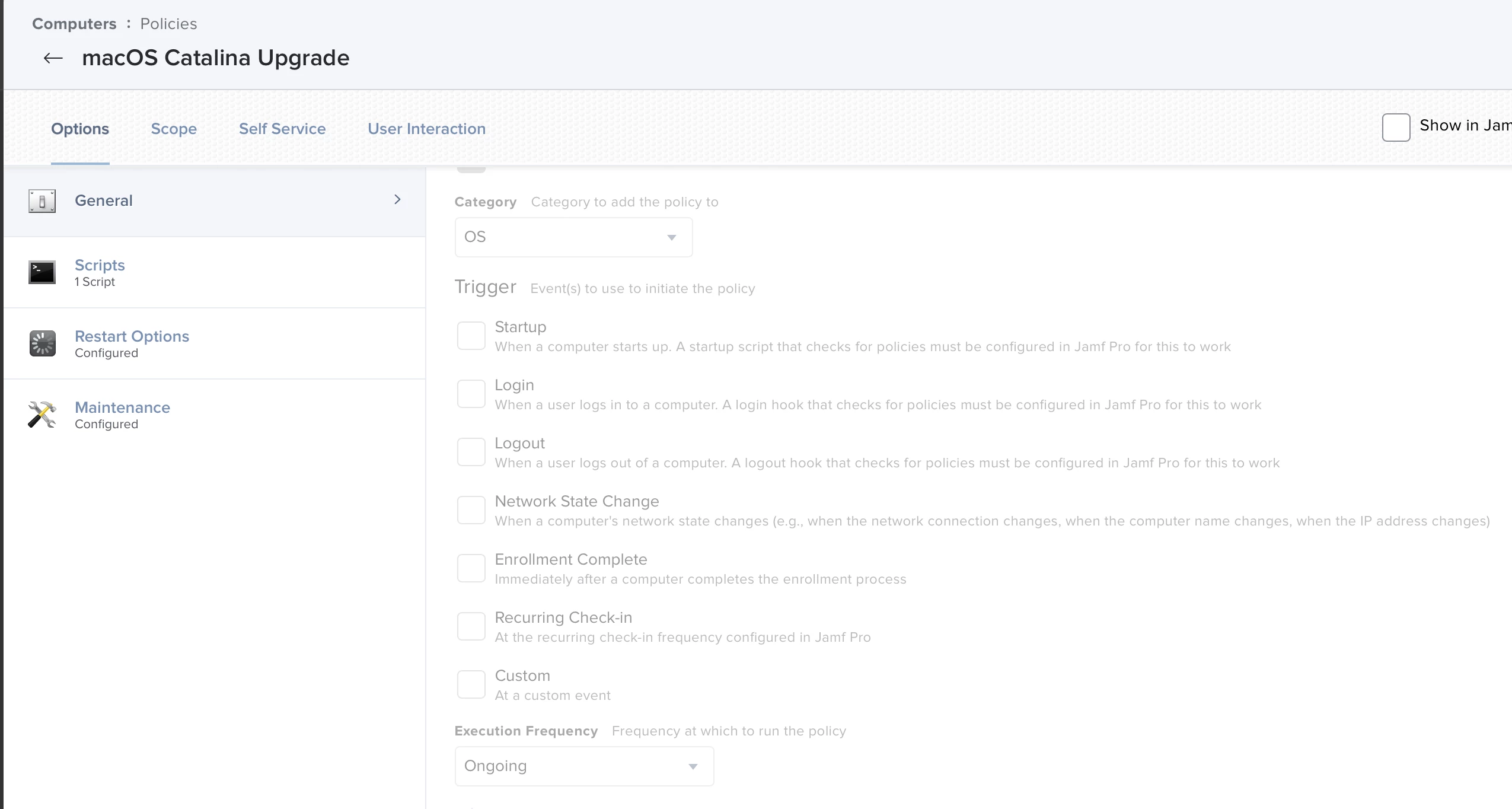

  • 24 replies
  • October 20, 2020

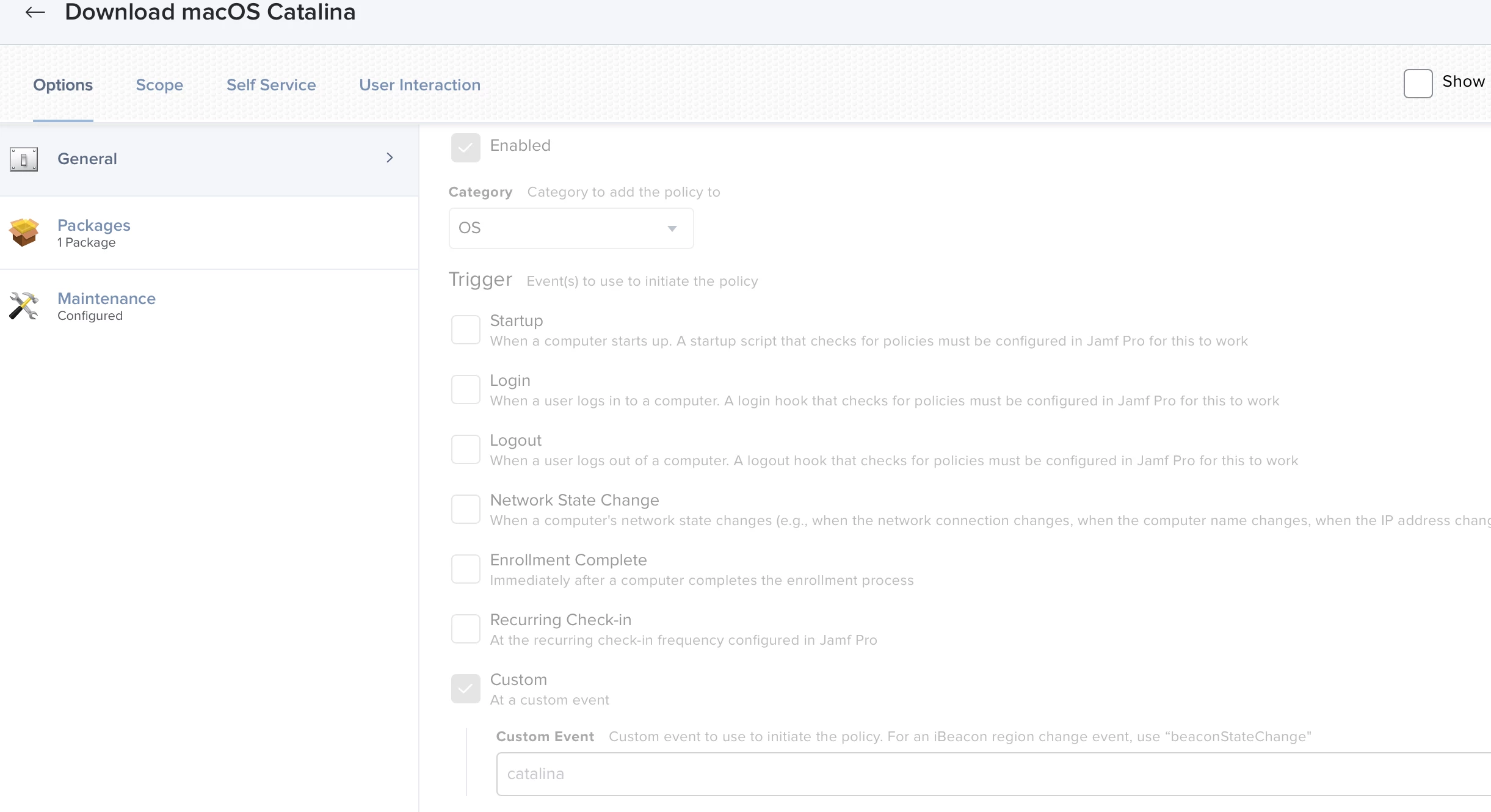

Hi all,
I'm trying to get this working with upgrading to Catalina. On my test machine, it keeps trying to download the installer even though it is already installed in the Applications folder. Any ideas what I'm over looking?
mm2270
  • 7886 replies
  • October 20, 2020
@niacobelli Are you passing the path to the full installer to the script in parameter 4? Or is it hardcoded on the line where OSInstaller is referenced in the script? If you don't have either of those items in place, the script may think it needs to download the full installer instead of looking on disk for it.
  • 24 replies
  • October 21, 2020
@mm2270 I do not have it hardcoded in the script, but it is passed using the variable in the policy. I just copied and pasted the Jamf script from github. I used this last year with a Mojave installer without issue. Just trying to figure out what I'm missing.

mm2270
  • 7886 replies
  • October 21, 2020
Ok, two other possible issues I can think of:
  1. It's possible the version of Install macOS Catalina.app on the machine is not actually 10.15.7. Since you are specifying 10.15.7 in $5, it's going to check to make sure there is a version match, and if not, will try to download the version from your custom trigger policy.
  2. I'm not sure if you need the backslashes in the installer path name in $4. I haven't tested this in a while now, but since this line: OSInstaller="$4" shows $4 is in double quotes, the backslashes escaping the spaces shouldn't be needed, I believe.
Can you check the installer version on the machine and also try without the backslashes and see if either of those help?
