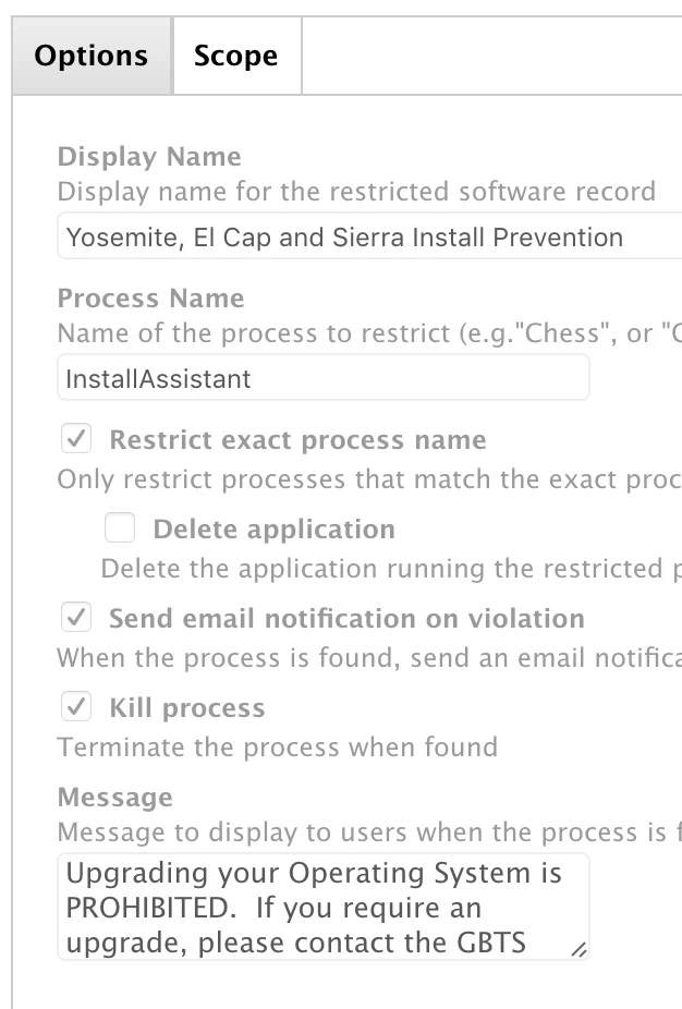

Hi @cghigliotty
These settings are working for us
another discussion over here

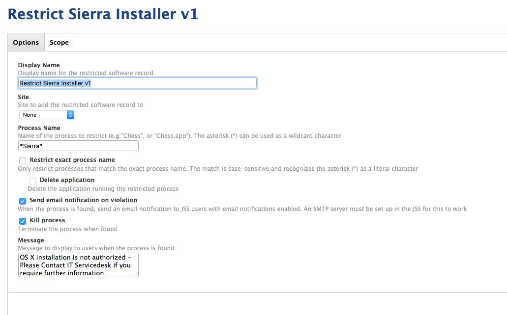

  • Employee
  • September 27, 2016
For those who still run into issues with the "sierra" option, try "macOS Sierra.app" this should block the install with no issue

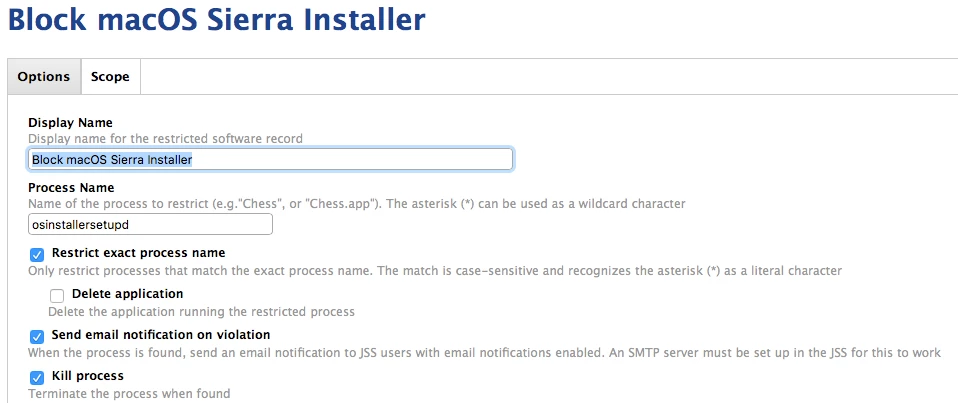

If you want to block Sierra You can block the process. If you only block the .app you can simply rename the file and still launch it. When you start the install it spawns a process named "osinstallersetupd". Screenshot attached with the configs that I used.
  • October 19, 2016
@joshua Many Thanks for this great idea! Works perfectly!
