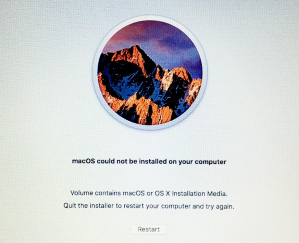

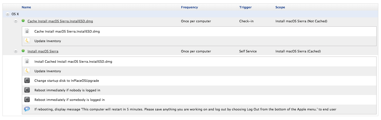

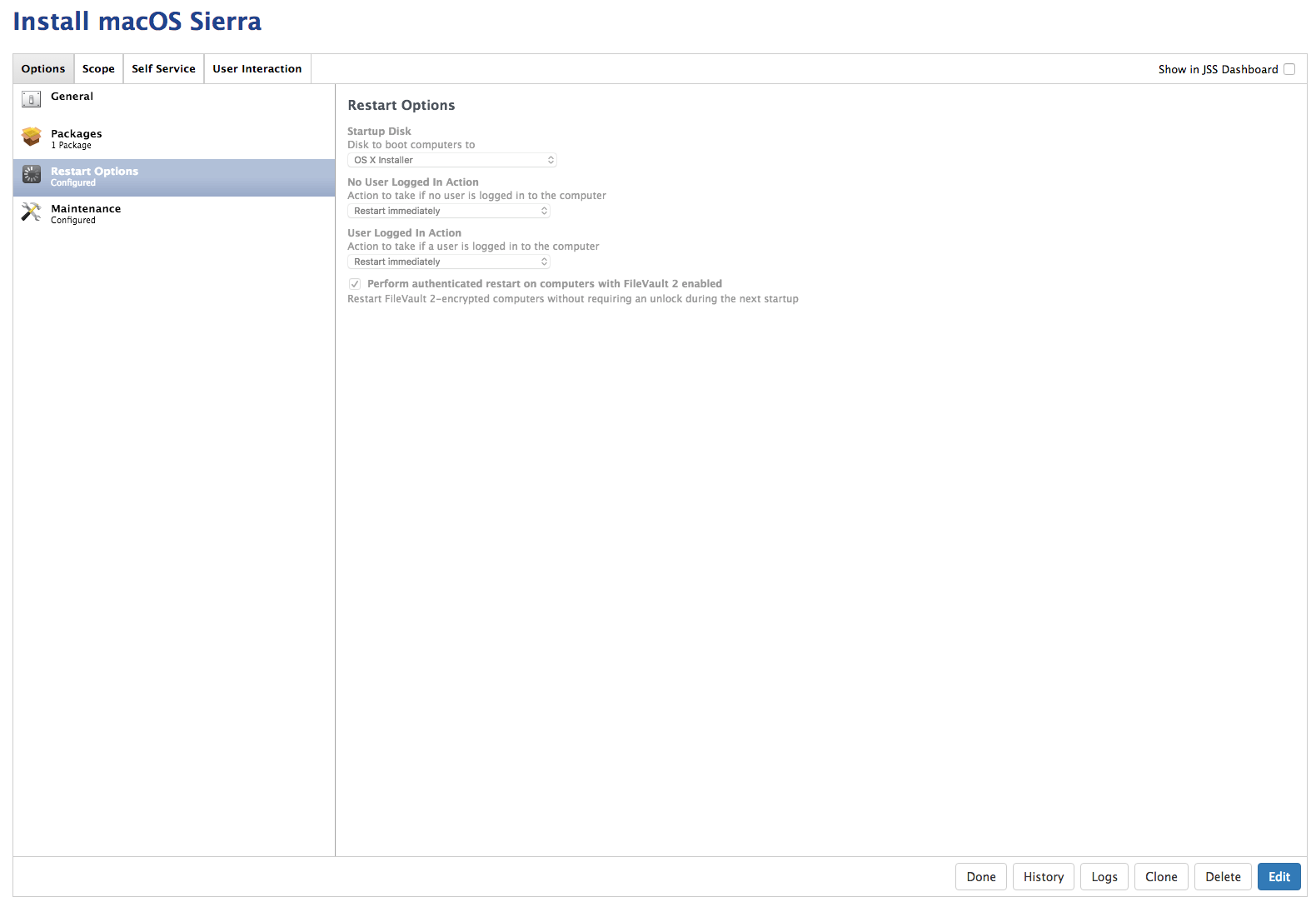

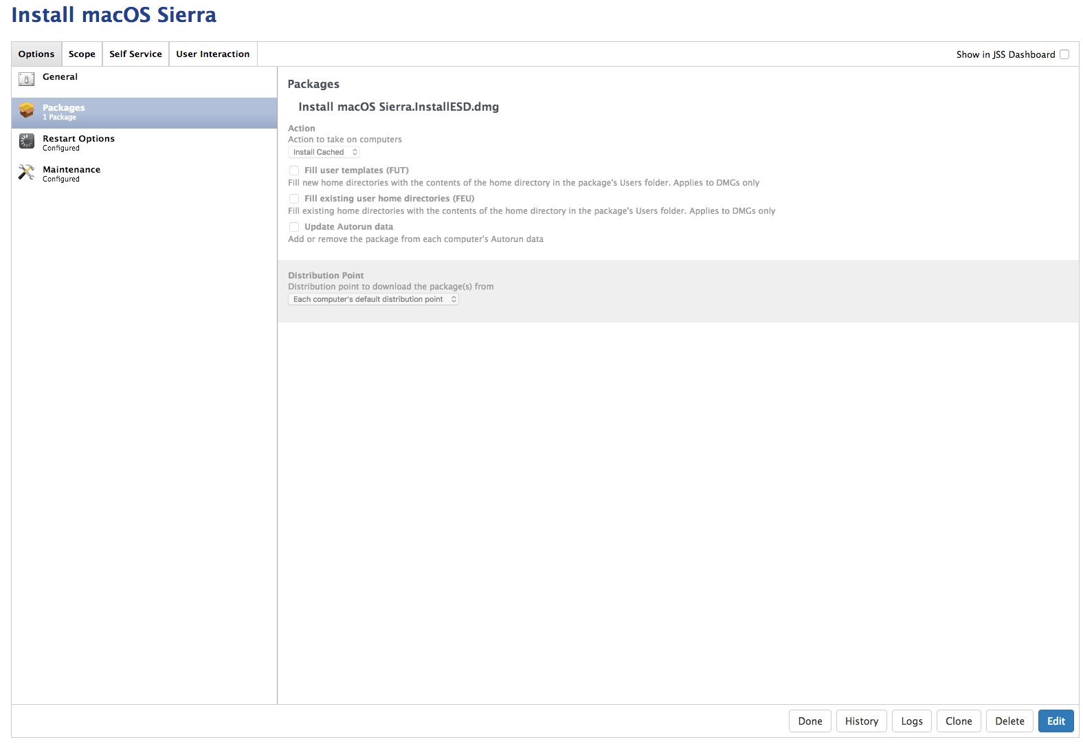

@mark.buffington All set on v9.96 in my Test JSS environment. Please see the error that I am now receiving as well as the two policies in the JSS that are being used. Any thoughts?

@sepiemoini So is the test Mac running 10.12? Or does it have a copy of the install MacOS Sierra.app?
sepiemoini
Forum|alt.badge.img+21
  • Employee
  • September 24, 2016
@bentoms This test Mac is running 10.11.6 with the Install macOS Sierra.InstallESD.dmg cached in the Waiting Room directory. It's enrolled in my Test JSS running v9.96. I packaged the Install macOS Sierra.InstallESD.dmg using Casper Admin v9.96 as well.

  • September 29, 2016
After performing the v9.96 upgrade in my Test JSS, the Install macOS Sierra.InstallESD.dmg was cached in the Waiting Room directory using a JSS policy. I then downloaded and ran the Create Recovery Partition Installer.app. I threw in a Install Mac OS X El Capitan.app (this was the native OS running on the test computer at the time) into the Create Recovery Partition Installer.app and ran the outputted package. After running and installing the newly created 10.11.x Recovery Partition, I ran the install cached portion of the JSS policy without any reported issues and am now happily running 10.12.0 on this test computer.
