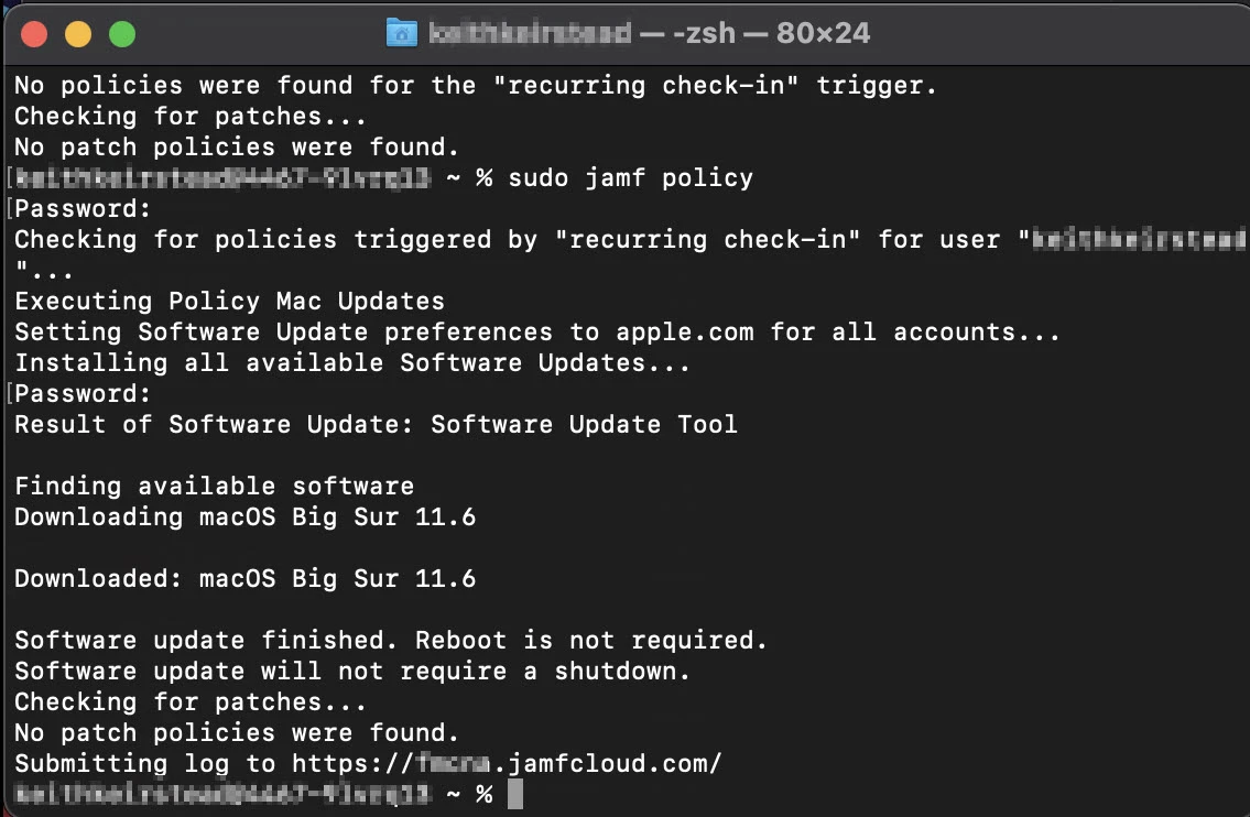

We are trying to set up our Macs with a Software update policy from this link. I've set that up and deployed it to my test machine (M1 Mac running 11.2.1). I ran a 'sudo jamf policy' to kick it off and see what the process would look like. After the initial password to run the sudo command I was prompted again for my password and then it took awhile to I assume download the update (11.6). After downloading in terminal it says the update is complete and that it does not require a restart or a shutdown. However the update never installs, the Mac is still running 11.2.1, I rebooted the machine and it didn't apply any updates. Any thoughts on why its downloading but not installing?

Pretty sure this is due to the M1 Mac. It's not something that works via the command line softwareupdate method unfortunately. Only 2 valid ways to install OS updates on those models now is through the Software Update preference pane GUI or by sending an MDM command to the Mac to install updates. You can thank Apple for that. With each new OS and new Mac models Apple has made it harder and harder at every turn to get machines updated, for reasons that only they seem to know, because it sure doesn't make sense to anyone else.

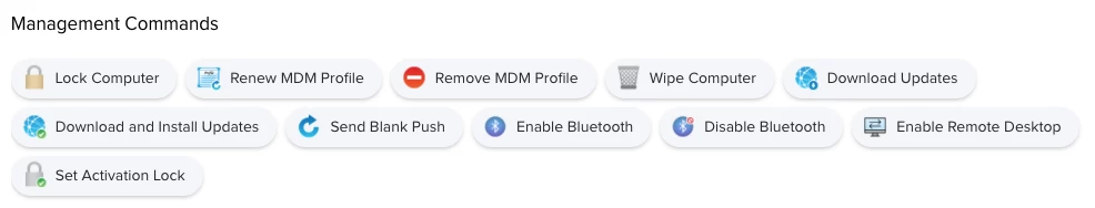

From my testing thus far, unless its a fluke, the MDM command from the GUI's management actions do not reliably work.
However, I have tested with the API and it works as expected, granted, it seems the user has little interaction/notification of the process

This is what has been tested to not really work (at least consistently)
Im running the API call from my machine locally using this as an example and it seems to work effectively, there just isnt a lot or many notifications for the user i run the command at night.
Seems to go from start to finish in about an hour, on average.
https://{{url}}/JSSResource/computercommands/command/ScheduleOSUpdate/action/install/id/136,326,33

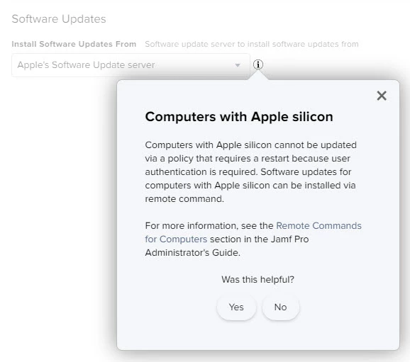

Well if I had just checked the ! next to the update server I would have gotten my answer....
Interesting! What version of Jamf Pro are you on? We're on v10.35 and I don't have a little 'I' icon beside the Software Update drop-down!
