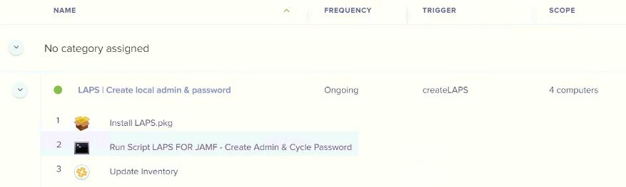

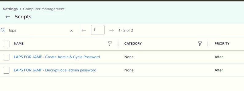

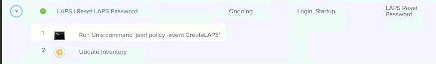

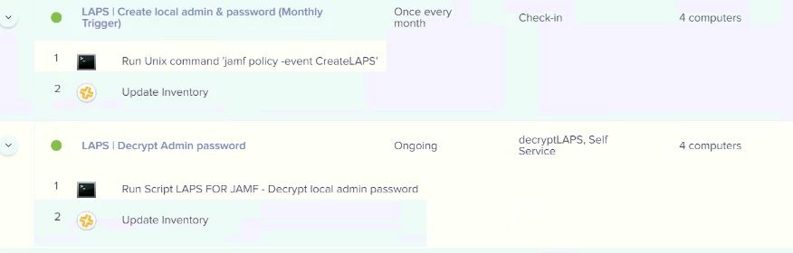

Hi @Stady
What are your current triggers and scope? Can you take a screen shot and share it here or in a message?
  • Apr 26, 2023 1:05 PM UTC
Hi @Stady
Hi @perryd84
Here is the screenshots with scope and triggers, Currently no categories assigned, Do I need to assign the categories to applications or something else, Please let me know or else any other thing?
I added all the scripts and LAPS.pkg from this link
https://github.com/PezzaD84/macOSLAPS
Script also not assigned to any category it is showing None so let me know
perryd84

Hi @Stady
So if you run sudo jamf policy -event createLAPS on one of the 4 scoped devices does it run?
If so then this shows its working but the monthly trigger hasn't kicked off for some reason.
Usually I would have the custom trigger added to a build script running swiftDialog or DEPNotify which would run the initial LAPS setup when a device is first provisioned. If you don't use something like this then you can launch the policy by creating another policy which runs the custom trigger or run it manually from terminal with the command above.
  • Apr 26, 2023 1:34 PM UTC
Hi @Stady
Hi @perryd84
I need to check that on one of the machine by running this command sudo jamf policy -event createLAPS
Currently no categories assigned, hope thats fine?
I have 4 machines under scope but all of them shows pending status.
How can I achieve this below? can you provide step by step instructions for the below?
perryd84
  • Apr 26, 2023 1:45 PM UTC
Hi @perryd84
You could also add the enrollment trigger so that it runs at enrollment which is another way of achieving the same method of using a build script if you don't have one.
  • Apr 26, 2023 2:33 PM UTC
Hi @perryd84
How do I add the enrollment trigger so that it runs at enrollment?
