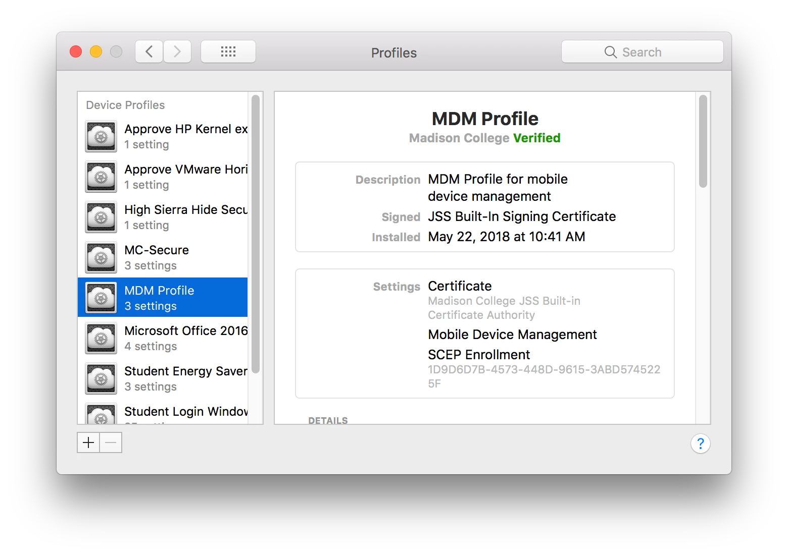

However, the MDM profile is set to verified so it appears valid.

To have full MDM Management functionality, the MDM Profile must be manually approved in System Preferences > Profiles.
Error installing the computer level mdm profile: profiles install for file:'/Library/Application Support/JAMF/tmp/mdm.mobileconfig' and user:'root' returned 102 (New profile does not meet criteria to replace existing profile.)

Hello @igdjamen part of this whole crazy thing is, without MDM being ON or capable, there are no management commands listed under the management tab. This was the first clue to me something was amiss. So we are stuck there.
Because the MDM profile is listed as mandatory and we are unable to remove it, we are sunk there too.
When I log in with the local admin account, the MDM profile is already listed as verified and there is nothing to approve.
