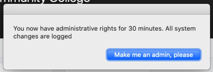

I've tested this out a few times now and the script seems to work through the Self Service and we get the message "You now have administrative rights for 30 minutes....." but the user is still a standard user.
Is the "MakeMeAdmin" script still working for macOS Catalina?

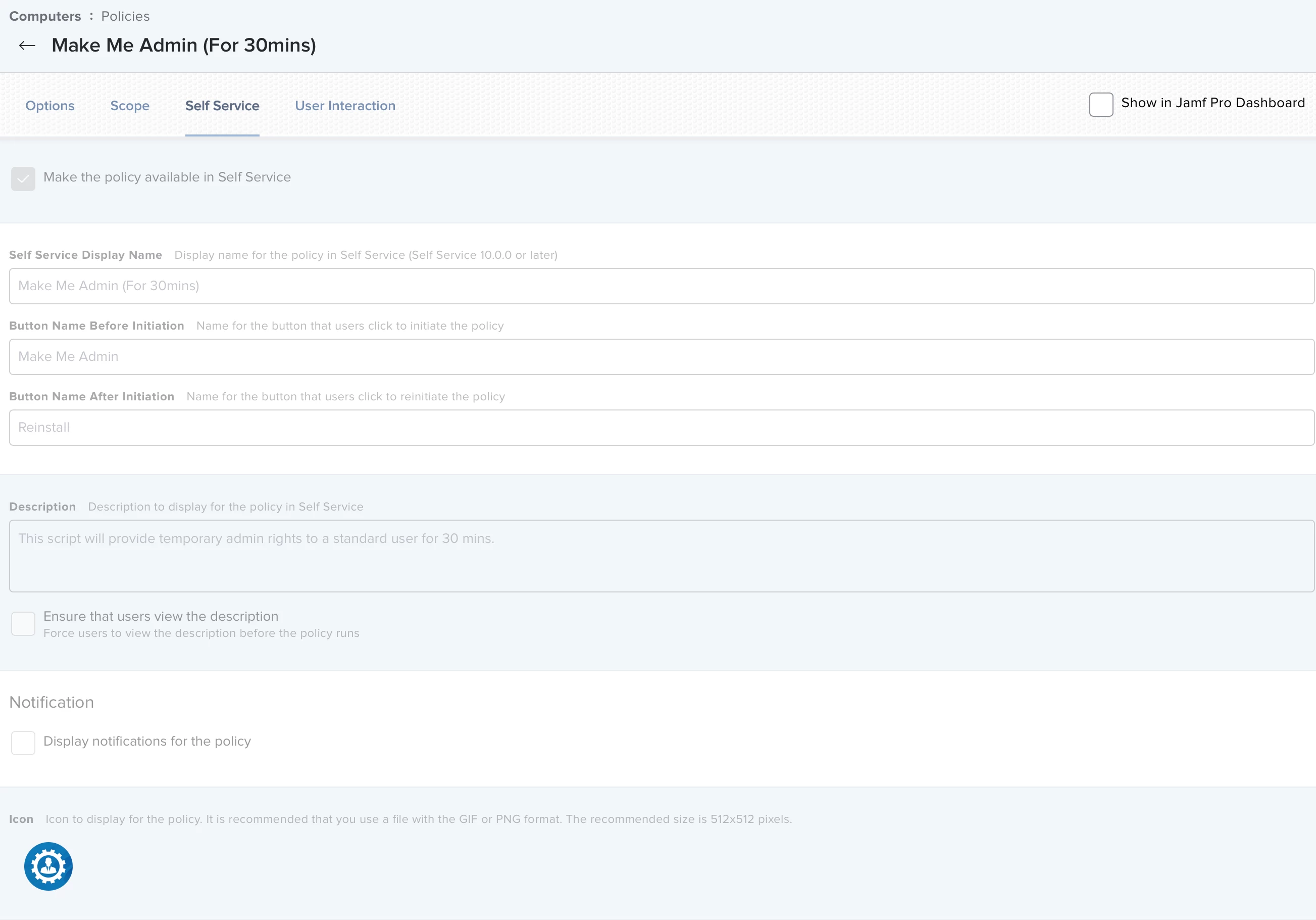

@ronhunter212 I think I'm missing something here. My understanding of MMA is to have it setup as a "Self Service" option which I have done and when the user needs admin they would go to Self Serve and "Install" MMA.
What is the purpose of setting it as an enrolment? Is it install the script/MMA else where for the user to select?
Do they not go to Self Service each time they need admin?

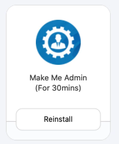

Thanks @techjason That's the script I'm using but it's not making any changes. I have it setup as ongoing and it installs through self serve. I'm using tge default script set to 30mins and it's still in "Self Serve" as "Reinstall".

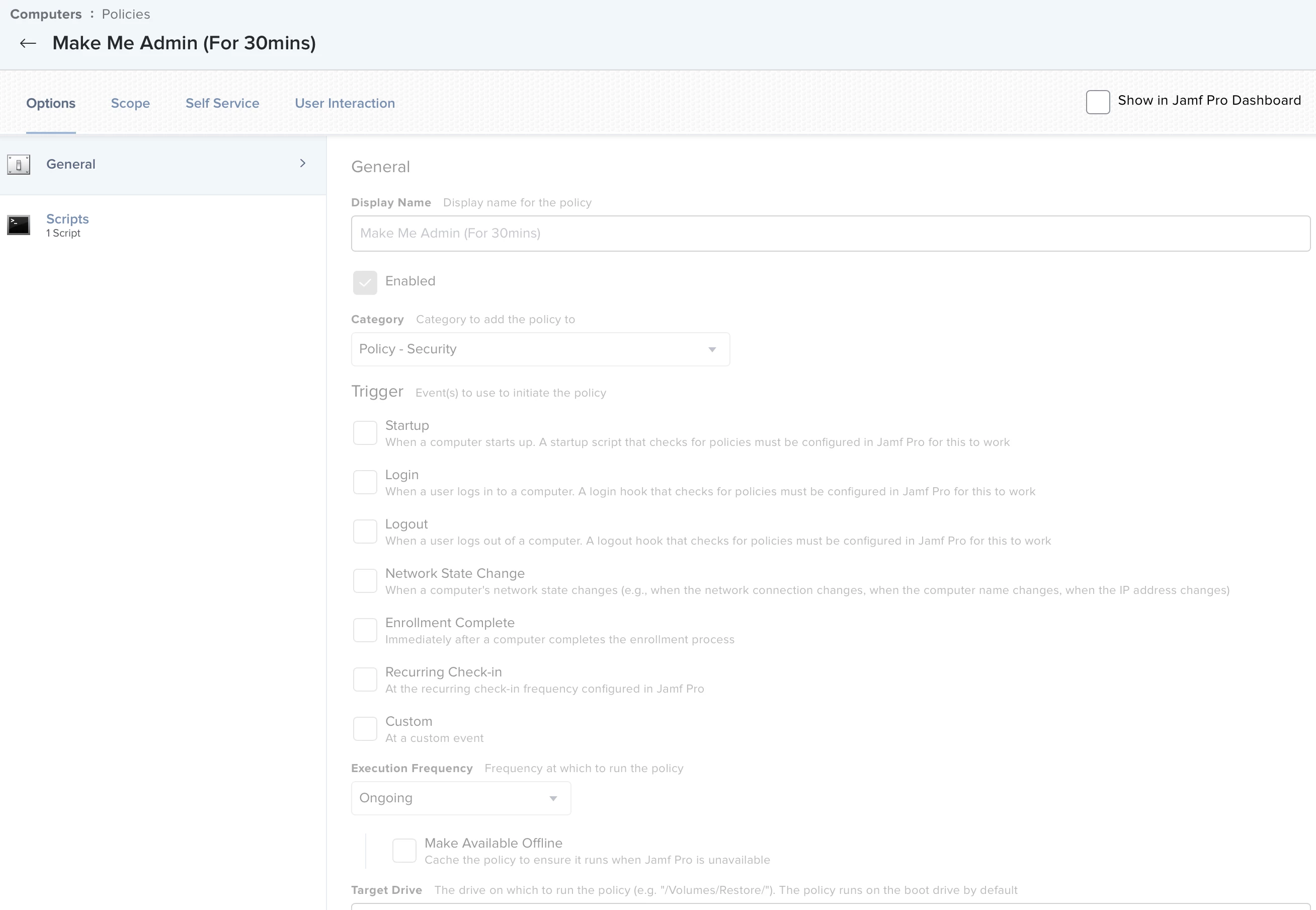

@walt I've tested with System Preferences closed and multiple test computers. I have a feeling I'm missing something in the script that I need to add/adjust.
For testing I haven't changed anything short of the message.
