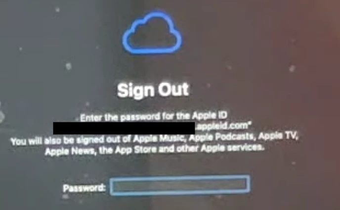

Here is an example of a scenario where a user signed out of their Managed Apple ID prior to formatting and yet it triggered activation lock. Keeping in mind that Managed Apple IDs dont have Find My yet somehow causes activation lock but you are not able to successfully authentication to pass this point even with the correct credentials.
